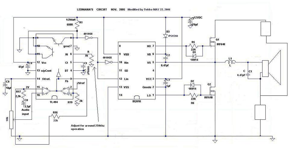

Herers a schem of the amp in current state.

Tekko, your latest scheme version is much simpler... to understand.. 🙂
FB within the TL494 circuitry... nice one..
Ledmania, thanks for the original idea... mabuhay ang pinoy !! 🙂
ill have to think of ways/design a "discrete" way of switching the mosfets w/o using IR2010....
ill probably breadboard the TL494 tommorow...
hopefully, this would be my 1st ever D-amp .. heheheh
If, i succed in making a descrete mosfet driver in lieu of IR2010...
need more info still....
reading more.:angel:
a quick question:::
tekko, regarding on your latest scheme attachement, am I looking at this right?? pin#2(2V Vref) of TL494 left unconnected???
:xeye:
Tekko:
It is not, it just looks that way. The "2Vref" label means its connetced to pin 16.
>> ok 😀 I thought it outputs a 2V reference voltage from there (pin#2).. hehe

why not use 5 pcs of .6V drop diodes(1N914,1N4148) connected in series... voltage drop of 3V from the TL494 pin#14 5V reference that sure is a nice source of 2V 😉

Another Question ::: whoever wants to answer, feel free..
#1 : HOw much GATE Voltage "turn-ON" Q1?? in reference to 'Q1 Source'?? positive or negative?
#2: HOw much GATE Voltage "turn-ON" Q2?? in reference to 'Q2 Source'?? positive or negative?
i dunno if it could be done with using discrete level shifters... I was thinking of an CMOS HV circuit(generating +45VDC@3mA?, diode capacitor voltage multiplier) and using fast switching transistors to "switch" the HV to the GAte of the MOSfets...???? comments pls...
I really want it to be discrete as possible... just a --poor guy-- here trying to come up with basic parts... :cannotbe: :dodgy:

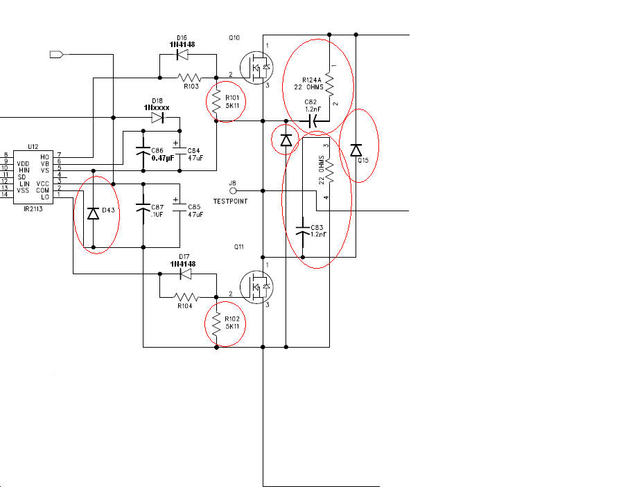

Would any of these components in the red rings help any with the ringing ? Apart from the components in the red rings, thats the output stage of my amp.
The gate resistors are 22ohm, i just forgot to set out the values.

This time it was due to shorting something out with a screwdriver, it killed atleast the fets so i replaced them with IRFP250N, they got hot instantly, even the cables between trafo and rect melted.
But this have costed alot of money this far, and theres just no point continuing.
