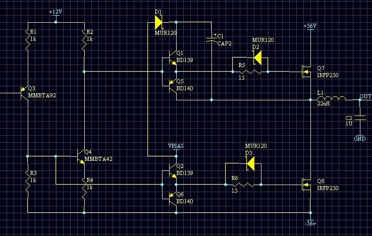

snip Tekko;
"Try this:"
Sorry Tekko,
Why better not?!
Please simulate this circuit!😉
Regards
Heinz
"Try this:"
Sorry Tekko,
Why better not?!
Regards
Heinz
The circuit in message 191 won't work. The concept is ok, but the implementation falls far short.
sawreyrw: The circuit in message 191 won't work. The concept is ok, but the implementation falls far short.
thanks for the info....
tekko, I was wondering WHAT the Vbias voltage WAs? i mean how many volts...
anymore ideas? pls...

Hi sawreyrw,
You're right. Simulate it. Even it works but not fast enough. I see the fastest discrete driver is only the UcD's on earth.

Usage of N-CH MOSfet
hello all,
MODE #1 :
shown bellow, using the N-CH mosfet.. in the 1st picture, when LOAD is in DRAIN of mosfet, triggering it to full conduction is easy... apply +12V
MODE #2:
however , if putting the load in the SOURCE of mosfet, higher voltage is needed to trigger the mosfet to ON state... inputing +12V only will result in an "output" of half (+6V) the supply voltage (w/c is +12V)....so to trigger it to full conduction requires higher input voltage to GATE.. higher than supply voltage (12V).....
guys, correct me if im wrong... hence , the lever shifter chips (IRxxxx)....
this is based on my experience using N-ch mosfet H-bridge for my robotics projects.... N-CH mosfets are MUCH cheaper than P-ch... 🙂
i was thinking, of making a HVDC (+45VDC) and use high speed transistors to "switch" it to the HIGH side N-ch fets... (mode #2 of picture)
comments pls....
