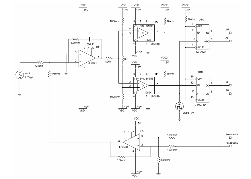

Anyone seen this kind of modulation before ?

So you've read this then http://ece.wpi.edu/analog/mqps/ClassD_MQP_Final.pdf
and chose to ask if we've seen "this type of modulation"? Did you read it? There's nearly 200 pages of information for you there... what is the type of modulation?
This is what I'm saying when I said if you research you should at least get to an informed question.
Danko, gold star for you then. Can you imagine why everyone else suggested it be simulated though. You should too, because it's still not going to work.
I spent hours reading the 100 pages worth of info there, finished sometime after midnight.
3-level Sigma Delta modulation, supposed to run cleaner and sound better.

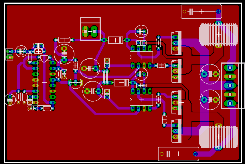

It seems very simple in schematic level but its not, it is very hard and i mean hard to make a board for this. It is impossible not having signals cross each other, which would ruin the amps performance as it is operating @ 2MHz.
I emailed a professof on the website asking if they had any board layouts left but they dident, tho they said that i might had wanned to improve grounding if they would have had layouts still,
so i´m left out by myself.
I would want to make one, but my eagle skills doesent allow me.

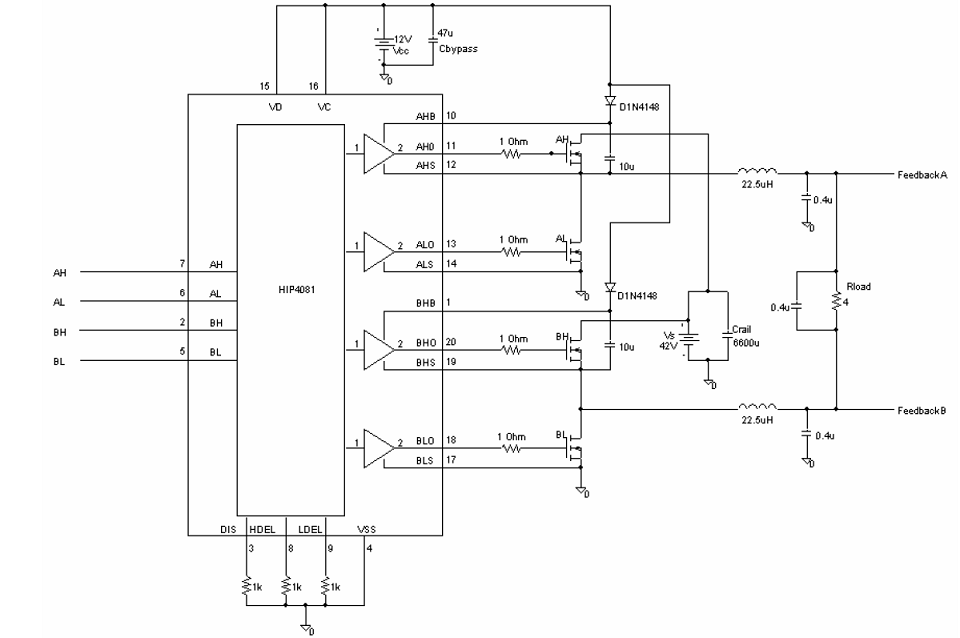

I can get all parts, the most expensive one would be the HIP4081, it costs around €3 which isent mutch, the other components are just cheap everyday food.
If you read the pdf, you see that this circuit is tested and all component values are calculated for optimum performance so even a n00b should be able to put one together with having a readymade pcb made from the schematic, with addition to some 0.1µF bypass caps between the ic Vcc and gnd legs.
The only thing i cannot get is the chosen fets, but IRFZ44 seem to be good enuf.

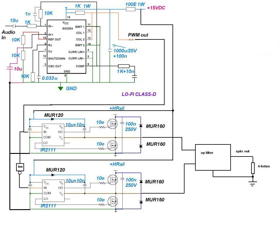

But this till be a later project when i have learned to use eagle more efficiently. For now i´ll protoboard Worhorse´s schematic with SG2524 and IR2111, he have approved the schemo i wipped together based on his schemo and given me the the goahead to move on to prototyping stage.

-Just out of curiosity, how do you intend on prototyping this as the "next stage"?
-What's your budget for this project?
-What's your end goal? Do you expect this design will achieve it.
-At what point will you give up on it (cost overrun, boredom.. ??)
Don't set yourself up to fail.
Oh, and post #213.....
Do you seriously expect that a "fully optimized and tested" with a "should be good enough" pair of mosfets will work swimmingly .. for a "noob"?
What happened to your last circuit again when you tried a "should be good enough pair of mosfets"? It got expensive suddenly.... didn't it. Conclusions?
Look back to the start of this thread and see how many times you were tipped off to read data sheets. Find the app notes you need to find so that you may understand what they mean and what to look for on them..
That's research, not finding another PCB to download.
This time im convinced that it´ll work without a hitch, IR2111 have more deadtime allowing the fets to never cross conduct, actually too mutch deadtime but as it will be a subwoofer amp only, that wont really matter.
