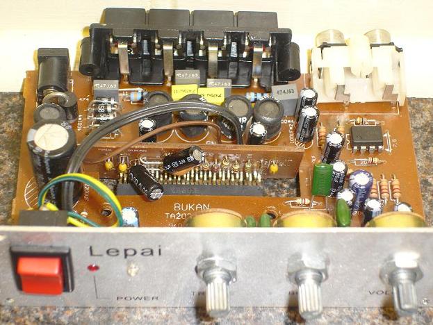

As you know Michael, I'm not educated in electrical engineering but I only tend to use 'earth' as safety earth, i.e. connected directly to a water pipe or the UK's 'third' pin.
So your amps have the copper grounded to the case? I always thought that was a no-no?
Not sure why it faulted but I'm also wondering if that PCB is touching the casing where it slots/slides in.......
Zbuff, yes I had noticed that MM's has a wire from the treble pot to ground and that the output caps are orientated a different way... Wonder what else was changed?

The PCB is what is known in the industry as a single sided "unsupported" hole board, this is typically what you will find in alot of DVD player and VCR machines these days. With an unsupported hole board you have to be careful on how through hole components are installed, in the case with Lepai, the traces are on the bottom side which has the danger of delaminating the traces if you put any pressure on the components, the idea method for these boards would have been to install the componets on the trace side, but using a conventional wave to solder the parts, they have to do it this way with the trace on the bottom.
After the holiday period, I've had a little time to have a look a bit closer at the amp and do some listening comparisions to my Sonic Impact. Aside from the bass I like the sound of the SI better, it has a more spatial air sound with better seperation. I'm putting it all down to the complex input section in the Lepai though, it takes up near HALF the board. I thought the Lepai sounded alot less dynamic and duller than the SI at the start, I had both my treble and boss controls set at 12 o'clock then I realised that to make the levels of SI I had to put the treble at 2 o'clock and the bass at 1 o'clock on my amp, quickly confirmed by putting my DMM on the speaker outputs and playing some test tones.
It seems a pretty simple matter to just bypass the whole lot by connecting from the back of the 10uf input caps to the channel inputs onto the PCB where it joins to the standup, the required resistors seem to be on the standup. Haven't done as of yet, it would be nice to retain the BOSS control as suggest by the rest of you but I would imagine the improvement would be quite large from bypassing it all, and would resolve all the deficiencies compared to my SI.
I've been looking at the datashet for th TA2020 and noticed that the Lepai seems to missing the Differential Output Capacitors, are these needed? Might these fix my slight hiss?
I replaced Csw the 100uf caps with some 1000uf caps the same as you did Lee but as of yet haven't put in any .1uf decoupling caps, are MKTs or ceramics better for this usage? It added alot more slam and control in the bass department, I think without the decoupling cap it might have killed my dynamics a little going up to much larger cap size. It also removed all the hum and some of the hiss on the speaker, pretty much removed the DC offset I had on one channel, but unfortunately on the other that I had a problem with before(measures ~150mv) didn't effect it at all. So I'm starting to wonder if my problem resides in the audio input or the speaker output sections now, has anyone got any ideas?
I've had mine go into protection mode too from putting it ontop of ground metal case too just like Lee 😀 Those big booms can't be a good thing for speakers. I've gone and put some stick on feet on the base now.
Other differences between your board and Panomaniac's one, a couple of extra resistors on bottom in the powersupply section, an extra bypass ceramic cap where the tank capacitor sits on our boards. Oh how do I go about drill new through holes for that tank capacitor so I can reposition it, how do I make new solderpads for the leads, do I just remove the varnish off the traces?

I found that the PCB connected with the case where it slides in! Wrapped some insulation tape around the edges and the problem has gone away.
Not that I care that much, as you say, the Lepai is too busy on the input with way too much buffering and filtering…I agree...bypass the lot…even the Boss!
Oh and Yes, just gently scrape the varnish off and put a little flux on the trace. Then give it a little solder to tin it before you solder the wires on.

I'm going to bypass all the tone controls tonight actually, so I'll report back later to let you know how it goes.

Wow what a difference that made, just finished bypassing all the tone controls. I've currently just got it implemented somewhat makeshiftly, I removed the 3.3uf electrolytics caps behind the overload LED(this marks the end of the tone controls) and unsoldered the inputs caps(I have them replaced with polyester film 2.2uf caps when I first got the amp), then flipped them over to the bottom of the board hooked one leg on the trace from the volume pot then soldered a wire from the other leg to the input solder pads at the base of the upstand(if you're looking at the bottom of the board with the front facing towards you it will the the 2 left most pads). I've done it this way just to test before I go chopping any traces.
Turn on the power, first thing I noticed was hardly any turn on thump compared to before, next the music......
Everything I liked about the SI over the Lepai in my previously listenings was now on the Lepai, plus all the benefits that the Lepai had over the SI. Awesome. Back to some more listening now.

The signal comes in, goes thru the pot, then the little dual opamp, then over to the tone controls and on to the chip. I guess the opamp is there to make up for the gain loss in the tone controls.
There are several nasty electrolytics in the path along the way, as well as the tone controls and the generic opamp.
Couldn't hurt to clean all that up. 🙂 Seems like zBuff did and reaped the benefits.

I think I've finally found the cause of my DC offset, one of the .1uf decoupling caps on the standup board that supplies the main powerlines seems to be melted. Can somebody tell me what type of capacitor it is? it's the same as the 2 104 on either side of the speaker output capacitors. Little orange tubular things, around the size of a metallic resistor but fatter and in an axial leg arrangement.
Seems it might be a good idea to take them out anyway and put them closer to the chip pins as Lee did.
Edit : nope removing that cap didn't fix my problem 🙁

I was wrong about removing the 0.1uf caps off the standup, they are decoupling caps for some other powerlines, so leave them in place.
The standup board makes it a bit hard to follow which pins traces connect to.
Who needs to do mazes to stimulate the mind, just try to map out a circuit board 😀
Other improvements I can forsee at the moment? removing the LEDs.
Taking out the inductor on the main power line in if you're using a linear powersupply or a battery perhaps.

OK I've finished mapping out the preamp/tone control section, I'll turn it into something I can upload at some stage, only used old fashioned pen and paper at the moment 😀
I can't make out that much about it at the moment well at least not the tone controls section but sure looks like we'll be able to just bypass the tone controls and retain the advantages of having a preamp

Could someone else test their Lepai and tell me if they're getting any DC offset as well? I've been trying to get rid of it recently I noticed that the Blue LED is fed off the speaker outputs of the left channel, I thought THAT's it, removed the LED and my DC offset actually increased from 150mv to 170mv
Aside from that the Lepai sounds very good with the preamp section bypassed, I'm hearing more midrange and lower bass detail than the stock SI too. And this is me using bookshelfs, the difference would be even more pronounced with speakers capable of a more fullrange reproduction.
