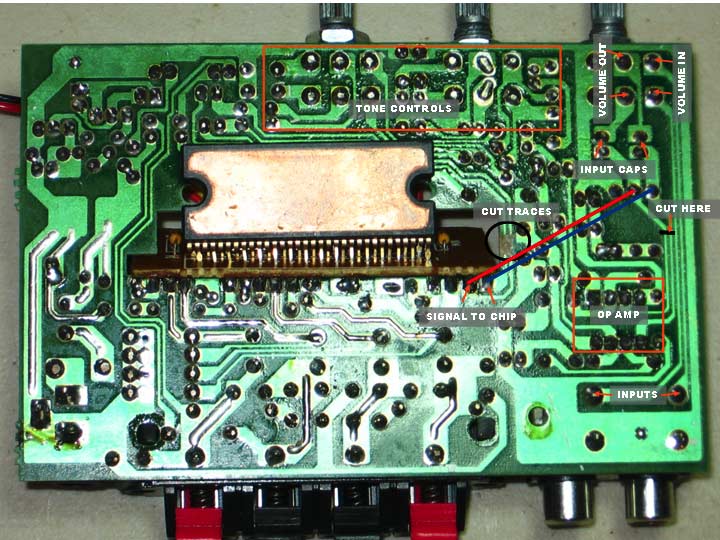

I'm trying to post a photo of the signal routing, but it won't go. The image is 89K, but the board tells me it's too big - over 1meg. Hmmm....
Nice work Michael.
It looks like a lot of the main board could be eliminated if one were to use an off-board volume pot and off-board input caps.
Or - if bi-amping - the opamp etc. could be used on one amp as a low pass filter and on the other amp as a high pass filter.
