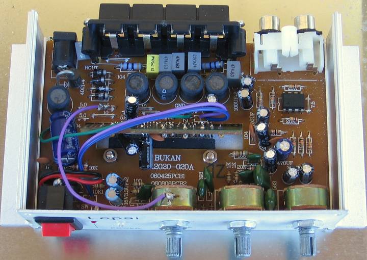

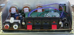

I took these photos last week and forgot to post them!
Here is a top view of the amp where you can see the TA2020 chip under the main board. This amps seems to use the same output inductors as the Sonic Impact. It also uses one on the input as a power filter. Diodes are thru hole as is everything.
Pretty bad build quality - loooks like so much of the junk stuff from the 1970s. But it actually works well - credit to the TA2020 chip!
I don't know what the 8 pin DIP IC does. Haven't looked into it yet. Anyone know?
