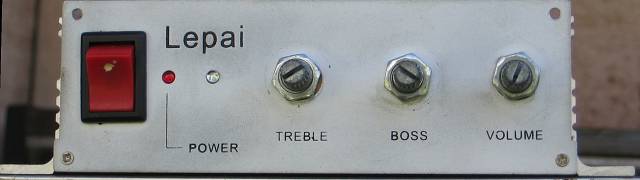

Front panel.
Yes, it came that dirty and scuffed up. But looks aren't everything, you know. 🙂

I like the BOSS -pot on the front panel. What is it for? 🙂

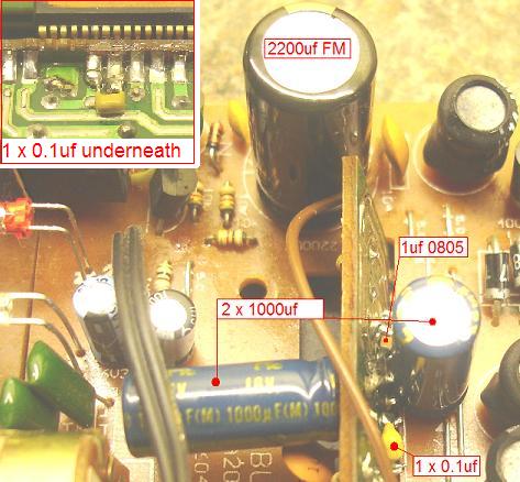

Well, the wife was out Christmas shopping and I found myself at a loose end last night so I broke open the case for a look… 😱 …..Oh dear, what a mess!
Although there is a strange logic to the way the boards are set out. The configuration allows you to get really close to the chip and not contaminate the outputs with power lines running too close. 😉
So out came the power caps and stiffener and in went 2 x 1000uf NIC NRSK’s and a 2200uf Pan-FM. Hmmm much better. Then I noticed there was nothing else filtering the rails so in went 2 x 0.1uf ceramics…as close to the chip pins as I could get them. Pretty difficult working on that vertical board! :xeye:
Before that I did notice that Cpump had 2 caps on it? A 100uf ‘litic and a bead @ 1uf. Looking at the datasheet it calls for a 1uf only, so I removed them both and dropped in a 1uf 0805 from my Sonic modding kit!
:att'n: (not sure if this was the right thing to do but I’m sure someone will put me right?) 😀
The input section is mayhem, with opamps, bass and treble filters and coupling caps galore so I left that lot alone. It’s driving a pair of old monitors in the kitchen at the moment and the tone control is quite useful.
Left the output section alone for the moment so I can assess any improvements although I have a set of aircores that would fit nicely! 😀
Later
Lee

panomaniac said:
Good work Lee!
Did the new electrolyctic caps help much?
It might be fun to keep the Boss (sic) control, but maybe loose the treble.
Let us know what you find and how the SQ goes.
Hi Michael, there is certainly an improvement in noise reduction! I hooked it up to my fullrangers last thing and it has lost all that hiss and hum.
It was too late to start lifting the volume so I'll do my full assessment this evening.
I still need to put a DC null circuit in there as well.
Not sure about touching any of that input section sir...I'll let the experts decide what goes and what stays! I would just bypass the lot and go straight to the chip pins but the tone control is too useful at the moment.
TTFN
Lee

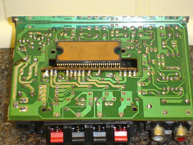

Look Out!!!!
Hi chaps, I forgot to mention on my last post that there are issues with grounding on these amps!!! :att'n:
When I took the PCB out of my case I noticed there was no insulation between the chip and the case so even if you are not going to modify it at least put some insulation in there
But…worse than that! Last night I had it linked to my CDP and picked it up…Hummmmmmm… Ah! The case is still grounded, probably by the pots on the front panel but you never know.
I then inadvertently put it down on my main amp which has a safety ground to its metal case……
THUD!!!
The blue fault LED came on for a brief second and the amp went into protection mode!
I had to disconnect the power cord to reset the amp (the switch on the front is just a mute). After that it was fine again but whatever you do, don’t earth the case!!!
I’m going to completely isolate the damn thing so this can’t happen again……..
Oh yes, and whilst I’m on the subject…I plugged in a floating source (MP3) and you get a hummmmmmm when it’s between tracks or not playing. This is easily remedied by earthing the ground lead on your interconnect.

Oh yes...and I think this amp sounds very good now, with 'boss' and treble wide open it reminds me of a modified Sonic, (a stark black background and 'haunting' mid/highs) not as smooth as an amp6 or Charlize...... but I bet that's the inductors talking 😉....and all those 'litics in the signal path :xeye:
Definately a good alternative to an over priced Sonic impact (in Europe anyway)
