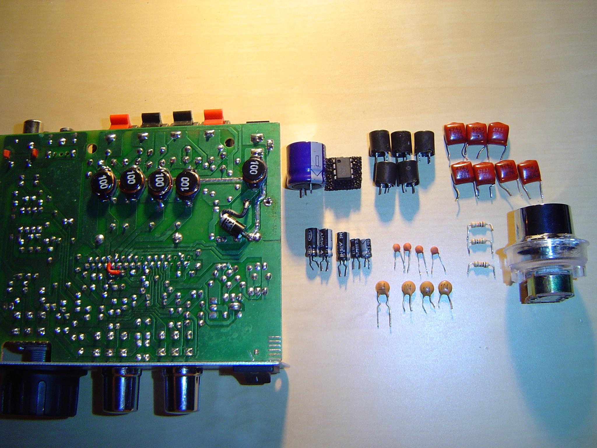

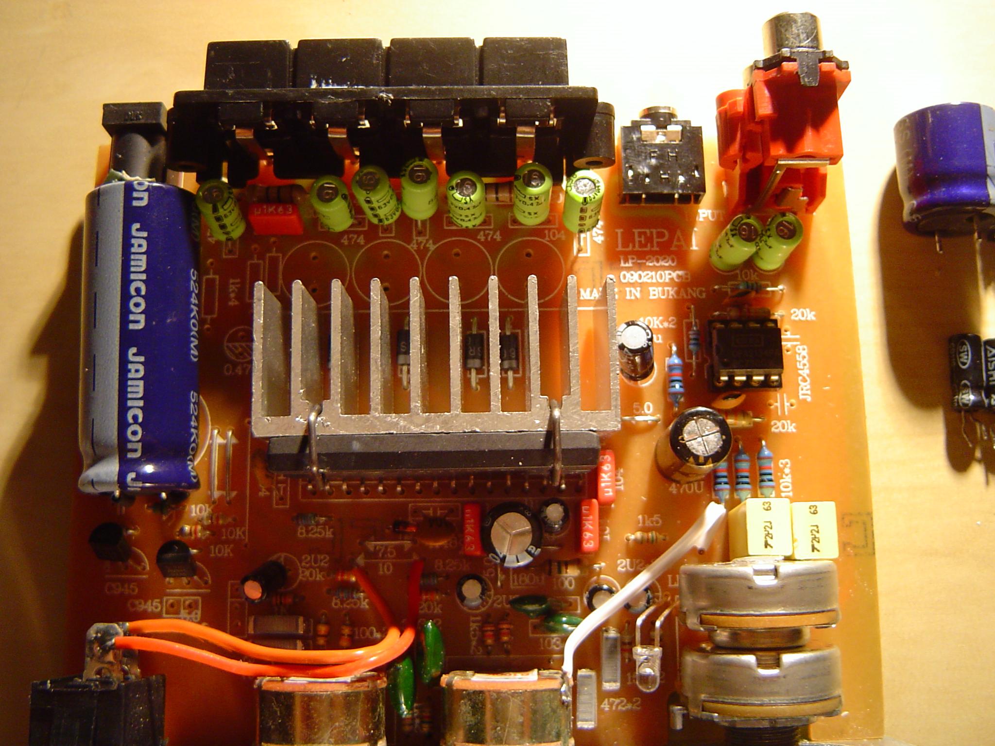

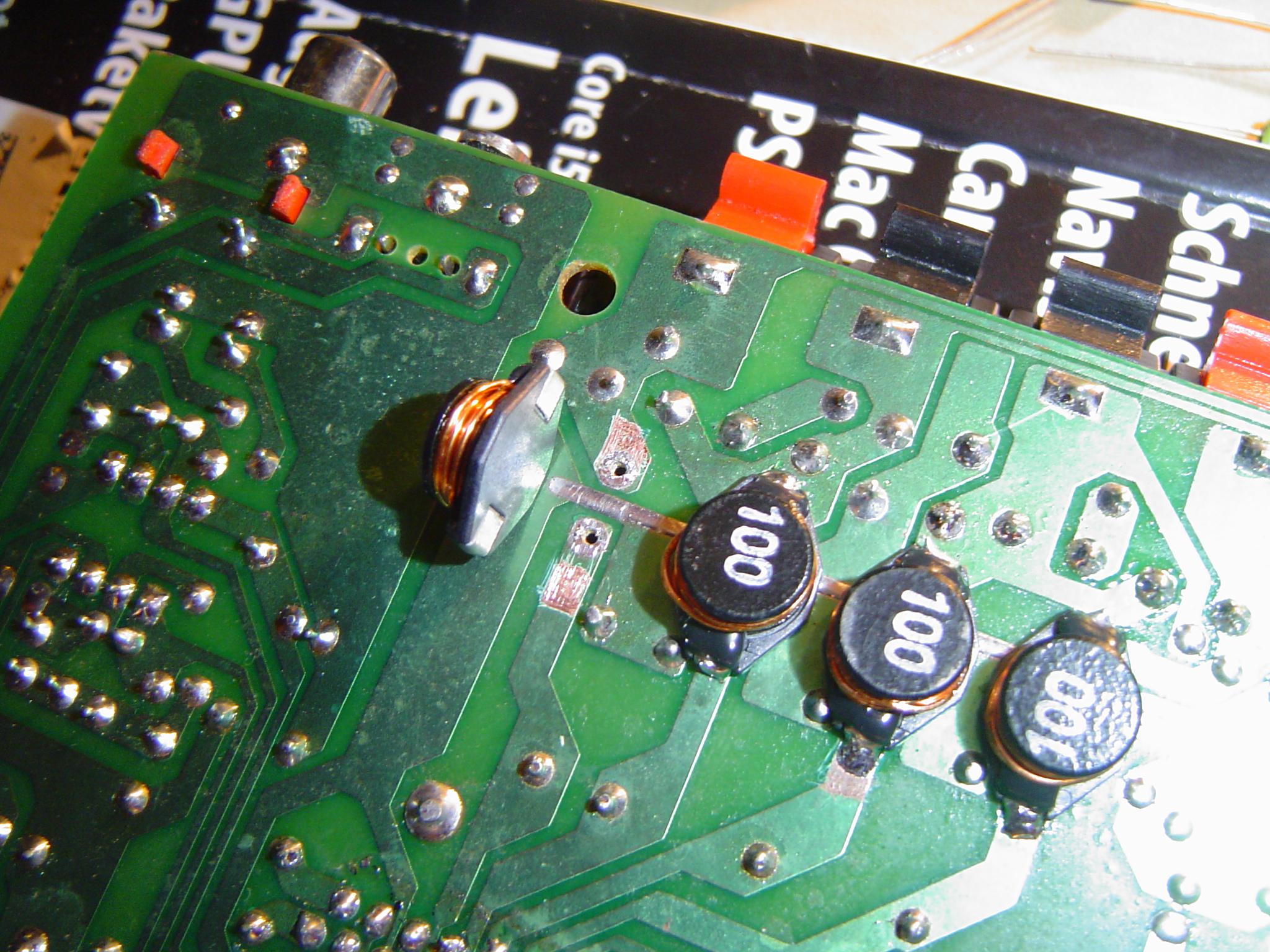

Just finished my Lepai
just want to share my "version" of modding this little beast. First i changed the potentiometer, the old on was garbage...
The new op amp is the OPA 2134 PA, don't know if this mod helped much. I also changed the input caps, resistors, coils of the signal path...
I moved some components to the backside, like the coils which are smd ones with 3.8 A. It is really tight between the coils and the case - but it fits.
Regards QT

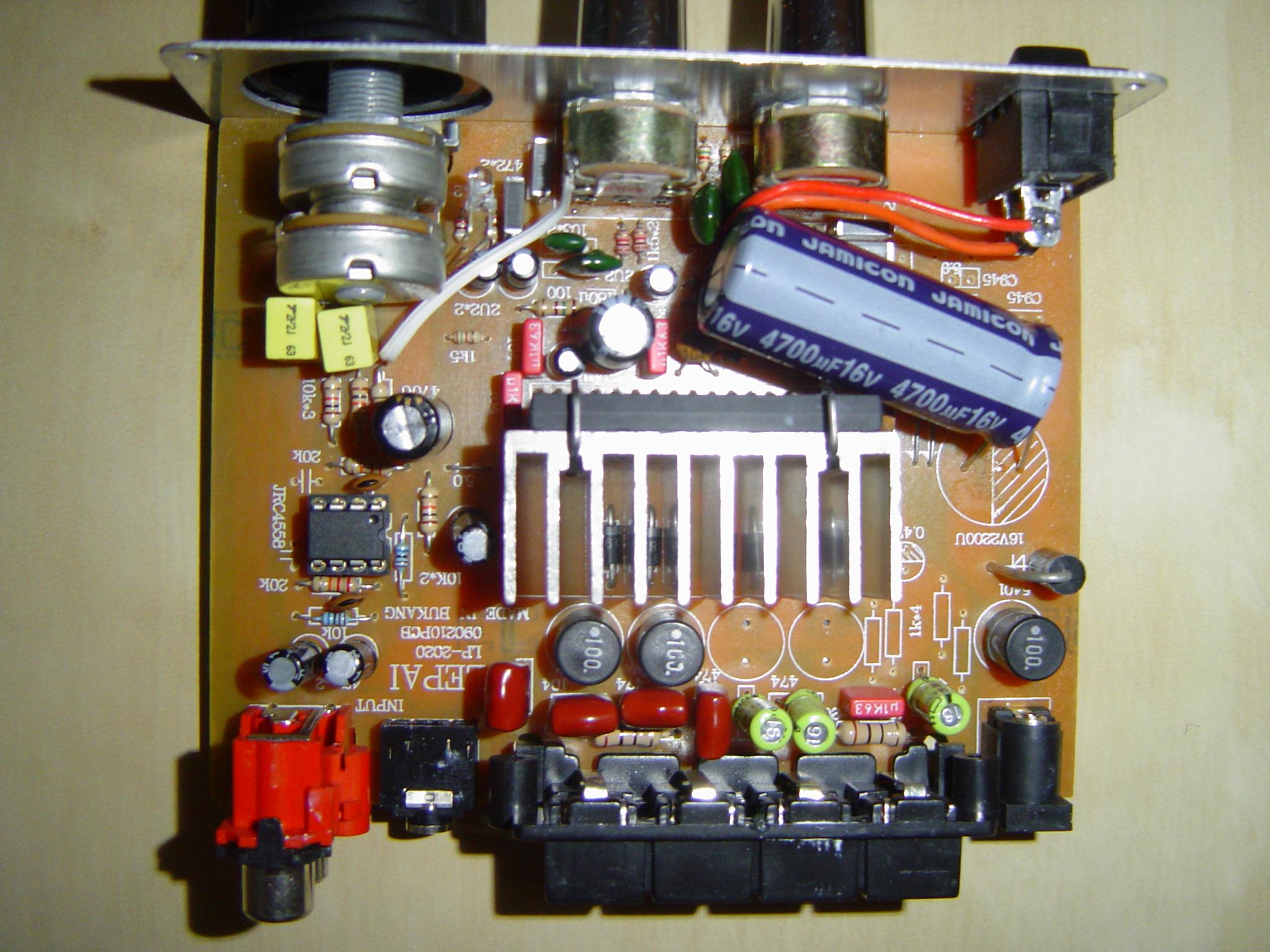

Hi res photos of my board.
http://upload.landslide.nu/upl/Tornado/_DSC3941.jpg
http://upload.landslide.nu/upl/Tornado/_DSC3942.jpg

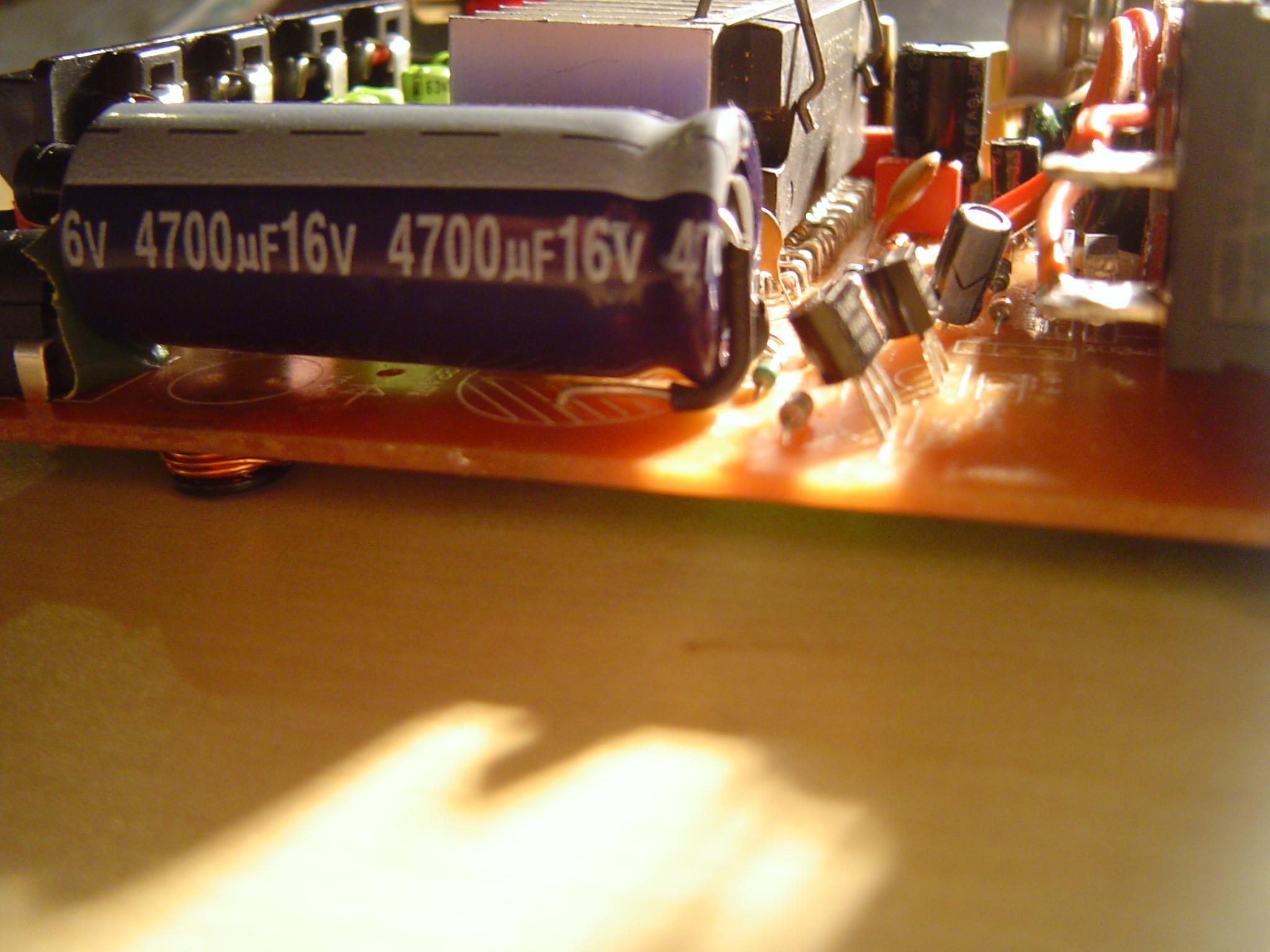

Changing the Pots
New to the forum but have recently gone down the modified Lepai T-Amp route coupled with pair of home-made Cyburg Needle TQWT speakers (still under construction) to complement my new 46" Panasonic Plasma TV.
Progress so far:
a) have changed 3.3uF input Caps to 2.2uF MKT types
b) swapped 2200uF for 4700uF Panasonic FC
c) changed all other 3.3uF electrolytics for 2.2uF Panasonic FCs
d) changed 330uF for 470uF Panasonic FC
e) swapped op-amp for NE5532P
7f) added d.c. trimmers etc. (as per #465 on Pg 47)
Still to do...
g) change tone circuit capacitors and resistors (#484, Pg49)
h) change out Pots for better ones
and possibly...
i) add remaining 4 shottky diodes
j) replace 10uH inductors
my question is: do the control knobs come off in one piece or are they fixed to the pot spindles?
