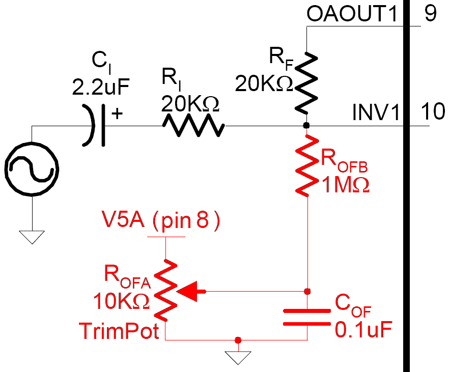

In view of this I decided to try the HLLY TA2020 board. This has multi turn pots to null out dc offset
On switch on with this amp I measured less than 1mv per channel and was able to tune this down to zero. I’ve run this for over a month and have just measured .2mv on one channel and zero on the other.
Nice little amp and absolutely no switch on thump.
I did most of the mods to the Lepai promoted on this thread ,op amp change, tone control bi-pass,
Cap changes etc but I would still like to address the dc offset situation.
Surely correcting this on the Lepai would help the switch on thump situation.
From what I can find it seems that 1 50k multi turn pot 1 resistor and a cap on each channel is all that would be needed.
Has any one tried this.
Being unused to SS circuitry I need some guidance on how to implement this type of mod

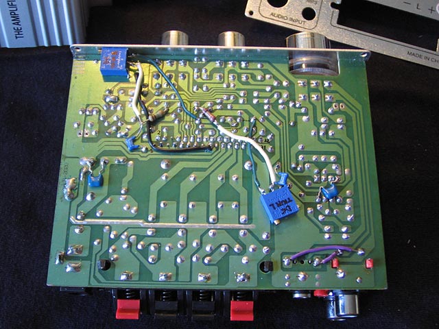

Well, I couldn't resist trying the Lepai 2020 so I bought one from the Bay. It's the same one as the right one in this photo by MikeHunt. It works pretty well out-of-the-box but being a seasoned hacker, I have made some modifications in the meantime. Here's a list:
- Grounded the volume pot casing: it wasn't grounded due to the plastic ring with the LED separating it from the case, and a hum could be heard when touching the volume knob. I guess they just forgot to solder the grounding wire in my amp.
- Added a 'mute' switch (which is connected to the IC's standby pin). I use this to avoid the turn-on pop.
- Replaced the opamp with a NE5532AP. Also started to replace some of the tone circuit components, but this is still a work in progress.
- Added some more decoupling capacitors and replaced some of the existing bulk capacitors with larger values.
- Added DC offset correction with the circuit shown by Lostcause. I trimmed the DC on the speakers from a whopping 120mV and 60mV to near zero. This is a highly recommended mod. There's just enough space on the underside of the board to fit the trimmers if you sand them down a bit.
- Dimmed the blue LED by giving it a larger series resistor.
- Corrected the swapped L/R channels on the 'MP3' input.

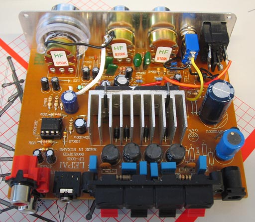

Here are some pictures. The trimmers in the second photo are sanded to about 4mm thickness and glued to the bottom.drlex, that sounds like an impressive list of mods. I found that changing the inductors made the biggest improvement in bass. Another mod that is totally worthwhile but I seem to be the only person to do it so far, is to replace all the resistors with 1/2 W metal film. This lowers the noise floor considerably.
col.

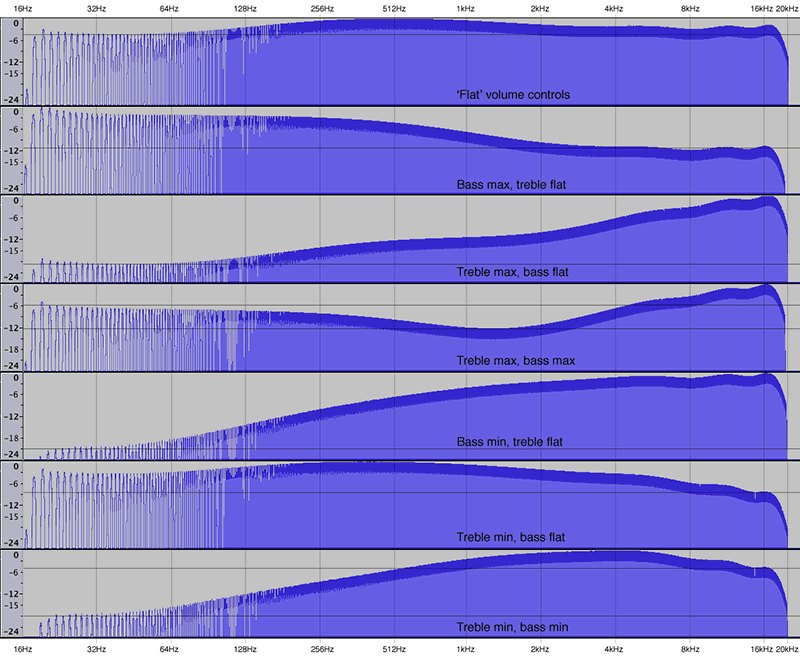

The third image shows some frequency responses obtained through an improvised set-up. I fed the amplifier a constant amplitude sweep from 16Hz to 20kHz, and recorded the speaker terminals' output in Audacity with a 6Ω load (didn't have any 4Ω resistors handy). This was done through a transformer, which causes the small bump at the lowest frequencies and the 'wobble' at the highest frequencies.
There seems to be an overall loss of bass indeed: with both treble and bass set to max there's only a +6dB bass boost while there's a +12dB treble boost. With both controls set to min, bass is attenuated much more than treble.
