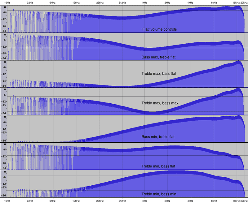

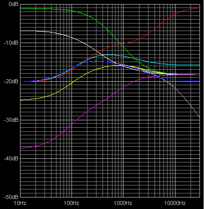

Either bypassing the tone control section or correcting it is also highly recommended. As djnemesi and col already figured out, the tone control is a 'James' Baxandall variation. From simulations it appears the component values that are installed as well as the ones printed on the PCB, are both horrible. With both controls set to neutral, the frequency response is nowhere near flat, it has a huge bump in the midtones. And to top it off, the components are cheap and inaccurate.
The first attached image shows the responses for bass/treble controls set to 0, 2.5, 5 (flat), 7.5 and 10 for the values that are installed. The curves correspond reasonably to what I measured when taking some extra loss of bass into account. The second image shows curves for the printed values, not much better.

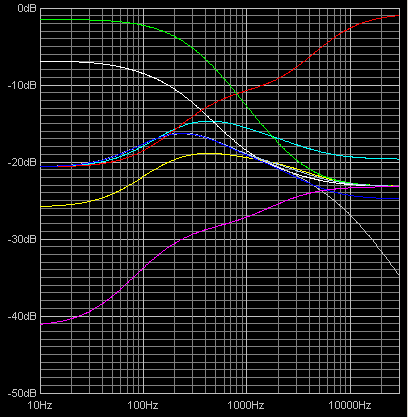

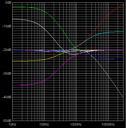

I would suggest the following replacement values (component numbers as on the webpage). This will give the much more balanced characteristics from the third image. As soon as I have the right components, I'm definitely going to do this fix:
R1 (installed 10k, marked 15k): 20k
R3 (installed 1k5, marked 1k): 2k2
R4 (installed 1k, marked 1k5): 10k
C1 (installed 10n, marked 472): 5.6n
C2 (installed 47n, marked 393): 56n
C3 (installed and marked 10n/103 near bass pot): 1n
C4 (installed and marked 10n/103 near treble pot): 10n
There is an additional resistor not in the original James schematic at the treble potmeter (installed somewhere around 300Ω, marked 100). What this one does, is for some reason preventing that the treble control can be set all the way to 0% or 100%. It can be safely replaced by wire links or by any other small value (the marked 100Ω is OK).
Use metal film resistors and your preferred type of film capacitors. Even for C4 which stays the same value you should remove the existing components and replace them by something of higher quality. You can also replace the potmeters although for my needs they are acceptable.

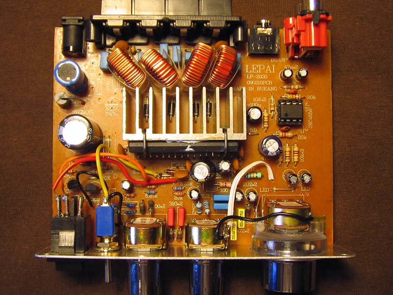

Hello Drlex🙂
just a small Q's regarding the R & C that you put. As a newbie on elctronics do I need to change 2 pairs of the value that you mention?example R1=20k.there is one another beside of it, do i need to change that too? and One more thing on the input resistor between 2.2uf pin 9,10 do it really need to change it to 20k as marked on the pcb is 8.25 something?

Yes, of course there are two pairs for each value, after all it's stereo. I have borrowed one of col's photos to indicate the positions of all components. I haven't checked which exactly belong to the left and right channel, so the 'a' and 'b' components don't necessarily correspond. R7 is the extra resistor at the treble control. As you can see, the 8.25 resistor is not part of the tone circuit.just a small Q's regarding the R & C that you put. As a newbie on elctronics do I need to change 2 pairs of the value that you mention?example R1=20k.there is one another beside of it, do i need to change that too? and One more thing on the input resistor between 2.2uf pin 9,10 do it really need to change it to 20k as marked on the pcb is 8.25 something?

All right, the capacitors for the tone circuit and the toroids arrived yesterday. 😎 I first did the tone circuit and repeated my "poor man's frequency response test". The curves look much better now, and approximate the ones from the simulator. And of course it sounds a whole lot better. As you can see, with the controls 'flat' (i.e. both knobs centered), there is already a bass and treble boost. To get the response really flat I need to turn the knobs more to the left. The reason is that the built-in potmeters aren't logarithmic 😱. They appear to have some weird sigmoid-like characteristic.
After this I replaced the ridiculously small inductors with the toroids, and repeated the experiment. But there was no effect on the curves, they look identical. I guess this is because I had to set the volume very low to avoid oversteering the line-in of the recorder. At such low volume the currents are small and the crappy built-in coils probably don't cause much degradation yet. So the only test I could do is hook up some speakers and crank the volume, and it certainly sounds great.
While I was experimenting anyway, I did some tests with bypassing the entire opamp/tone section and only the tone controls. The good news is: the frequency response is perfectly flat in both cases. That is, of course, after all my hacks, so I can't tell what it would have been with the standard components.

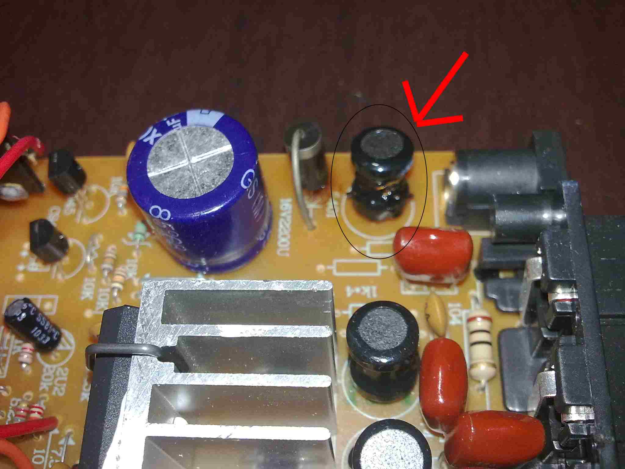

Hello,
I bought a LEPAI TA2020, but when I connected in to the power supply 12vdc 10A, my Lepai broke.
I opened it and I saw that an inductor burned, please, look at the photo.
I have to replace it, wich inductor or coil (i don't know) i have to put it (specs).

Hi dj_vini are you sure that you have your supply the right way round. The diode next to the inductor will short the supply if it is the wrong polarity and cause the inductor to burn. The inductor is probably the same as the others on the board ie 10uH. It needs to be able to carry the full supply current about 4-5 amps.
