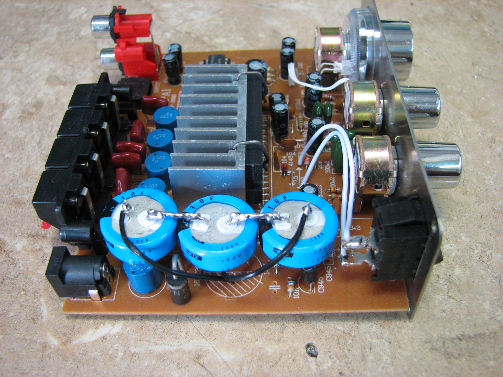

Ultra capacitors
I have been using the LApai amps for a several months now and really like them. I first had one and then got a second one. I have them hooked to my computer , one is the main front left right channels and the other is for the subwoofer channel.
I made a power supply by using an 8 amp switching supply and hooked that to three large 1 farad stiffening capacitors that are normally used in auto sound systems and it works very good. I can get floor rumbling bass out of the amp.
I have found that just one of the bigexterior stiffening capacitors was not enough as when I turned the volume up the voltage wolud drop on the digital readout. When I hoooked three up together and had an 8 amp power supply it could hold the voltage steady even at loud volumes.
Just recently blew the main amp out and have ordered two more. I plan on doing some modifications to it like I have read on the forum here, probably starting with the input caps.
So after all that I have also been looking into Ultra capacitors. with a few of these one could get up a farad or more worth of capacitors inside the lepai case, What you can do to start is hook three of the 5.5 volt 1 farad ultra capacitor in series so they can handle 16.5 volts max, which wolud be fine for a 12 volt system. With just three of them you could have about 330,000 uf worth of capacitor inside the case of the lapia 2020.
Each of them is only 3/4 inches in diameter and about 1/4 inch thick.
thats all for now. If any one wants photos let me know.
I just installed the ultra capacitors in my amp, and here is a picture.
total capacitance is 333,333uf

No I was just sharing info an adding capacitors. not as a remedy for your non working ones. I had one of my amps blow also a couple weeks ago. I think its just from puttting in to strong of a signal in some cases.
