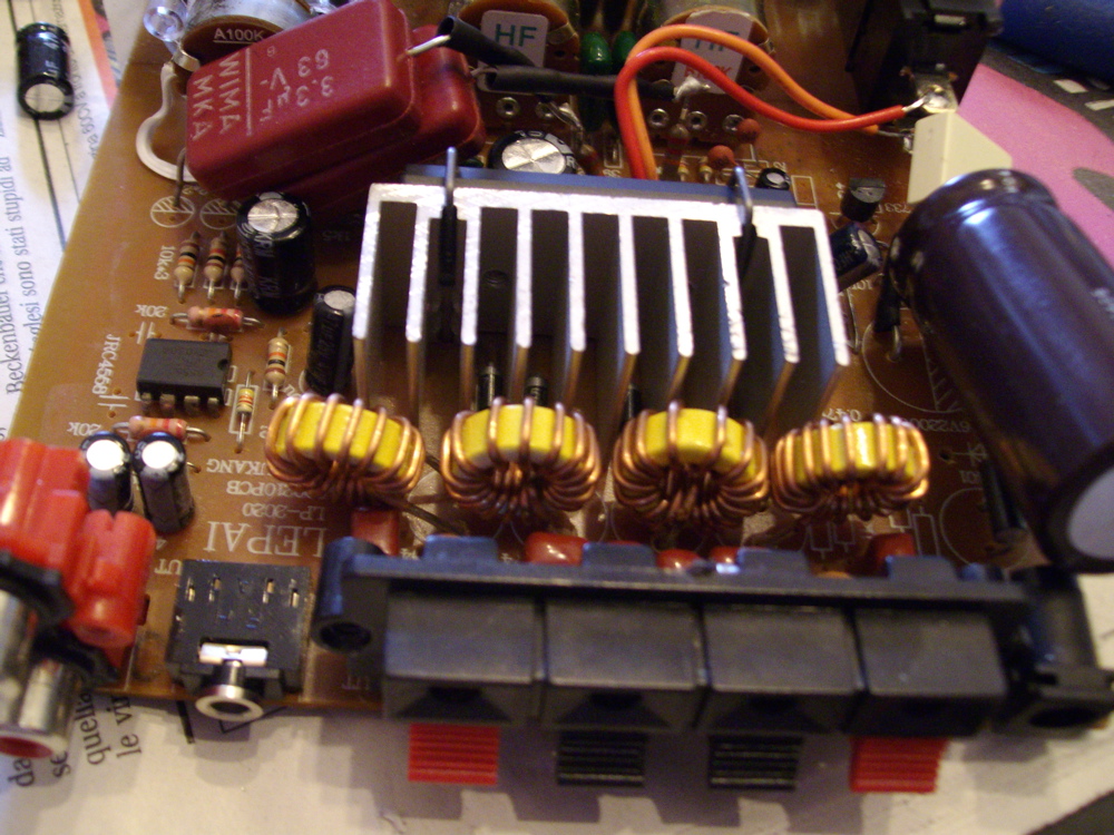

Hi, i have bought 3 Lepai TA2020 amps and they have all broke 🙁.
I have hooked them up to a car battery some 4ohm speakers and a mp3player. It all sounds great until I turn up the volume and the amp breaks. After that all i get out of it are some clicking sounds and the led light.
Since there are no fuse i have no idea what's broken inside. Have anyone encountered the same problem? is it fixable? or should I just buy yet a new one?

If you bothered to read this entire thread you would already have the answers. First you need to remove the little orange zener diode that is just in front of the chip. Second, don't allow the input voltage to go above 13.2v.

Hm.. The ticking stop when i removed the zener diode but still no sound. I don't know if it input volt was over 13.2 though, i don't have a mulitmeter.
All it dose now is make a sound when i turn it on an then go quiet.

Don't forget to remove the little zener diode. If the amp develops a fault the diode puts it into a reboot loop and the amp burns out. Thats the "ticking" people are reporting when their amps die. Also, it's worth changing the pots if you can find some that are a drop in replacement. The stock ones are all over the place (read DRLex posts).

Ok so here is my little list that I put together so far.
1. Remove the zener.
- Not sure what it does but everyone says to remove it bc it can blow the amp.
2. Replace the opamp with a ne5532.
- Don't know what that does... something with tone control?
3. Replace input caps with 2.2uf metallized polypropylene (google says its 2 L's but firefox says it's 1 L, idk how to spell it.)
- Again, I don't know what this does
4. Replace inductors with 10uH 3A toroids.
5. Fix tone control component values.
Code:
R1 (installed 10k, marked 15k): 20k
R3 (installed 1k5, marked 1k): 2k2
R4 (installed 1k, marked 1k5): 10k
C1 (installed 10n, marked 472): 5.6n
C2 (installed 47n, marked 393): 56n
C3 (installed and marked 10n/103 near bass pot): 1n
C4 (installed and marked 10n/103 near treble pot): 10n
that's all I really have for now. I will do some more searching through this thread. If anyone wants to reply to this and throw in some info, they can and I will edit this post.
