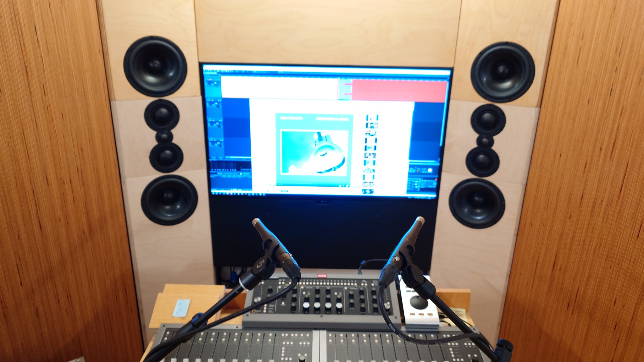

Only big words here - where are your recordings! 😎
Finally found time to do mine. Listening position, MicW M215 microphones. Pointed to the tweeter to get a more realistic recording of them (difference is not that big). I have a table reflection with this quick setup, you can hear that in the midrange (when you know the system).
It's a pitty we can not add soundfiles here ...

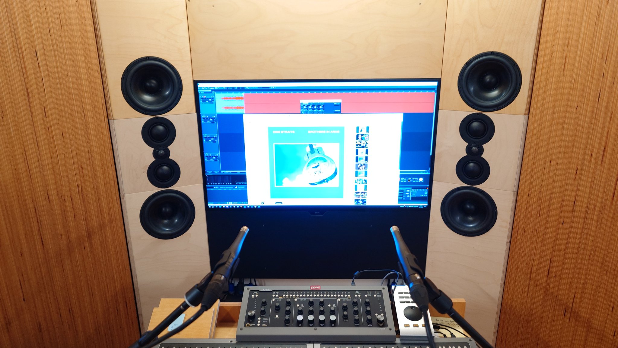

.wav file is to big to share here - but 2 photos from the recording positions I tried.
With this mic distance there is not to much room information with an AB setup, stereo base is not fully used. But I wanted to stick in the area where the head would be.
p.s.: No idea why people use that song as reference. Plastic, extremely processed drumset of that area. Will sound good on most speakers. Repeats the whole time, could have been 2min30s without loss ... and now had to listen to it a few times completely ... just for you guys! 🤓

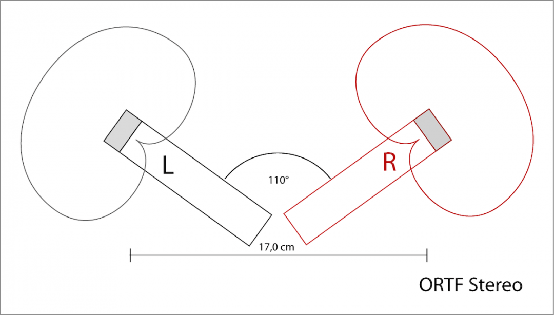

Try ORTF layout with a cardioid pattern mic for recording.
https://en.m.wikipedia.org/wiki/ORTF_stereo_technique
"ORTF is a very balanced method of stereo recording that sounds quite natural and similar to how we perceive sound in the real world"

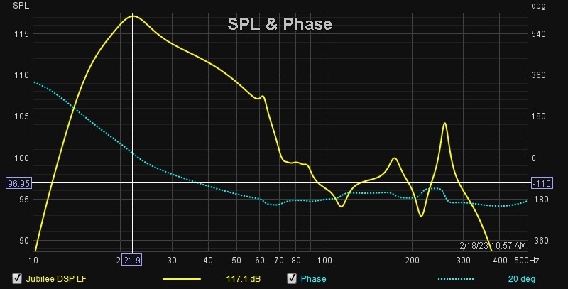

Room behaviour at LF is far too specific to the room to prescribe a one-size-fits-all EQ.
Here is the bass bin channel EQ curve right out of the (fixed) second-gen Klipsch Jubilee DSP crossover:

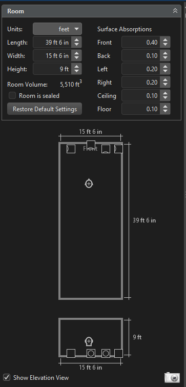

In order to tame its bass response in any home-sized listening room, you'll need to start with that big attenuating PEQ with that Klipsch-supplied fixed DSP crossover that was set up for half space only.
For the exact type of "small listening rooms" typically used in home listening rooms in the UK (which is apparently your part of the world) as opposed to the part of the world where the Jubilee is made and engineered--in the south-central US, my guess is that the Jubilees would actually need more attenuating EQ than the one PEQ per bass bin channel I mentioned above. But that one PEQ will likely get you much closer to the response of the other Klipsch loudspeakers shown in YouTube video--where pretty obviously none of them were properly EQed in for the room, loudspeaker placements, and microphone positions used in the video.
I neither like nor own headphones (and its okay to ask me why--I don't bite too hard)--and I'm pretty sure that most diyAudio enthusiasts don't own recording heads - which are really expensive to do well, and are basically required for binaural recordings.I'm curious why you'd recommend the Blumlein pair.
The author of the video is likely using poorly suited stereo microphones built into a smartphone or lower-end video cam. These are typically awful for purpose. My suggestion of a Blumlein pair is simply more representative for use in the listening spaces of many listening rooms (i.e. very small and poorly sealed for use in the bass pressure zone). These can be bought as a relatively inexpensive pair for less than $1K. Recording heads of any real quality for purpose are much more expensive--and bulky to store around a hi-fi store of the type shown in the video.
My listening space does have diffuse returning echoes--doesn't yours? (That's actually a joke--for our literal-minded diyAudio "experts")...

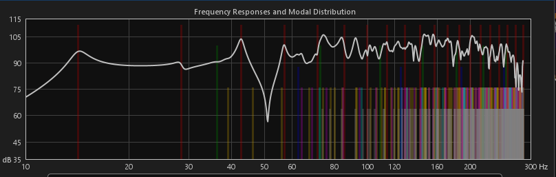

Simulated amplitude response corresponding to the listening position(s) shown above:
