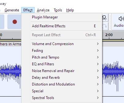

I'm not too familiar with Audacity, how would I import and make that EQ file work?Use the Audacity custom EQ file

Within Audacity with the "So Far Away" track opened, select Effects --> Equalize... then notice a curve pops up.I'm not too familiar with Audacity, how would I import and make that EQ file work?
Hugo
Here is where you will open the example xml file that you found above in this thread, by clicking on the "Save/Manage Curves" button at the middle-bottom of the curve window. Import that xml file by hitting the "import" button and searching for the xml file that you've saved locally. You should see the curve appear when you select if from the list. Hit "ok" to close the curve management window, then "ok" again to close and execute the Equalize... filter. You will see the traces change shape. You can then press the space bar to play the track, or stop playing.
You can use "undo" (ctrl-Z) to hear the original track again to compare, and then select "redo" (ctrl-Y) to hear the track EQed again to toggle back and forth.

Thanks Chris, unfortunately "Effects --> Equalize" doesn't show up.
Is there another way to access the "Save/Manage Curves" button?
See, I'm quite familiar with Audition that's why I lack the basic Audacity knowledge.
Version is 3.3.3

Audacity menus have changed since version 2.1.0 that I use (due to the spectrogram colors this version retains). I would think that the EQ function would now be found under "EQ and filters >" menu item, don't you?

Apparently the Audacity development team chose to change the format of EQ files away from xml file extensions. Here is a filter file for version 3.4.1 (enclosed below).
The new menu name for "Equalize" is now "Filter Curve EQ...".
