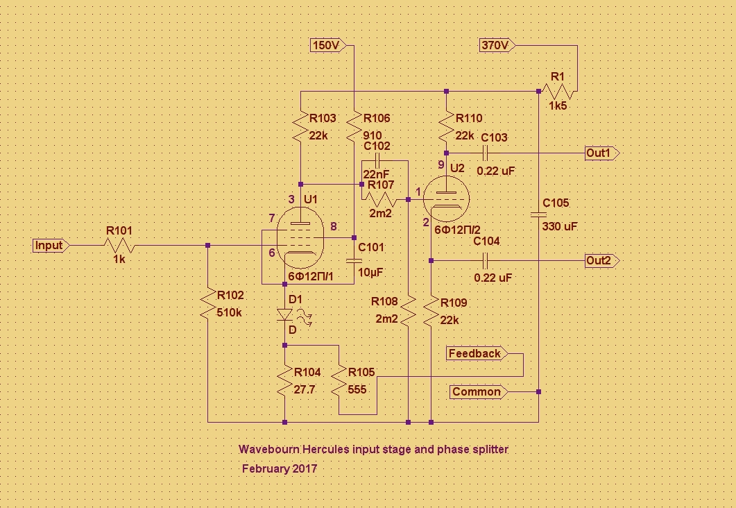

LED's will get you better S/N ratio, higher gain and higher distortion figures as the valves biased that way will saturate easily, no resistor-no feedback...I usually go with a combination of resistor//capacitor+resistor or resistor + led to get some feedback.
Do you put the resistor on the cathode then the LED? How do you determine the value of the resistor? Thanks for the help.
I use a resistor that has at least 10 times resistance than a dynamic resistance of the LED, just to apply feedback to it. Also, as you may see, the LED is above the resistor, so feedback ratio is stable and linear, while dynamic resistance of the LED is negligible against dynamic resistance of the tub e's cathode.
There's no rule for me.I am not concerned about the LED distortions, i am concerned about the valve distortions so i came to the conclusion that i prefer the noise of a resistor to the distortions generated by the lack of feedback when you use only led's for bias.
