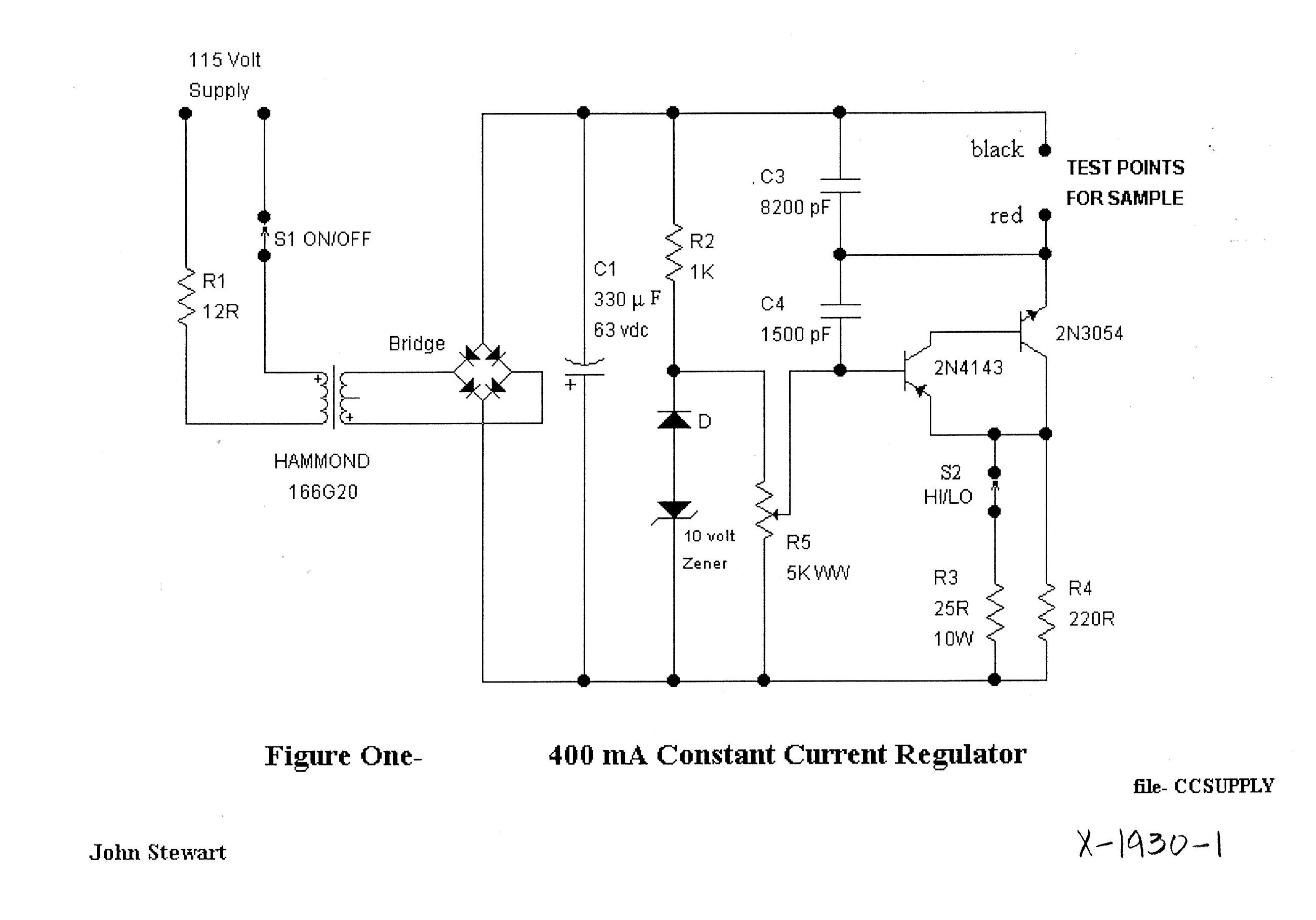

One of the more observant members of DIY has spotted some errors/omissions in the article I posted covering a variable constant current source used in testing. Thankyou Jon of Australia!
So I opened the Hammond box, the transformer I used is 20 volts, not 25 volts. But either will work. The 2N2907A will work OK in place of the 2N4143. Vcb 60V. The 2N3054 looks very expensive now. There are probably some good alternatives in a TO220. Zener diodes have a zero temp coefficient of voltage at 5.6 volts. Above that it is positive. And increases as the Zener voltage rises. Partial correction is possible by connecting a forward biased silicon diode in series. That is what the diode ‘D’ is doing in the corrected schematic.
There are better ccts out there now, but this was easy in 1969. And looks like writing the article in 2001, thirty-two years after the build required a little more care.
Still working & often used.🙂
<snip>
I've read that a single red LED used as a voltage reference with an NPN silicon transistor has quite a low tempco. Apparently the LED and the transistor's Vbe both have about the same change in voltage with temperature, and so cancel to a large degree.
The most recent batch of green LEDs I bought is more than bright enough for use as a power-on indicator at 80uA forward current, and is quite unpleasantly bright by the time you get to 500uA. With today's high-efficiency LEDs, it might be nice to extend your current source downwards to include 10 mA, 1 mA, and 100uA ranges.
That could be done with cheap small-signal transistors instead of the relatively beefy power transistor you used for your original design. Something like the BC550C / 560C would do the trick.
-Gnobuddy
I don't see how that's possible. This is an old school power transistor that's been around since the '60s. Last time I checked, they were going for under a buck a pop. hfe~ 25; ft= 3.0MHz -- that's pretty awful by today's standards, and you wouldn't want them as audio power finals..
A lot of really decent audio solid state went by the boards (thank the gov't for that) but 2N3054's are not the solid state equivalent of 300B's.
