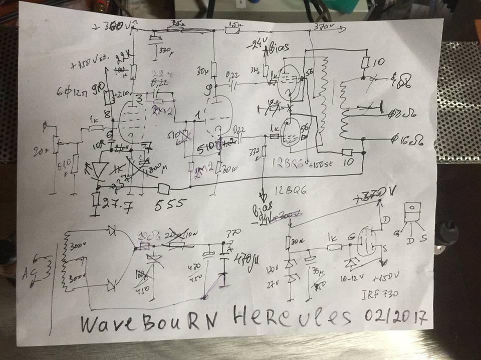

Right. And the output stage has local feedback in cathodes from 4 and 16 Ohm taps, to reduce global loop's ratio making the amp more stable and faster on HF, with softer clipping when occurs.

No, I am not. There is a big difference between a LED in cathode of a triode stage, and bootstrapped one by a global feedback loop, like I have shown. And please don't start here attacks on personalities like you did on a Prodigy forum. Let's stick to the technical discussion.

Well; for distortions obviously "proper" usage would be an opposite to what would be needed for less distortions. However, according to my experience, for shaping of a guitar sound saturated tubes better to be used. And it is better and more musical when the amp clips softly, for better sound expression up to a wild overdrive. I modeled a similar behavior with diode-resistive matrix in feedback loop of an opamp, and it sounded pretty toobey.
