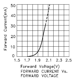

I think you have some misconceptions around electronic functioning. LEDs conduct all the way down to zero volts, albeit nonlinearly. Above 100uA say, the LED voltage will be in the region of 2V for example, more or less constant at higher currents. But as the tube current drops down to the microamp range, the LED forward voltage rapidly drop towards zero. But it doesn't suddenly stop conducting; only SPICE diodes can do that.If the LED provides 2v and the signal goes to (-)1v what does the LED see as a forward voltage? The total is (+)1v. Is that enough forward voltage to drive the LED for conduction? Or is the LED now in shutoff for all practical purposes?
That's just a sketch, this graph is more correct.
IV curves | LEDnique
Two things to keep in mind:The current through an LED is nearly 0 mA as the forward voltage falls through 1v. -.7v.

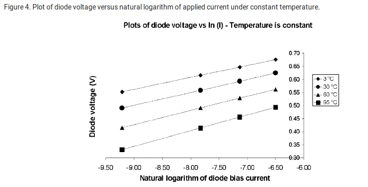

2) As several people have pointed out, the diode current is exponential with applied voltage. An exponential current grows so fast as voltage increases, that with the graph scaled to accommodate the largest current, it looks as though there is zero current near the left edge of the graph.
But in fact there is still current flowing, it's just too small to see easily on the same scale as the larger currents at higher voltage.
This is easily revealed if you plot the logarithm of the diode current vs forward voltage, rather than plotting diode current vs forward voltage. The logarithm "straightens out" the exponential nature of the diode current, letting you see what's going on even when forward voltages are small.
A quick Google search produced the attached image (taken from here: Plot of diode voltage versus natural logarithm of applied current under... | Download Scientific Diagram )
As you can see, the plots are almost perfectly straight lines (meaning the current is almost perfectly exponential) all the way down to 0.325 V or so. The currents are down to approximately 0.14 nanoamps at the left edge of the graph (this corresponds with the natural logarithm being -9.5 on the x axis of the graph.)
So we can see why the graph doesn't extend further to the left - the currents are already quite small, and it would take rather specialized instruments to measure these small currents. But there is no sudden cutoff of current anywhere to be seen on the graph - you can smoothly throttle a diode all the way down to less than a tenth of a nanoamp without the current ever shutting off.
So: we know the diode holds no surprises down to well below one nanoamp of current flow. The next question is, how much negative grid voltage would it take to drop the valve's current all the way down to a nanoamp?

Suppose we really slammed that grid with a big negative voltage, and managed somehow to cut off the triode all the way down to 0.01 mA, one hundredth times smaller than the quiescent current. Well, 0.01 mA is still 10,000 nanoamps!
And where is 10,000 nanoamps on that graph? 10,000 nA is 10 microamps, and the right edge of the graph (x = -6) corresponds to about 0.434 microamps. So 10 microamps is actually well to the right side of the entire graph, where those straight lines are just as straight!
The whole puzzle of "What happens to to the diode when the valve forces the voltage across it to become less than 0.5 volts?" turns out to be a red herring. Even if you apply a large negative grid voltage and shut off the valve all the way to 10 microamps, the diode is still happily conducting, and from the graph, we can see that the diode is still sitting at maybe +0.7 volts. (I'm looking at the 30 degrees C line, and extrapolating it to the right of the graph to reach 10 uA.)
What this means is that you cannot actually use the control grid of the valve to force the diode deep into cutoff. The valve cuts off long before the diode does - the cathode sits at roughly +0.7 volts, the grid sits at whatever enormous negative voltage you used to shut the valve down to 10 uA, and the diode is still quite happily conducting.

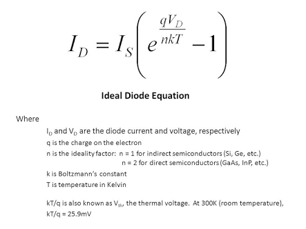

Just to avoid any concern, the LED dynamic resistance (ie. external cathode load) does increase as conduction current decreases. The amber 5mm LED I use has R~60 ohm over the increment 0.7 to 1mA, increasing to ~500 ohm over the increment 0.05 to 0.1 mA, but I didn't continue any measurement below 0.05mA.
It does indeed! If you take the Shockley diode equation (see attached image), assume the "ideality factor" equals unity, assume the diode is at room temperature, differentiate the equation,and work out the dynamic resistance (dV/dI), you come up with an extraordinarily simple answer: the dynamic resistance (in ohms) equals 26/(diode current in mA).Just to avoid any concern, the LED dynamic resistance (ie. external cathode load) does increase as conduction current decreases.
So for an ideal silicon diode, the dynamic impedance is 26 ohms at 1 mA forward current, 260 ohms at 0.1 mA, 2600 ohms at 0.01 mA, and so on. Super-simple!
In practice this result works well at currents well under a milliamp, but isn't usually correct at larger currents, where ohmic resistance from bonding to the silicon die, bulk resistance of the P and N regions, and other factors start to cause increasing errors.
For the materials used in typical LEDs, the "ideality factor" is 2 rather than 1, and this has the effect of doubling the dynamic resistance. So now we should have 52 ohms at 1 mA, 520 ohms at 0.1 mA, and so on. Note that those numbers aren't too far from the numbers Trobbins measured.
And back to the "What if the diode shuts off?" concern, notice that (26/I) never becomes infinity until I is mathematically zero...even if you have only ten microamps of diode current (which is 0.01 mA), the dynamic impedance of the diode is 2.6 kilo ohms, not infinity.
