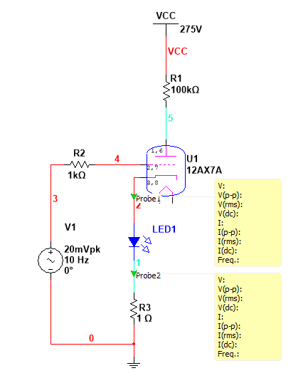

The 12au7 I referrenced was just another example of 10uA being cutoff, it was on the top of my head at the time. I could have used 6sn7, too. I was adressing PRR in establishing what type of current level was considered effectively 0, because he didn't want to accept the term I used, of nearly 0 amps, when an LED was shut off. In your post above this, asking how often does it happen, I think the question is, when will it happen. When does a diode LED become reversed biased? If the diode has 1.5v across it, and the signal (-) cycle has (-)2v, is it reversed biased? Or is there still 1.5v on the cathode no matter how large the signal goes (-) on the grid, and still flowing forward current? Does the tube never see cutoff until it goes to (-)18v on the grid, (if the plate voltage is 250v.?) Never mind the grid current clipping on the (+), it's a given.
I'm not sure I know enough about the physics of the situation, but my understanding is that LED bias is best used with small signal stages, such as in phono preamps or hi-fi line level stages. One would not use LED bias in a power stage that would be expected to clip often.
Similarly, a CCS or gyrator plate load has a sharp cutoff between safe operation area and overload. While a CCS in the plate load of a triode will reduce distortion and maximize gain, it will also make the transition to overload (grid current or cutoff) very abrupt, with harsh clipping.
So while I think you're correct that using LED cathode bias would create complications as that stage approaches overload conditions, I don't think it's good practice to use LED bias in a stage that's likely to be overloaded in normal operation. That's why you'll never see LED bias used in a guitar amp. The clipping would be gnashy and nasty, which is the opposite of what you want from a guitar amp (and helps explain why most tube guitar amps employ basic circuitry made with nothing but tubes, Rs, Cs, and Ls).

The tube will "cut off" LONG before the LED will.
Try it. Any tube you like. Any circuit which will pass audio (we agree that picoAmps is not a happy place for audio).

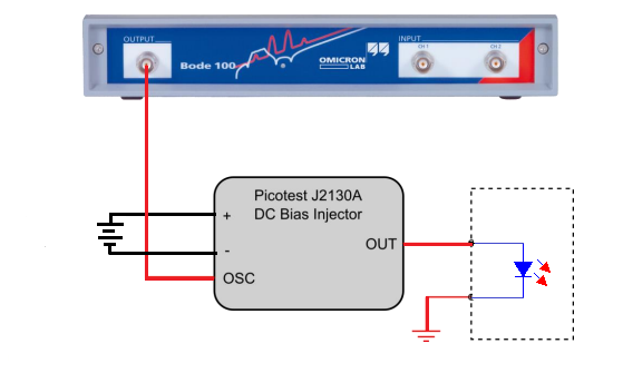

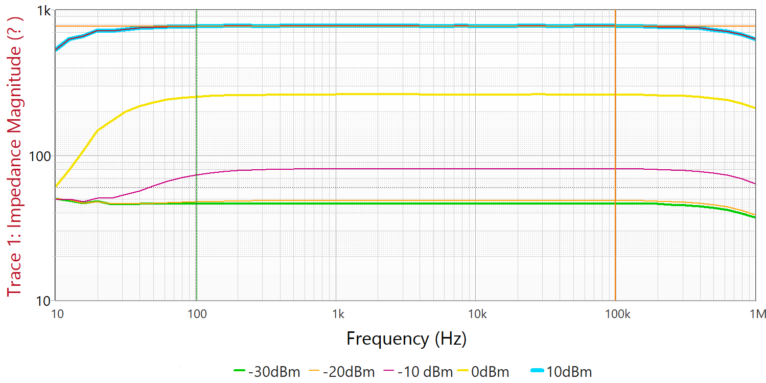

Did this run of various stimuli -- from -30dBm to +10dBm -- with 1.25mA flowing through a red HLMP 1340 LED:
Perhaps there is waveform distortion occuring in the test signal, or some other effect related to the test jig? I just doubt the LED is the cause of that response.
Some effect of the test jig? I have placed an inquiry. The baseline 50 ohm Caddock is ruler flat when using the J2130A DC Bias Injector.

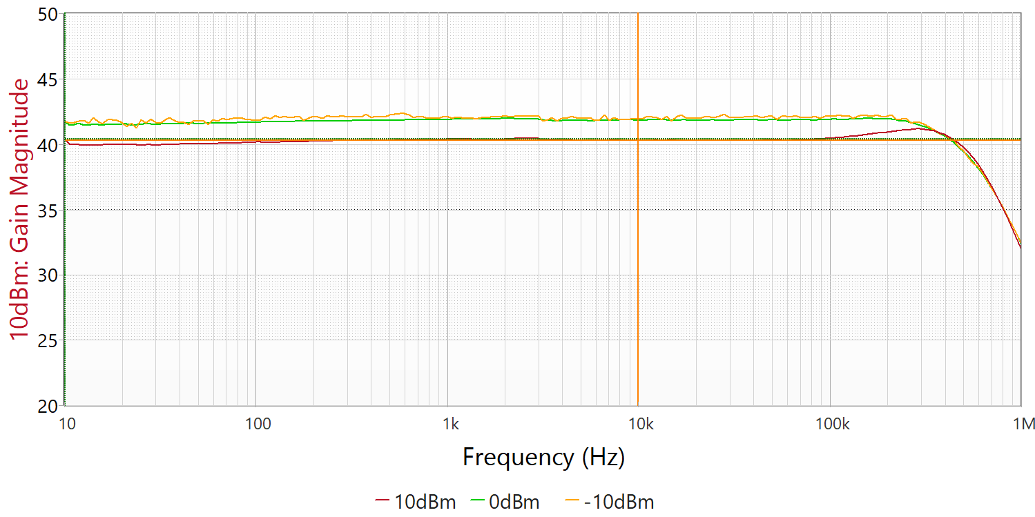

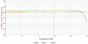

Using the "Gain" method, I get consistentcy -- Z at -10dBm, 0dBm and +10dBm:

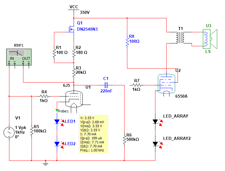

6J5 is half a 6SN7 with an attachment (pin1) to the can. This is cobbled together from one of SY's ideas -- use two LED's to bias the 6J5 to 8mA. The DN2540 is a $0.80 part and one is almost as good as two!
You can decide the circuitry around the 6550/807 etc/
I don't understand why you would post a circuit for a 6j5 x 6550 SE amp with LED bias when your data seems to indicate a problem with cut off when implementing such a bias scheme? Did i misunderstand the gist of your graphs?
See post 110 -- it's an issue with the text fixture itself with stimulus above -10dBm. Took a little digging to figure this out.
the network analyzer method in which the voltage and current are divided yields consistent results.

Hi Ron, I did not ponder this statement, which is the case for the amp that i have. The actual bias resistor that i chose for the 6j5g is 400 ohm. I like the way the amp sounds but wanted to explore some different arrangements, and installing a led is very simple.
Is there a work around the increased gain or should i even worry about it? Thanks again
Note that if the 6J5 in your circuit uses its 1k resistor with no bypass capacitor, then it's using current feedback from the unbypassed cathode resistor. Putting an LED in there will ruin that. (Gain will go up quite a bit.)

The increased gain from using an LED for cathode bias is the same as if you put a 470uF capacitor in parallel with your 400 ohm cathode bias resistor.
Have you read up on how with a triode, a cathode load resistor that is not bypassed by a capacitor induces negative current feedback through the cathode?
Try reading this, especially the section "The common-cathode amplifier configuration - unbypassed cathode"
