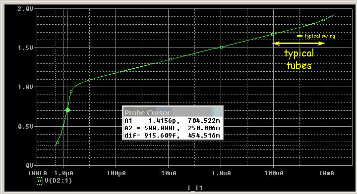

The characteristics curves of LED's shows the current becomes nearly 0 around .7v. Stacking 3 of them would bring the turn off voltage to @ 2.1v. So if the grid signal is high enough the stack is going to essentially shut down in the negative portion and clip as if it was AB1 biased. That's about 50% loss in (-) swing.
PRR
Joined 2003
The characteristics curves of LED's shows the current becomes nearly 0 around .7v.....
What is "nearly zero"??
Current is a Real number and can be "infinitely small" without being zero. We have to put numbers on things.
My sim shows 0.7V happens at 1.4 PICO-Amps. I do not trust this result even to a factor of 1,000. However even if we assume Nano, even Micro-Amps we are far-far-far below the typical 0.1mA-10mA operating zone of small tubes. A class-A tube idled at 1mA would typically swing at-most 0.5mA-1.5mA to stay linear. We are never going to be down below a microAmp.
Note current is plotted log-scale.

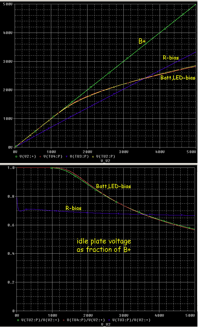

I simmed how plate voltage varies with B+ for a very wide range (1V to 500V).
Where do we want plate to be? For ideal device and infinite load, half of B+ is reasonable for symmetric signals (or asymmetric sounds of unknown polarity). For real devices and loads some other value may be optimum for swing. 12AX7 is a high-resistance tube, not much more conductive than typical loads, and a high-side bias near 2/3rd may be a good trial value.
Re-plotting plate voltage as fraction of B+, we see the resistor-bias scheme holds 0.67-0.7 of B+ for any reasonable supply voltage. (This sim is not to be trusted too far below 100V because contact-potentials are not modeled; but experience says we can go well below B+=100V before trouble arises.)
OTOH the battery and the LED bias are "stuck to B+" until B+ comes over 140V. Even at 250V of B+ we have only 20% or 50V across the load resistor; the resistor-bias scheme has 80V on the plate resistor. However at high B+ the relative plate voltage goes low, eventually going lower than optimum. (For less-insane B+ values we should probably re-bias the whole stage. However we only have limited choice of LED voltages.)
We see that, for 12AX7 and a Red LED, the bias is just awkward until we get to higher B+. And indeed the killer app for an LED under a 12AX7 is a Guitar amplifier (high B+) and especially its Tremolo oscillator (where subsonic response is essential).
OTOH the supply sensitivity is not as bad as I'd innocently thought. For a +/-16% swing like 300V-400V, the plate voltage variation is <8% which is usually plenty stable.
