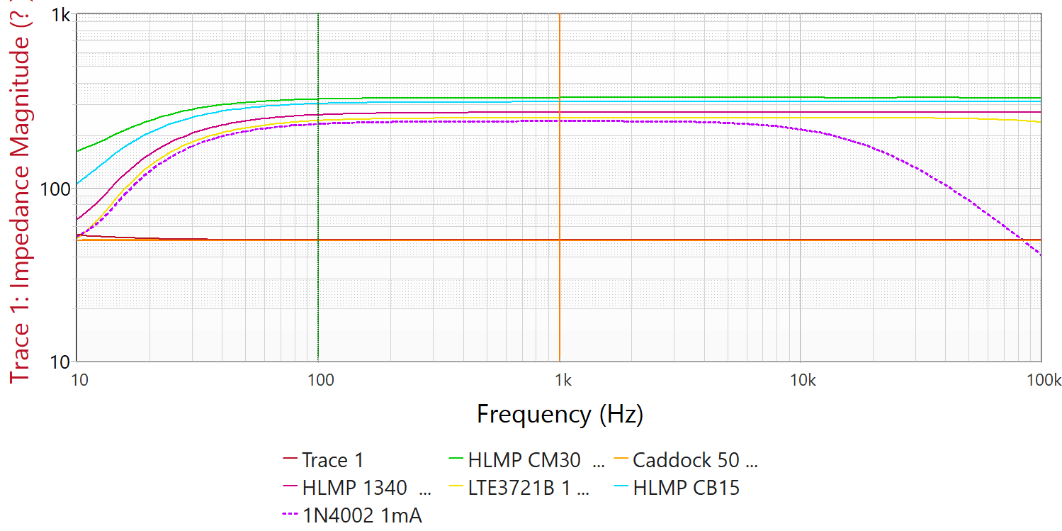

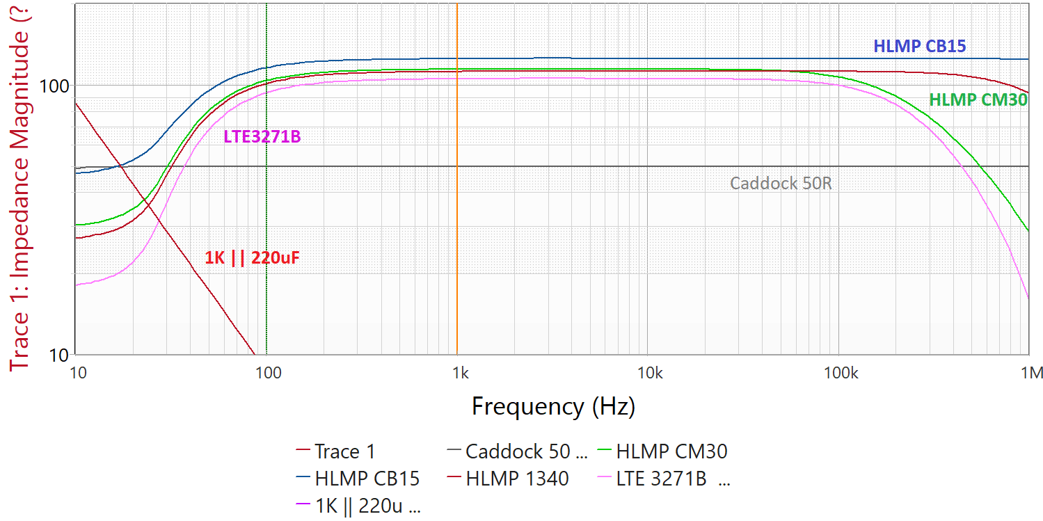

Just to throw some smoke into the discussion -- I used a current injector to look at the dynamic impedance of some older (pre-Avago) LED's and an Lite-ON Infra-Red device. First graph uses 1mA, the second 2.5mA:
