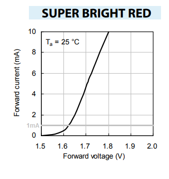

You can load the LED through a separate network in parallel with the circuit as SY or somebody else if i don't remember well did in his phono preamps.It's also good at start up!Since the current going through it won't vary much at all, the Vf stays constant. So in the real world, tests have shown that using a cheap red LED to get about +1.6V at the cathode of a 12AX7 works fine.
I haven't tried to cross check the V-I curves of LEDs of the same colour, but of a range of models, such as different Mcd ratings (but still in 3mm or 5mm common packages as would typically be used in amps for preamp stages).But not all LEDs are the same. The low current ones will be less affected by low plate currents.
For that type of LED, I would guesstimate that the V-I curves are fairly similar between the different 'efficiency' performance grades - whereby the lumen output could change dramatically between LEDs down at the 0.1-2mA level, but the V-I curve would be somewhat similar.

Taking a 12AX7, if the triode draws a constant 1mA plate current, that's what will be the LED's If as well. The Ri of the LED may be higher than it would be at If=5mA, but since the current going through it won't vary much at all, the Vf stays constant.

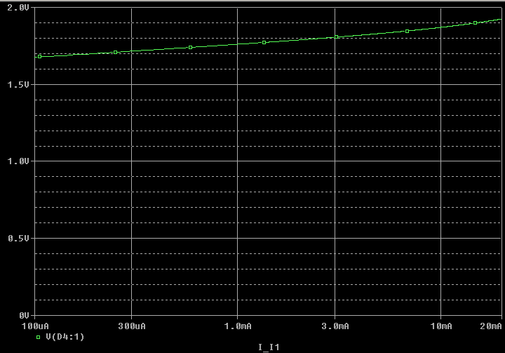

Junction diodes in general do not "shut down". A plain Si diode conducts at 0.5V, 0.4V, exponentially over many decades of current.
In contrast vacuum tubes are not useful over more than a couple decades of current; and for low THD we normally run them over much-much less than a decade of current. Typically a 3:1 swing will make 5% THD. In the same 3:1 swing the LED(s) will vary around 0.052V, which is "nothing" compared to the several volts static bias.
This is what an LED looks like over the range of currents we might use in small tubes:
Here is 12AX7 biased with LED, resistor, and battery (equivalent to a big cap across a resistor). Grid swung +/-2V. Plate and cathode voltages plotted (cathode Vs multiplied by 100 so they show on same scale).
The unbypassed resistor is by far the most linear, but at half the gain of the others.
The LED and the battery (or BFC) lay so close together I can hardly read a difference. The LED bias is a hair down on gain but much less than tube-to-tube variation. Given normally steady supply voltage, there's little to choose.
For extreme variation of B+, the LED (or battery) amounts to fixed bias and will "amplify" supply variation and throw the idle plate voltage into the weeds. Resistor (with or without cap) will self-balance to the change of supply. A 90V-500V change of B+ is ugly at the ends. Normal (wall-power) 280V-330V change is no real difference.
