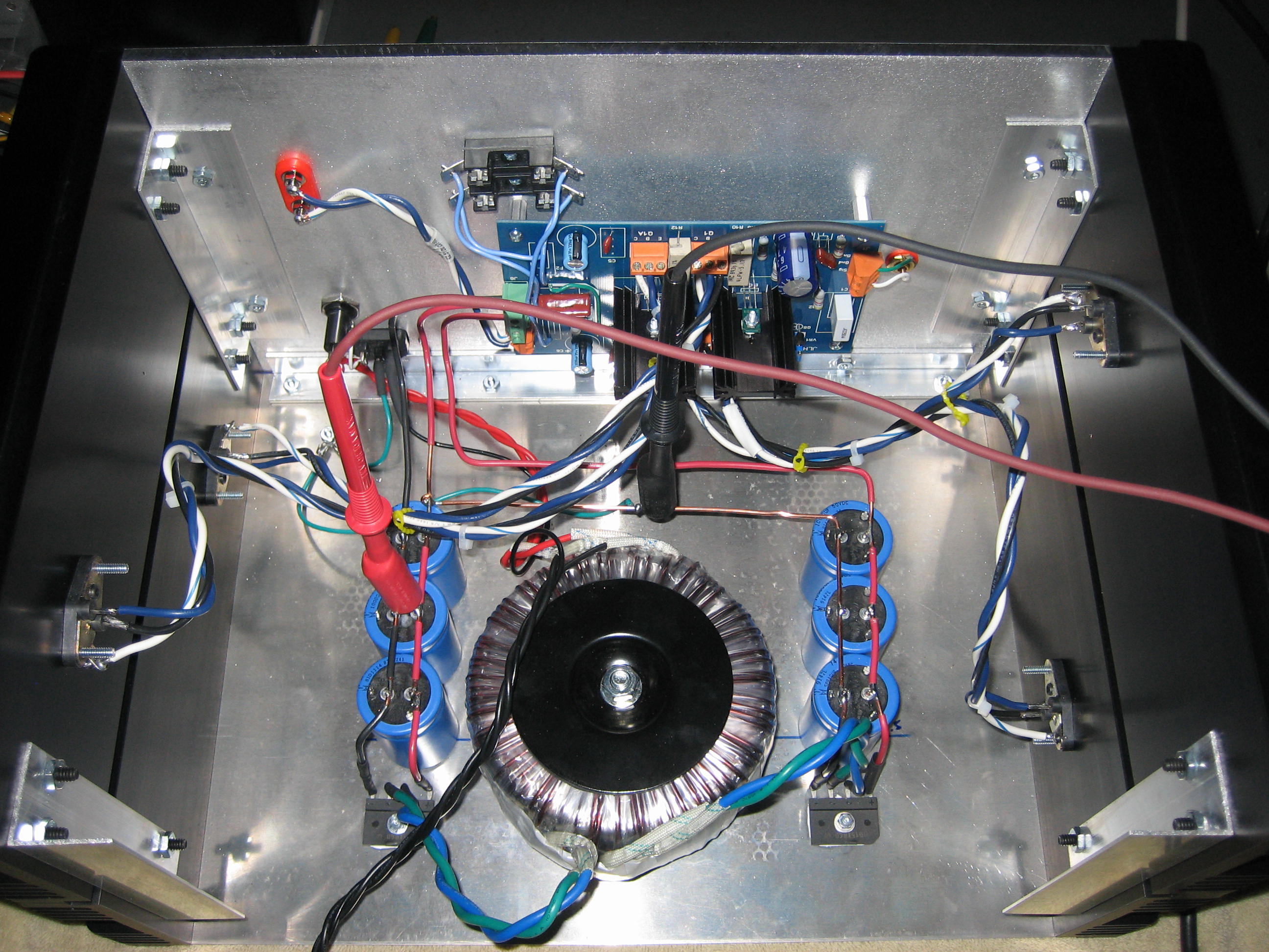

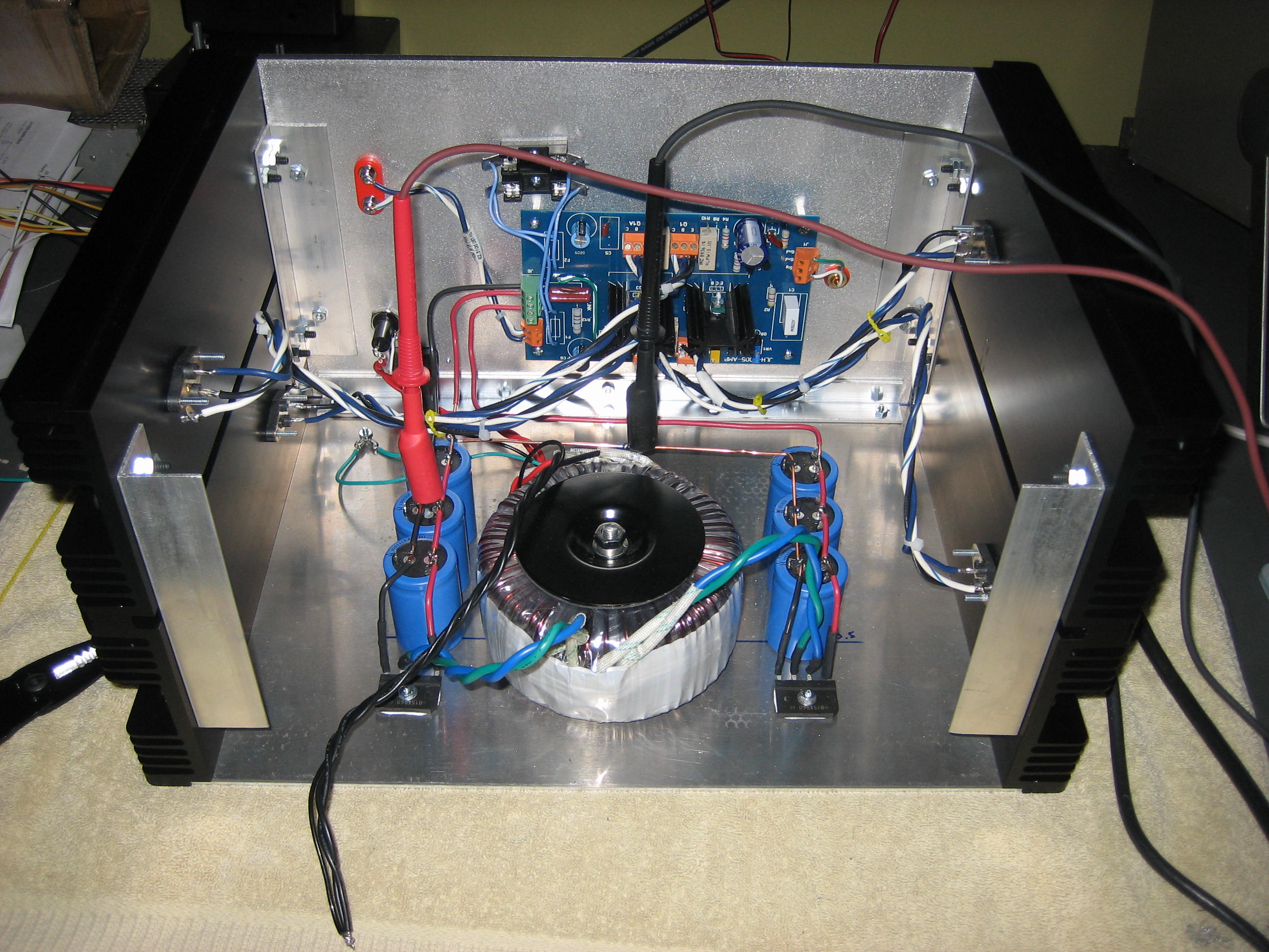

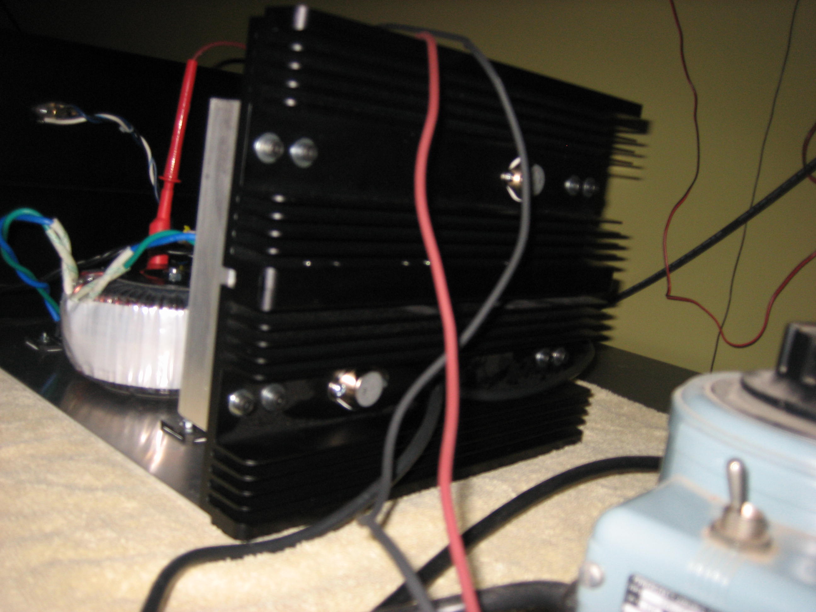

My sinks are 11.5" X 4.5" X 1.25" tall fins on a 3/8" base. There are two of these per side, so the end result is 11.5" X 9" X approximately 1.5" Here are a few snapshot of the amp coming along. I think it looks pretty nice. The top plates are perforated aluminum, and the rear plates are .25" 6061 aluminum. I'm still trying to find the optimal front cover.
Blair

OK,
Forgive my SS ignorance, but in order to bias this amp to anywhere near my understanding of biasing, the little Kermet pot is getting pretty hot.
I am clipping my meter to one side of the .1ohm resistor and the other side to get the voltage drop. Is this correct? I can only get to .02v before the pot is really hot! Any ideas?
Thank you!
Blair
that is strange the pot is hot ? that level represent 0.2 A bias.
one thing to watch is the length of those wires to the output transistors... probably wont be a massive issue but it helps to keep them as short as possible.
(although i myself have done the same thing albeit 5 cm long wires)
is the pot you are adjusting dc offset or bias ? I woudl not expect the pot to get hot
-Dan
i only ask becaue sometimes with biasing nothing happens until a point and then it biases quite quikly, my suggestion would be wind it up slowly until you see a change if it does not work you need to re-check your resistor values, transistorsplacements etc.
is the supply voltage ok ?
Well,
At this point it does not matter much. I put a flashlight on the pot, and it melted the casing and looks pretty cooked internally. It is one of those with epoxy so it was easy to see.
I have solid +/-23.8v rails. I put a signal on it with a cheap speaker despite the DC offset, and it makes aound, but not much. I really chose the wrong monoblock to try first. The other one has the board flipped and it is much easier to get to the pots.
Here is a good question for you. How long does it usually take for the transistors to get warm? When I first fired it up, it was one for five minutes or so, and they were still cool. I'm assuming that is not right.
Blair
That is not right.
normally ay a 25 degree C ambient temp
the transistor cases (circular metal cap in your case on T-03 packages)
will become hot to the touch in about minute regardless of heatsink size.
I would check the rest of the circuit - compenet in the right way round, resistor values, solder joints etc.
Hope this helps
-Dan

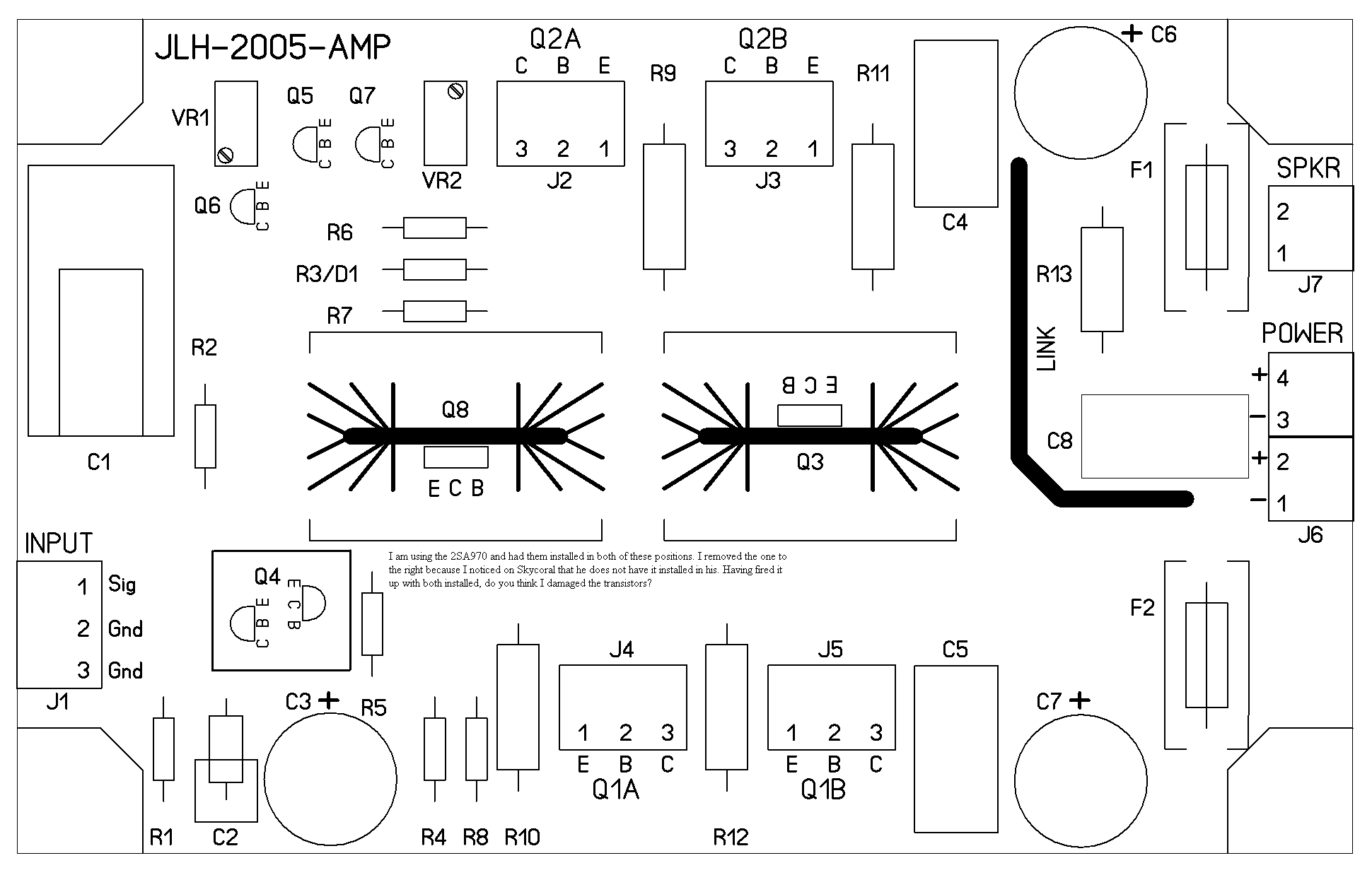

OK,
The first thing I noticed looking at Geoff's boards is that for Q4, he only has one installed. I pulled the one he has missing out of the circuit and fired it back up. I have essentially no emmitter voltage on Q2 and Q2A despite having about 12.2v on the base. Any ideas? Do you think I cooked a 2SA970 because I had both installed?
Blair
Here is an explanation and a view of the board. Why is there two positions for Q4? I see the pinout is different, so I assume it is to allow for different transistors? It appears you cannot read my writing on the image, but it says that I pulled the one to the right in the square, and am asking if you think I damaged the one to the left in doing this. Also, is this the reason for my not being able to adjust the DC offset since it appears that I have nothing on my emmitters of Q2 and Q2A?
Thanks for everyone's assistance. I'll leave you guys alone until I find a new project😉
Blair

OK,
Not really a stroke of genious, but rather an observation. Looking at the JLH site, I see that Q5-7 are recommended to be 2SA970s, but the pinout on the board is different than the 2SA970. Does anyone know what transistor the pinout is for? I suppose I could install the 2SA970 backwards and reverse the C and B pins, but obviously the board was made for a different transistor.
Anyone know what the pinout fits?
Thank you!
Blair
I would follow the pin out on the board - regardless of which device you use make sure the emitter pin goes in to the 'e' pcb hole etc.
oh, I see the problem, the pcb shows two different pin outs for one device.
Ok now I get it, two pin outs provided to allow for two different device, but only 1 is to be installed. I can't for the life of me understand why anybody would design a pcb like that. Now I'm confused.
Now I get it again, the pcb is trying to cater for a choice of devices - it's trying to be helpful.
so good that you took one of them out - you only really need 1 device in there.
sorry I didn't add any value here ...
No problem. You are spot on with your comments. It is verifying that I'm not nuts!
I just hope that I did not clip off the leads on my 2SA970s too short for this reroute, and that I did not damage any of them. They were the only part I had to order! 😡
The funny thing is that the recipe calls for 2SA970s, but the board is not laid out for them. I need to turn them around and flip B&C to get them to work.
Thanks!
Blair

Hey Paul,
Looking through the link you sent, I can confirm from looking at your boards that they are the same layout. What did you use for Q5-Q6? The 2Sa970 does not use this pinout.
Thank you!
Blair
