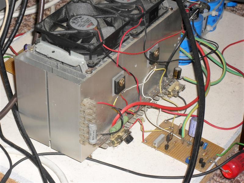

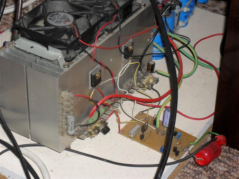

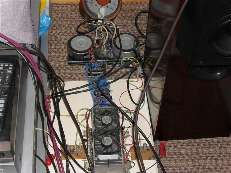

Thought some of you may be interested to see my interpretation of the JLH amp.... It's in use nearly all day everyday and has given no trouble (yet...). It sounds superb and is used in preference to a gain clone, MF A370, rebuilt and modernized Leak Stereo 20 valve amp and various other contenders.
It gives approx 25W RMS per channel into 8R but is currently in use with my 4R KEF speakers so more like 12W in this application. The speakers are 93dB/W though so no problem volume wise!

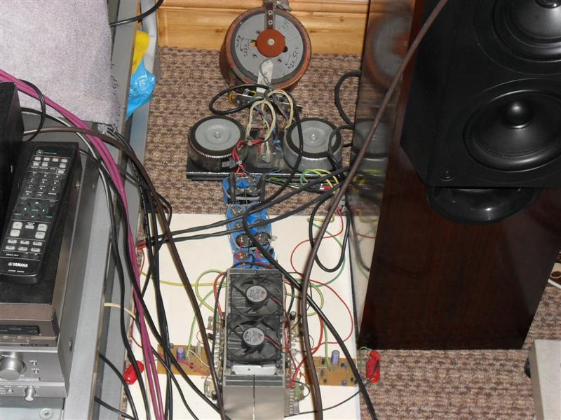

It's a large beast of an amp, about 4' from the variac to the end of the heatsink! Those caps are 14 x 22000uF....
The heatsink stands on spacers giving about 1/2 inch gap around the bottom, the twin fans suck air up and expel upwards.
Looks Awesome!! What transistors are those?
I take it you do not have small children or pets😉

Those photos are making my fingers itch to build again. I'm gonna have to build one myself too. Probably a more recent incarnation of the JLH but still a JLH. It's gonna be my winter project. I'll use left over parts so I'll be limited in power by the transformers & heatsinks I have to around 6W into 8R, but a good starting point nonetheless !!
Thanks for the erm... positive feedback guys.... Ill try not to oscillate!
The design used is the updated, direct coupled one by Geoff Moss/Tim Andrew from The Class-A Amplifier Site - JLH Class-A Update
There are a few changes of my own to transistor types, mainly because the ones I used seemed to offer good as or better specs than the ones in the schematic but mainly 'cos I had them to hand!
I used the "fig 1 The penultimate circuit" but there may have been some further small changes made.... it's a few years since I built it so can't remember every tiny detail!
The transistors I used are as follows:
Q1,2 = 2SC2987
Q3 = 2SD863
Q4 = BC560C
Q5,6,7 = 2SA844
Q8 = 2SB527
Feedback capacitor is a 470uF Oscon and input cap 2uF mill.spec GEC polypropylene (dont ask 😉 )
I have not tried the "no feedback cap version" but I see I fitted it to pins on the perf board to allow it to be easily tried...
Each transformer has its own 35A bridge, transformers and bridges are mounted to a piece of alloy.
After the first 4x 22000uF caps, there are 0.33R 11W wirewounds which form an rc filter (turnover point 4.3Hz) in conjunction with the remaining caps and remove any annoying residual noise on the psu.
Q1,2 = 2SC2987
Q3 = 2SD863
Q4 = BC560C
Q5,6,7 = 2SA844
Q8 = 2SB527
Oh yeh.... The variac!
The toroids I had to hand (about 400VA each) would have given excessively high rail voltages from the 240V AC mains input so I used a variac....
This also allows the power output to be optimised for different impedance speakers, I.E. wind up the supply voltage and back off the quiescent current for higher impedance loads and vice-versa for lower impedance loads.
As noted earlier though I never actually bothered to reset it for my 4R KEF's because it went loud enough already so I thought "leave well alone"

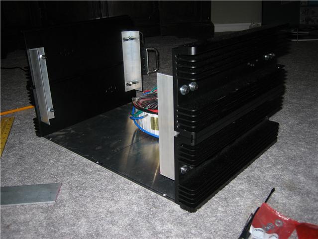

Here is a little progress on my amps build. It is taking forever since I now have a 10 month old son to entertain most of the day!
I still have one panel to drill and two IEC holes to cut and file. 1/4" aluminum, so it should be a pain in the rear! I have the PS filter caps, etc. They will mount on either side of the power tranny. The front panels are going to be solid wood with 50W Class A laser etched in them. Should look pretty sweet!!

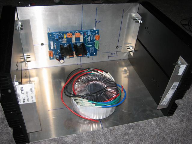

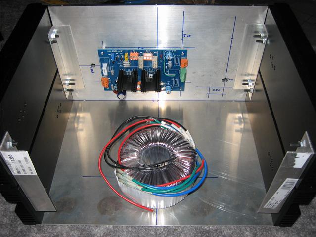

OK guys,
Now comes the part where all of you fall out of your chair laughing! I finished, or at least close enough one monoblock today. It looks very nice. I pulled the rail fuses from my PCB, and slowly brought up my rails on a variac. +/-26.2v. Good deal!
Now for the joke. I have never built a SS amp before. All tube gear. How do I adjust VR1 and VR2 for the proper current? Here is the link to the board I used.
Thank you if anyone can explain this to me!
