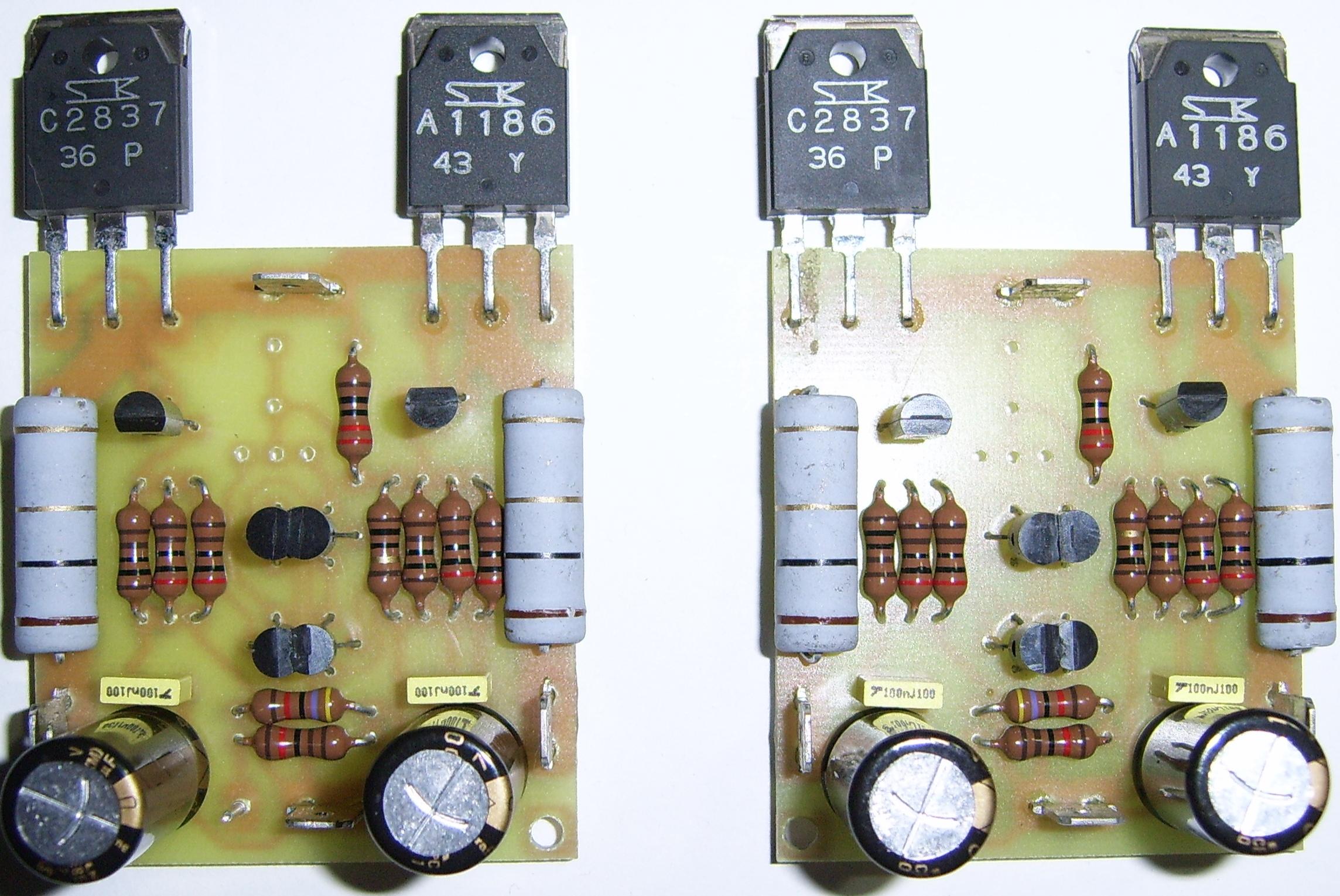

Hi All,
Just saw this thread,
A few things i would like to mention:
the original Le monstre is ~7-8W.
the original Le class A is around ~20-30W depending on supply.
the class A i built (in my avatar is ~50-60W)
the JLH 1996 version is ~15-30W depending on supply.
the original JLH "simple class A amplifier" is ~15W
I would suggest reading here for Hiraga and JLH schematics:
http://www.tcaas.btinternet.co.uk/
The PCB's for JLH 1996 version (the good one which is not cap coupled)
are available here: http://www.williamshart.com/
Happy building
-Dan

Hello Daniel,
Thank you for chiming in. I am unfamiliar with all the variations and that is why I think there are a few posts regarding my wattage figures. The high powered class A JLH I am considering on 23v rails makes 28w into 8 ohms and 56w into 4 ohms.
I'm glad you responded because your amplifier is what got this whole thing started for me. I like your design and was planning on building it instead, but I ended up getting a really good deal on heatsinks pretapped for TO-3 transistors.
Most of my speakers are relatively difficult loads to drive. Some of them dipping to two ohms at certain frequencies. I'd say 3-4 ohm nom. Impedance. This is why the high power JLH seemed attractive. I figured even if I have to place small fans on the Heatsinks, they should be OK with the tough load.
Can your amplifier in your avatar drive 4 ohm loads without going into magma level heat mode? If so, then is there a T0-3 transistor that could replace the 2SC5200 transistor compliment and still make around the same power levels?
Thank you for any input!
Blair

Hello Daniel,
I have built a JLH with just the 3055 out put stage (one per rail) and it got ~30W with 22V rails (regulated monoblock supplies) based on the williams hart kit. they sounded great but i have since sold them. the 1996 JLH is a great amplifier.
thankyou and nice work on the heatsink buy.
Class A amps that operate solely in class A tend to heat up to a certain level and stabilise there hence i dont really for see a major problem driving 4 ohm loads with the hiraga or the JLH for that matter as long as your chosen output stage is up to the job - however i am currently using 8 ohm nominal speakers. (elsinores)
On the T03 side of things... There are quite alot of T03 transistors which will replace the 2SC5200/2SA1943 pair many with much higher power rating ie 200-250W, however the HF performance may not be quite as good - usually the Cob is higher due to the larger chip area to achieve the higher power rating.. like everything it is a trade off..... perhaps try MJ15024, MJL21194 style transistors.. i would suggest you may only need one pair using these.
also MJ15003 /M15003 are cheap but the Ft is not to special 🙂
Thank you for any input! - any time - i just stumbled across this thread - as i just started building my second Hiraga "Le monstre" see the PCB pic below 🙂
-Dan

Excellent,
This is all good information. I'm leaning towards the parallel output JLH because I have that many heatsinks, and it will help with heat dissipation to have one TO-3 per sink.
I'm not a power hog or anything, but having a little overhead will not hurt. According to the JLH high powered desigh voltage/power dissipation chart, 25v regulated rails will get around 42w into 4 and 8 ohms. As I said earlier, my speakers tend to be on the lower side in regards to impedance, so I am thinking about using the lower voltage rails to get a bit more power into the 4 ohm region.
I am planning to use the MJ15003 (2 per rail), and hope this works out well. I'm etching my boards sometime this week. I may give up and buy boards, but I'm trying etching for the first time. Should be fun!
Thanks again for the information!
Blair
