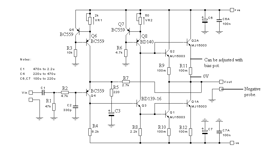

OK,
I think I'm getting these right finally. I changed all the transistors and purchased a few new power transistors. I started small this time. I only connected one pair of output devices. This time I could adjust my DC offset to zero. Here is my question about biasing. If you look at my attachment, here is what I have done. I Left my black meter probe on the negative speaker terminal since it connects to my zero volt point. I hit R11 on the other side and adjusted it to .2v, then back to my DC offset and adjusted to zero, then back to the R11...etc.... Here is one question, on R12, I see voltage on either side well above .2v. Is this normal?
Second, if I have .2v, then I am biasing at 2A right? .2v/.1ohm = 2A quiescent.
Am I on the right track here?
Thank you!
Blair

An interesting circuit with less changes than Geoff's one is posted in Nelson Pass PLH pdf, in fig 4 and 5. Basically the 69 version with parallel output transistors, and dc coupled.
The differential input that Nelson proposes is also a good idea, IMO.
