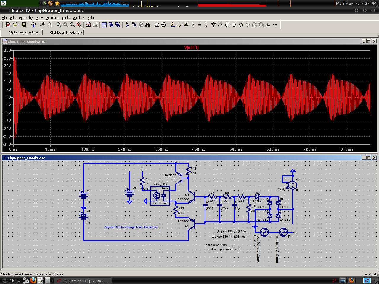

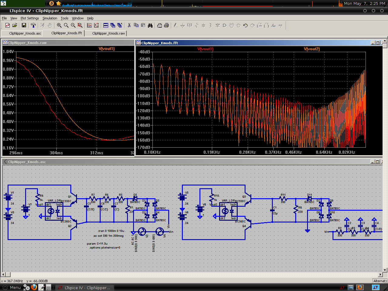

Wait, I didn't do that simulation right, try this one. I didn't equalize the levels...
Harmonics are higher before 650Hz, but this is because of the improved speed of the LP filter at low frequencies. The 1KHz intermodulation is lowered considerably with the better LP, which is the point. Better speed, as well as better filtering.

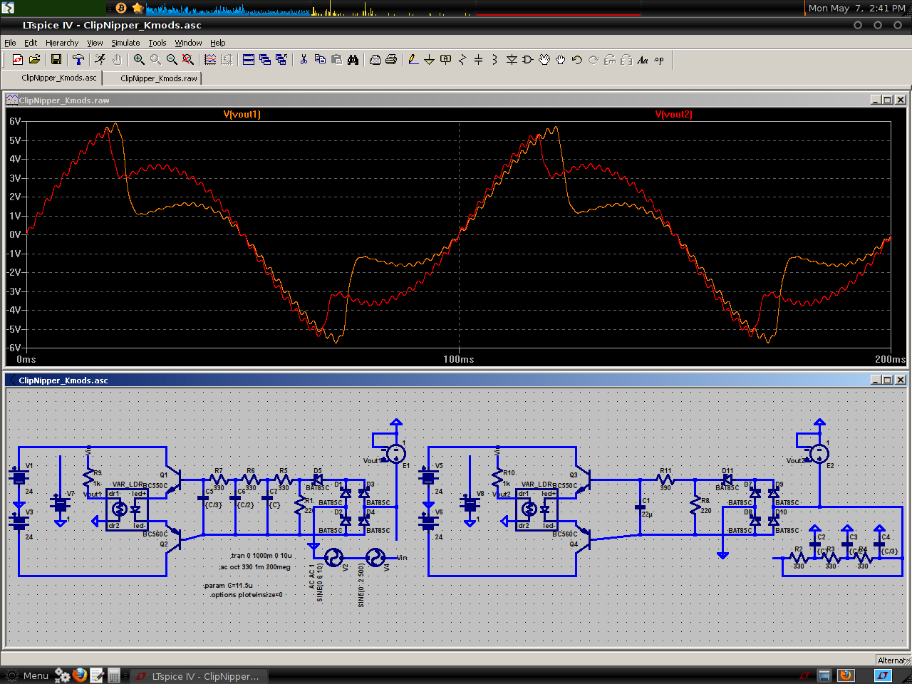

Arg, I keep contradicting myself. Let's see if I can get it right... Or if I'm even right at all...
You're right, of course. I might be right too. Of course, Eva is right as well. It just depends on what frequencies you'd like to limit primarily.

Well, there are some reasons a better LP filter will help, others it may hinder. Because of the nonlinear nature of the LDR, gain increases dramatically with input which is why it will motorboat if too high input is given. For this reason I switched to current-drive mode.
This new schematic allows for the use of much smaller film caps for the filtering, and is in many ways better. Thoughts:
I suppose you want immediate suppression of spontaneous transients, rather than a lingering drop in gain after a transient. The "lingering" is adjusted with R1. It could even be a knob.
R12 controls the threshold, it could be a knob too. I haven't looked into how I should reconcile the two redundant threshold controls, R12 and D5. Maybe delete D5? But then Q5's tempco would affect the threshold quite a bit.
The current drive buffer is convenient in that it allows us to shape the filtering without anomalous effects from the LED impedance. We can also use small film caps, so the circuit is more reliable.
This is how it operates at 2x overload, adjusted for 13V threshold.

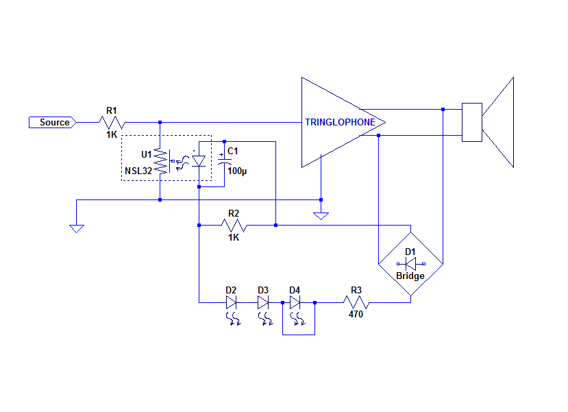

I tested the Clipnipper on a Tringlophone with the components kindly provided by Daniel.
Results
In mode "A" only (no comparison), the thing seems to work transparently, with no apparent distortion, pumping, or any other noticeable artefact.
However, in A/B mode (with/without), the sound is clearly duller with, in particular the attacks, that it seems to kill, or at least to blunt seriously (test was done with rock music).
After some trial and errors, I ended up with the version shown below: the capacitor across the coupler has been increased to 100µ, and a discharge resistor has been added to somewhat help the recovery and delay the onset of AGC action.
To compensate for the threshold, one of the LEDs has been shorted
On a purely technical level, I noticed that the I/V function of these couplers is non-linear; even the residual dark resistance is "S" shaped, which must introduce distortion. However, my tin ears failed to detect any distortion (not a surprise).

I'm sorry that I forgot to mention that the original works with level tone only if you allow some of the amplifier's natural clipping pattern. However, the TV amp that I'm working on right now (for my mother) needs the AGC version you just posted. Thanks again!!
P.S.
The shorted D4. . . it might be interesting to replace that short with a small rectifier schottky(s) or a fast silicon diode(s) or 1n4007(s). Possibly that could add some more pretty/transparent flex usable for a touch more headroom. Any diodes with highly current reliant knee voltage can be used for trim--they don't actually have to be LED's. 🙂
P.P.S.
It could be interesting to put a 1k variable resistor in series with the light dependent resistor, so that the resistance can be fine tuned and "relaxed" as needed to preserve dynamics. LDR's vary a lot. Maybe the LDR that I sent was overly effective.
