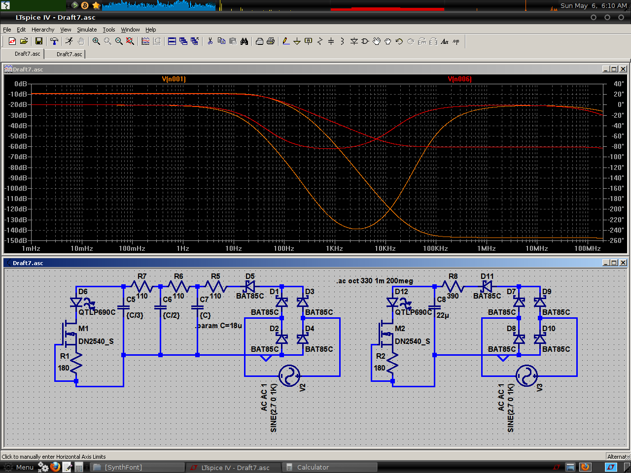

Try using a 2nd-order LP filter before the LED, or even third-order. This way, the high internal resistance of the 22uF lytic won't cause significant signal coupling to the LED, adding distortion to the signal, and filtering will be much more effective. If a transistor were used to drive the LED, smaller film caps could be used, though larger low-ESR lytics might work just as well considering there is no shortage of drive from the rectifier and amp output.

Those LDR's aren't too slow, 250uS will still pass 1KHz. I think you should still listen to it with a high-order LP filter just to see. Take a few diodes out so it's operating constantly and tune it. The better LP filter allows you to raise the limit corner frequency without applying more limiting to higher frequencies. Thus you get less crunch, but better effective speed.

Here is an example. The DN2540 with 1W dissipation seems adequate, with a limit current of 10mA. The added 180R in series with the LED also stabilizes the LP corner. Read trace is LED voltage for the original version, orange is for the triple-LP version.
Checking to see if I understood:
Replace the original 390R, 22u with:
120R, 22u; 120R 10u; 120R, 4.7u; pretty much as shown on your schematic?
This looks like you can use more capacitance (typically makes treble better, bass worse) without making the bass worse?
Could manufacture these near miss cap values:
10u//4.7u, 4.7u//2.2u, 2.2u//1u
14.7u, 6.9u, 3.2u
Would that be better?

I just chose the rectifiers from my SPICE list, that one came from Cordell. As I recall, Schottkeys have lower breakover, but are less abrupt and have higher impedance at high currents. So I think silicon diodes are the best option for limiters. In an input limiter it is also important not to oversize diodes because the nonlinear capacitance can cause distortion depending on your source impedance. For the limiter rectifier though it shouldn't matter much.
The values of the caps aren't very important, just keep the general relationship. Actually I'm not sure if the value stepping matters here but I'm sure there is some economy to it. My reasoning is that C6 actually has 220R source resistance at LF, so it only needs to be half value. C5 has 330R, so 1/3 etc.

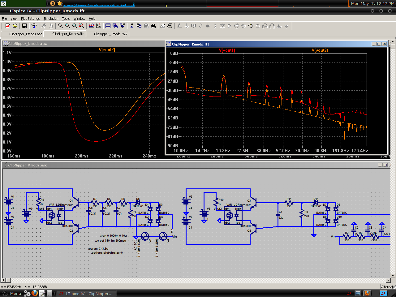

Maybe we should consider the way we drive the LED. Depending on whether we use voltage or current drive, the LDR transfer curve will be some sort of log thing. Looking at this datasheet, it appears we want voltage drive, for logarithmic LED current, which will give logarithmic resistance, acting as a logarithmic volume limiter, which is what we need for audio.

In this case a BJT buffer for the LED might be desirable so a series resistor is not needed to stabilize the LP corner. But then how to add current limit?

The best approach is to use a micro-controller to evaluate input/output signals and set the amount of gain reduction dynamically. Electrically it's quite simple to implement: Just a PIC sensing input signal, output signal and rail voltage, and driving the LDR with PWM. Programming-wise finding good limiter control algorithms capable to adapt themselves to the signal being played is a little challenge.
Another schematic. This illustrates the benefits of a high-order LP filter. High order harmonics are much lower. This is the result of an input voltage that is a combination of 500Hz and 490Hz, which produces a sine wave modulated at 10Hz, perfect for exploring limiter behavior.
