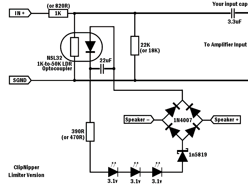

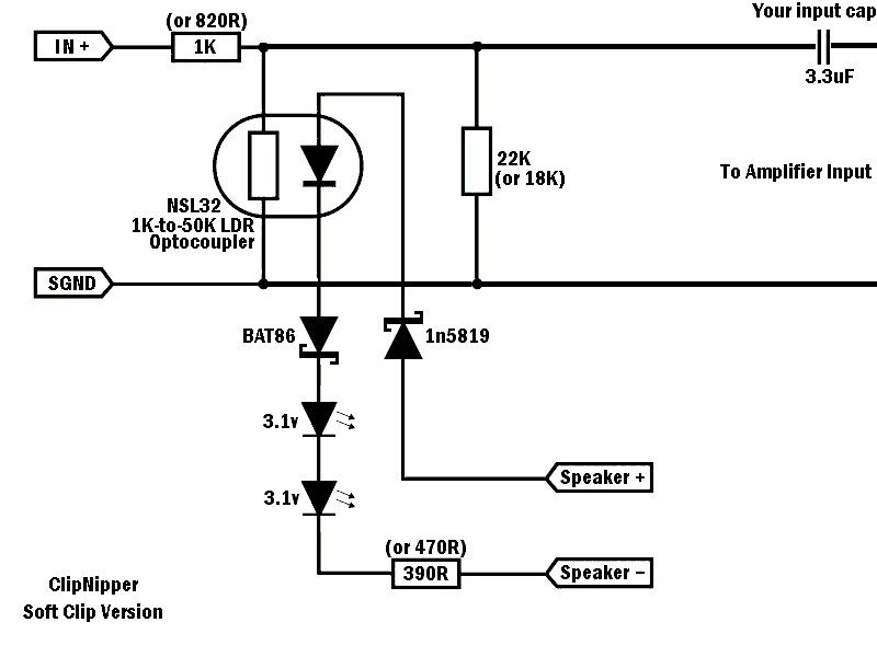

Turn my soft clipper limiter into a regular limiter? Okay.
Input Control:
1k input loss (more than that will make bad limiter pulsing noise)
22k input load parallel with the LDR's onboard CDS
During clipping this is a "more than half" voltage divider.
Substitutes:
820R input loss will decrease limiter pulsing noises and that is also acceptable for the soft clipper limiter at post 1.
Speaker output Sensor:
1N4007 Full Wave bridge rectifier.
Sensor is these (components in series just like LED's in series):
5.6v Zener, 3.1v LED, 470 ohm resistor, LDR's LED, 1n914
A 22uF cap is parallel to just the LDR's onboard LED.
Substitutes:
If 3.1v led and/or 5.6v zener aren't handy, you can substitute an equivalent amount of LEDs, Zeners or ordinary diodes that add up to the desired voltage drop(s).
Advantages of this version: Better quality treble. More protective. It doesn't "miss" You are correct.
Disadvantages of this version: Somewhat less bass, and it "sounds like a limiter" as in less transparent.
The disadvantages were expected, but I minimized them.
Advantages of both versions: A noise reducer that is powered only by noise. No added standby consumption. BlareBuster compatible. You can play a tiny amplifier louder than heck without clipping noise.

Okay I re-did the Full Wave type sensor for a bit louder bass.
Full wave bridge rectifier at speaker jack running:
1n5819, 3.1v LED, 3.1v LED, 3.1v LED, 390 Ohm resistor, LDR's LED
22uF cap paralleled directly to only the LDR's LED.
The ~3.1v led are InGan White or warm white LED that stumble across their knee voltage (better bass than the fast attack of zener). You'll get quite the light show. The resistor drain can be 390R to 470R. You can add more or less 1n5819 (schottky) to fine tune.

Thank you for the schematic. I have revised it. See the attachments.
Input:
We need an input load resistor because the 1k to 50k LDR optocoupler could (varies) go nearly open circuit when off.
Sensor:
We need to set the sensor's voltage range suited to TA2020, TA2024,
We need to do without a ground tap for sensor (bridge amp doesn't have an output ground),
We need to set the sensor so that the amplifier plays louder and still clean (unusual for a limiter)
Noises:
We need to reduce the effectiveness of the limiter enough to remove obvious pulsing noises,
We need to reduce the effectiveness of the limiter enough so that we don't require high gain/preamplifier noise.
Frequency Response:
We need to use LED and Schottky voltage drops because their sloppy knee voltage region will make a more transparent rendering and LOUDER BASS than abrupt zener.
Please check the attached schematics for polarity. I did test these actual components with the real amp. A 3.1v LED is an ordinary white or warmwhite LED ("on" voltage varies by current). You can fine tune voltage drop to match your amp by either subtracting 1 schottky diode or adding more schottky/fast silicon diodes.
