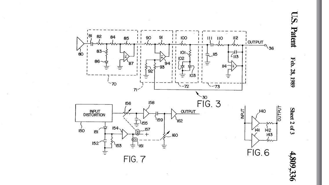

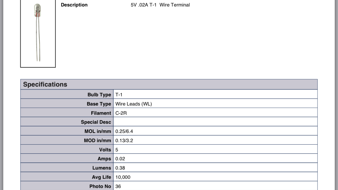

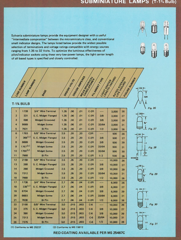

yes i'm working on this again, the best soft clip/limiter so far i see is the incadesent bulb network. Bulbs are getting hard to find, and selections are narrow.
I still think a combination of both fast H11F1 opto and bulb will cure the issue.
We'll see, I'm doing a hybrid with TPA3118 PBTL output and need to implement a line level limiter.
some bulbs.:crazy:

I would forget the VACTROLs , they are too slow. I'm doing the bulb first ( w/thermal speed-up) , then if necessary include the fast opto. The linear optos are cheap now and available.
The bulb also has a known 'release' time if thermals are managed.
