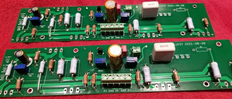

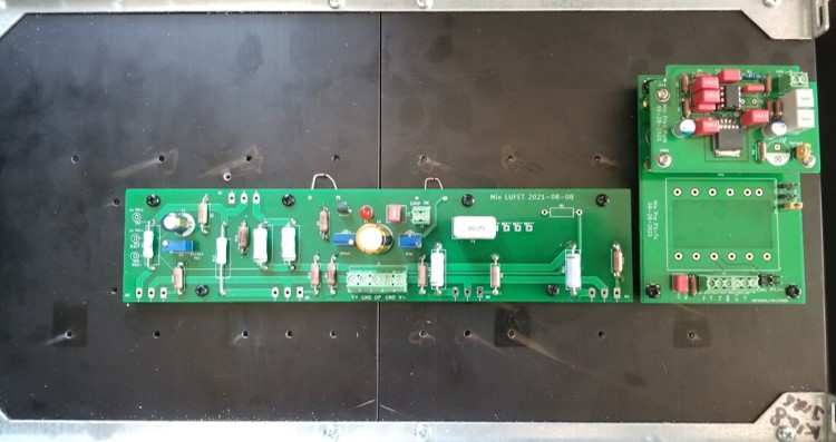

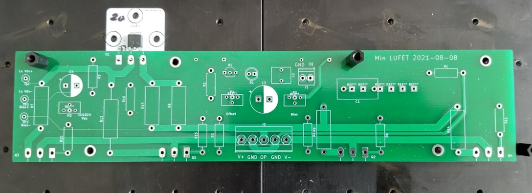

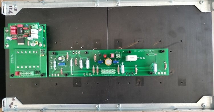

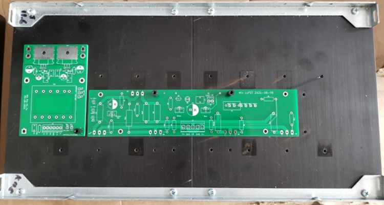

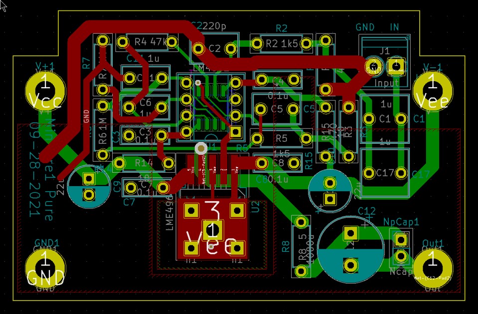

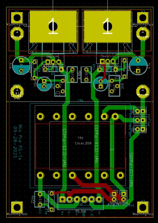

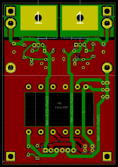

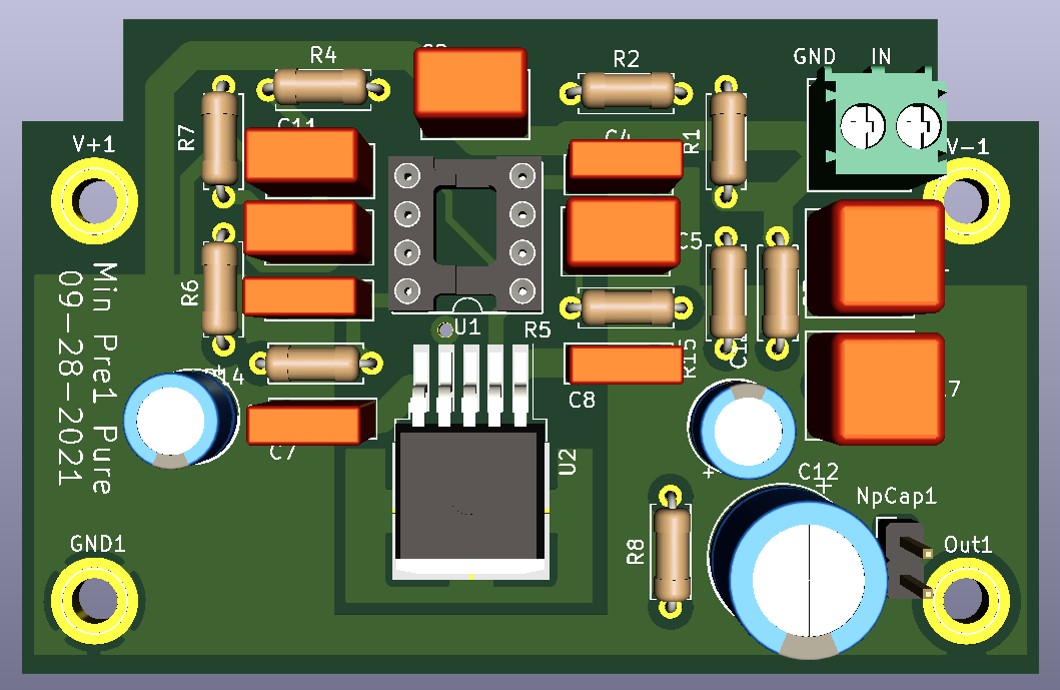

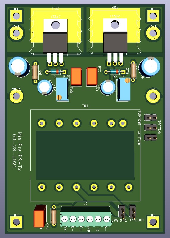

voltage amplifying board + Base board configure
Like M2's and V-Fet input stage (Mark's design), the Lufet driving stage is divided into two boards: the base board, on which the line regulators and the transformer are mounted; the amp board, the op and headphone amp are soldered.
Jumpers are put in for convenient modes: high gain, low gain, IC direct output(no transformer), auto-transformer and normal transformer.

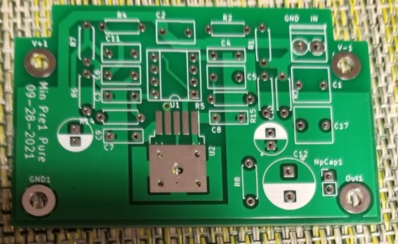

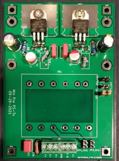

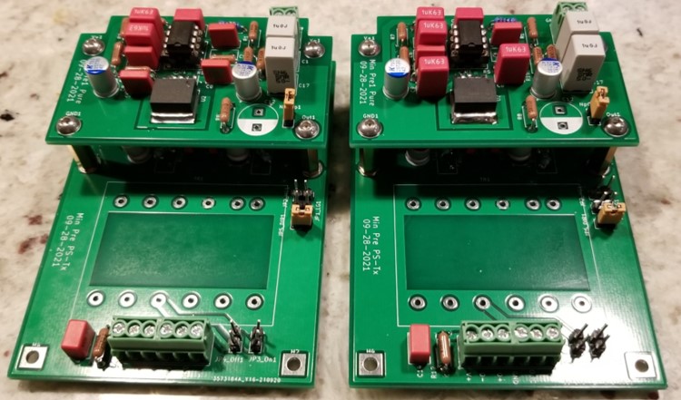

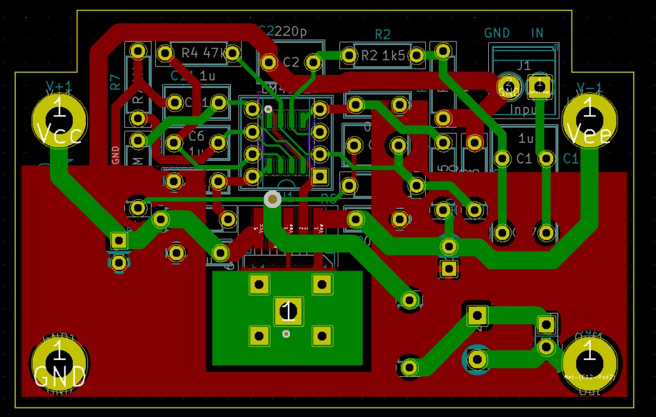

the daughter board
Use 4 mounting holes on the board as V+, V-, GND and Output. It can be easily connected to the base board.
In the future, different daughter board can be designed and tested based on personal tastes.

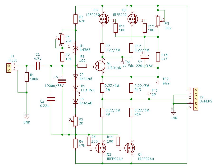

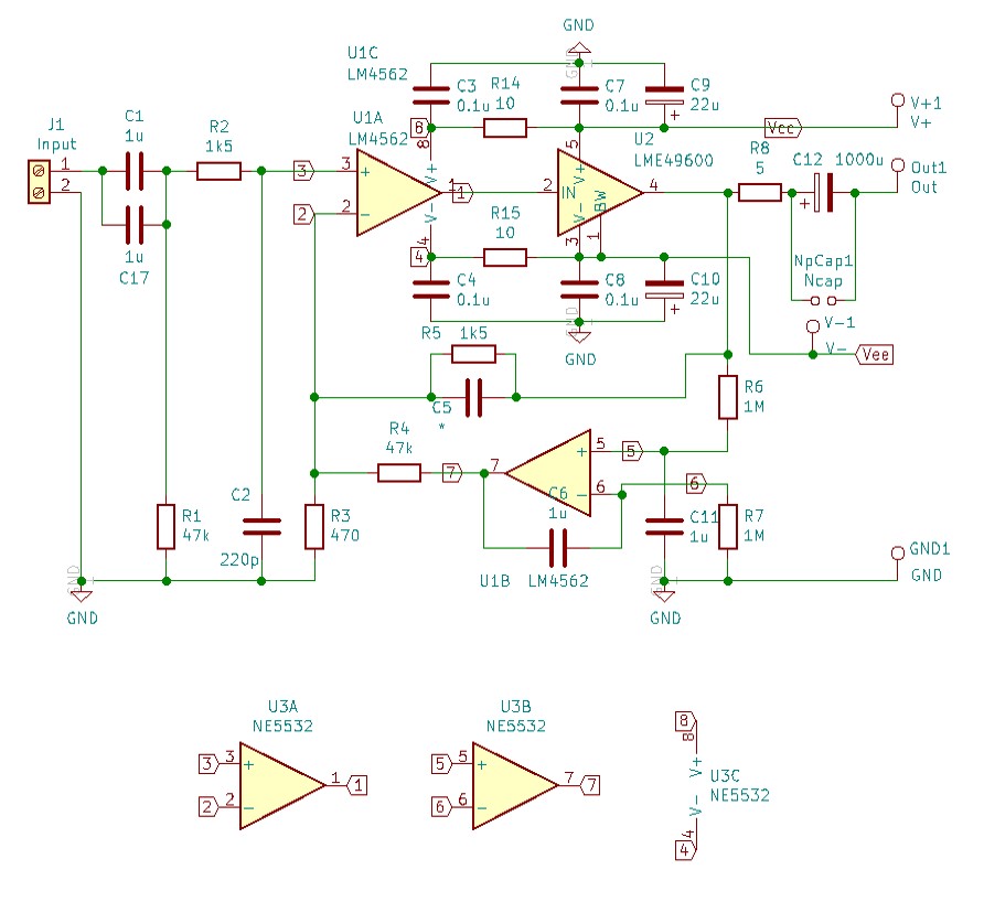

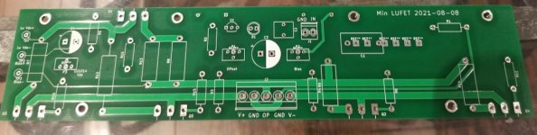

But the bias circuit is simplified.
LM385 is used as offset adjustment and the voltage shifter. The voltage should be Abs(vg1+Vg2).
To reduce the stress on MosFet, two mosfets are parallel.
PS: Wrong symbol for IRFP9240. (P-Channel)

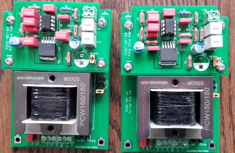

Soldering

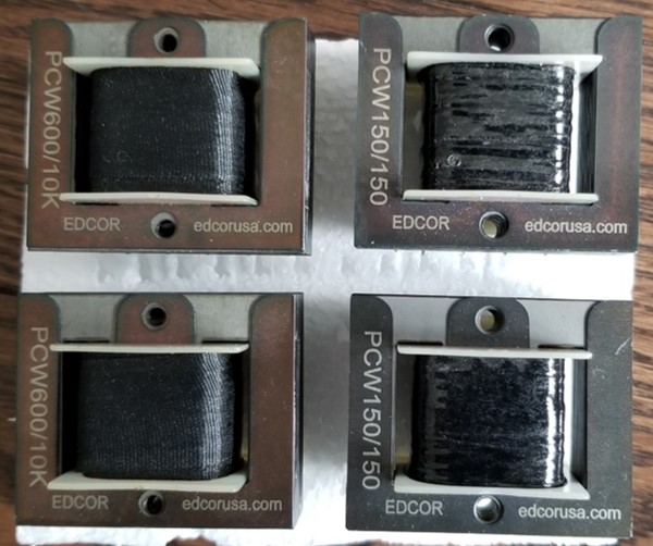

Finally, all components have been received. Specially, Edcor transformers are here. The order was put on July 14. It took a long while.
The Edcor transformer ordered for the voltage stage is PCW Series - 1/2W balanced 150:150.
The 600:10K ones are for other job.

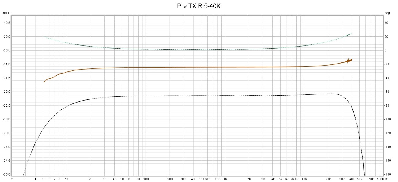

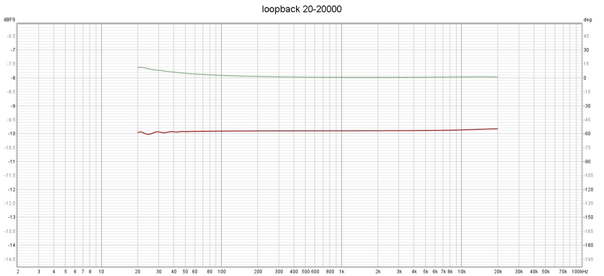

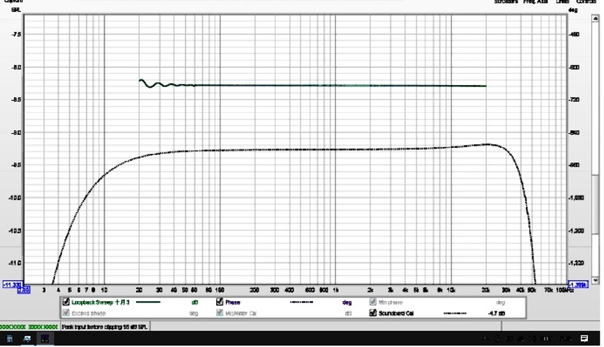

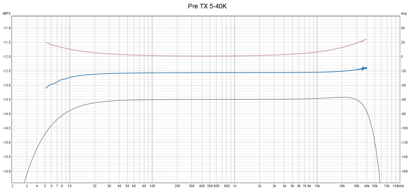

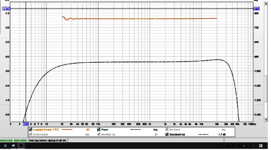

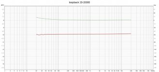

Frequency Response of the voltage stage without transformer
Using Focus rite scarlett solo USB and REW.
L and R channel 20-20K Hz +/- 0.1db, very good, measured with 150 ohms load.

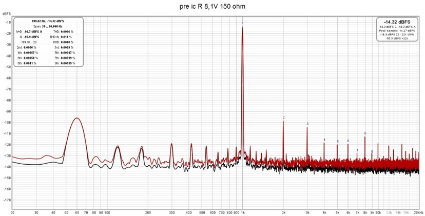

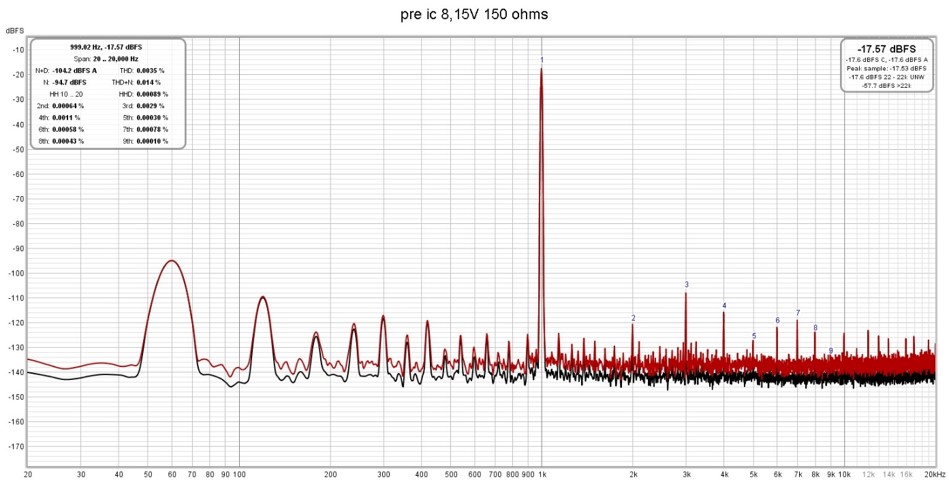

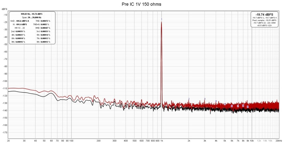

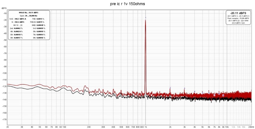

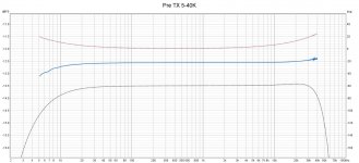

THD+N
It is expected. The voltage stage with audio IC and buffer will have excellent number.
the purpose of the test is just to confirm flawless PCB design and components layout.
L channel at 150 ohms load, THD+N 0.00075% at 1Vrms, 0.0035% at 8.15Vrms output, DC offset 5.5mV.
R channel at 150 ohms load, THD+N 0.0011% at 1Vrms, 0.0066% at 8.1Vrms output, DC offset 6.5mV.
Corrected number:
L channel at 150 ohms load, THD+N 0.0083% at 1Vrms, 0.014% at 8.15Vrms output, DC offset 5.5mV.
R channel at 150 ohms load, THD+N 0.0079% at 1Vrms, 0.011% at 8.1Vrms output, DC offset 6.5mV.

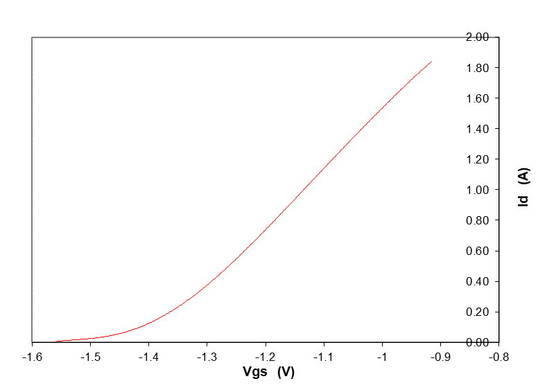

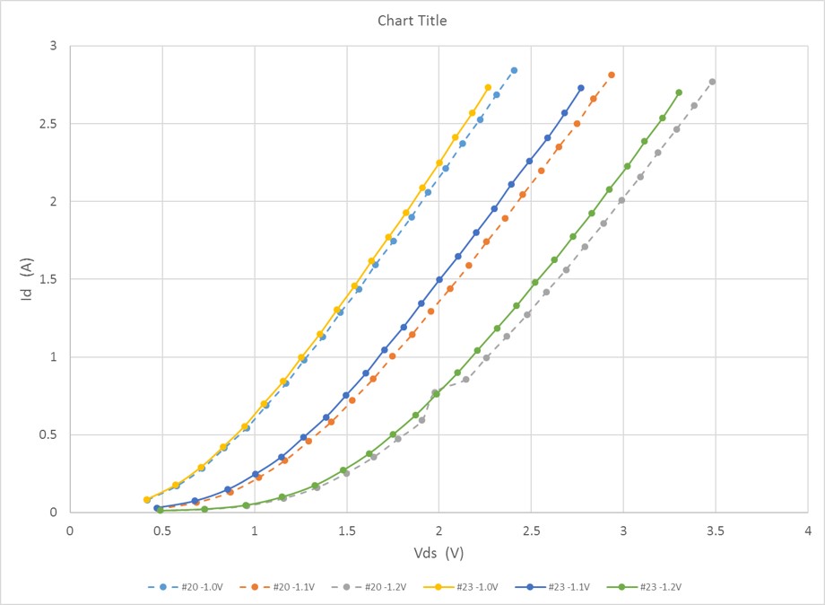

- LD1014D Id-Vds-Vgs Curve
