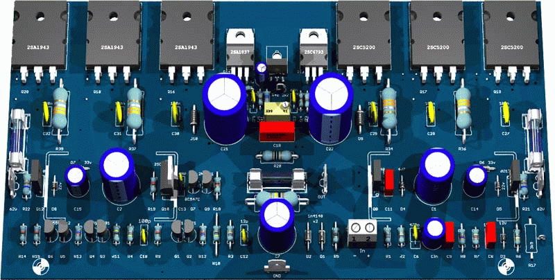

I am very proud.... very proud of my nephew, proud to present you the final Dx Precision I (One) board.

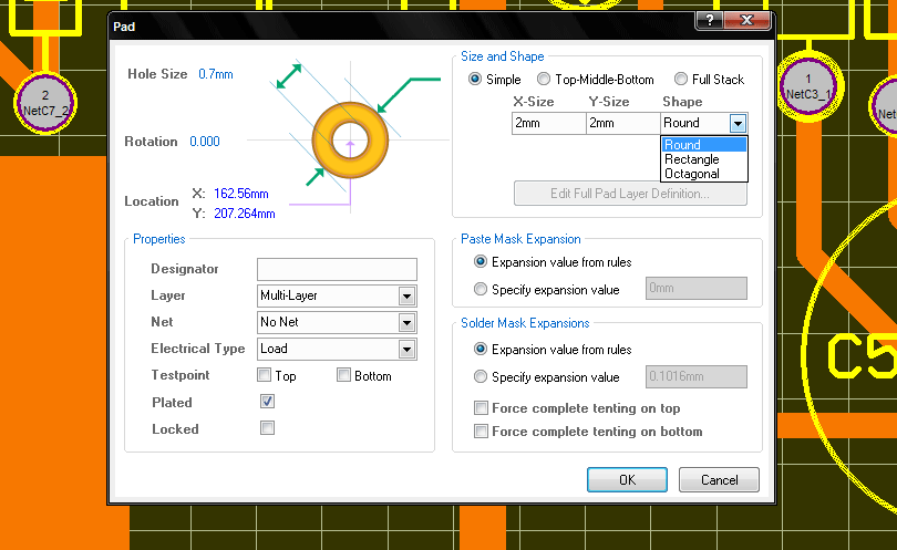

Workhorse said:I have Protel licensed Altium Technologies DXP suite, but it has no option as far as i think, if someone knows how to manipulate the pad shape, please tell.
I`m using Protel DXP 2004 and you just double-click on the pad and the menu pops up. There`s an option where you could choose between round, rectangle and octagonal.
Look at the attached picture.
Cheers!
Borko.
Oh, now I see what you wanted... Why not to drill little larger pad hole so the rectangle pin of rectifier could get in.... When you solder it ther`s no difference if the hole is round or rectangle.. Why bother...?
