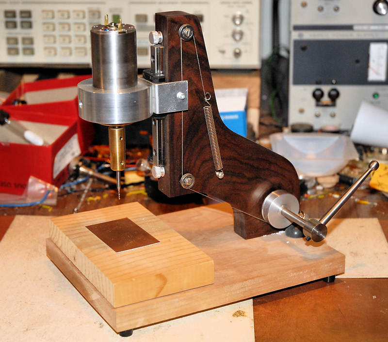

For drilling boards, only carbide circuit board drills will hold up. Unfortunately they're easy to break. Hand held anything is out of the question. I want clean holes dead center on my pads. Ideally, one uses a drill press where the drill comes up from the bottom, and the location is viewed with a microscope and crosshair from the top. That was a bit beyond me, but here's a little drill press with very high sensitivity I put together from some scraps of rosewood, maple, and some mechanical hardware from my junk box (I have a better than average junk box).
Conrad Hoffman said:That was a bit beyond me, but here's a little drill press with very high sensitivity I put together from some scraps of rosewood, maple, and some mechanical hardware from my junk box (I have a better than average junk box).
Wow. A better than average talent at slapping things together too, Conrad.

Conrad..that's a great drill you've put together. Looks like it's quite accurate and pretty too !
