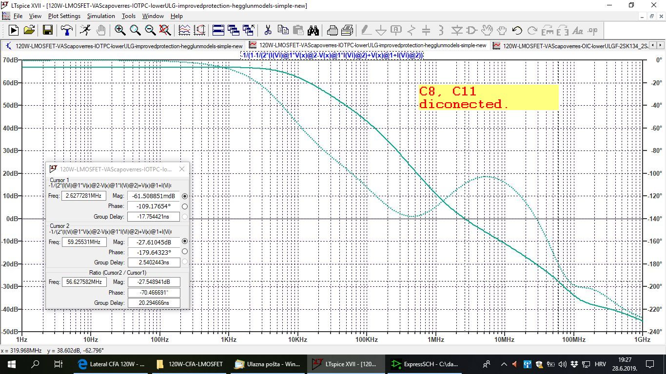

The problem are the 1uf C8, C11

The problem are the 1uf C8, C11![]()
C8 and C11 increased PM (in simulation), here is LG without those caps.
Thimios you can try with lower values as 330nF or 470nF (that one I used in my amp).
or maybe they need series resistors!

No they must be REMOVED!
Lets stay without those for a little, i want to be sure that is absolutely stable now(running an fft test)and i want to listen. 😉
mlloyd1
Yes, that's correct, but in case of enhanced VAS when is essential, but here with simple VAS not so.

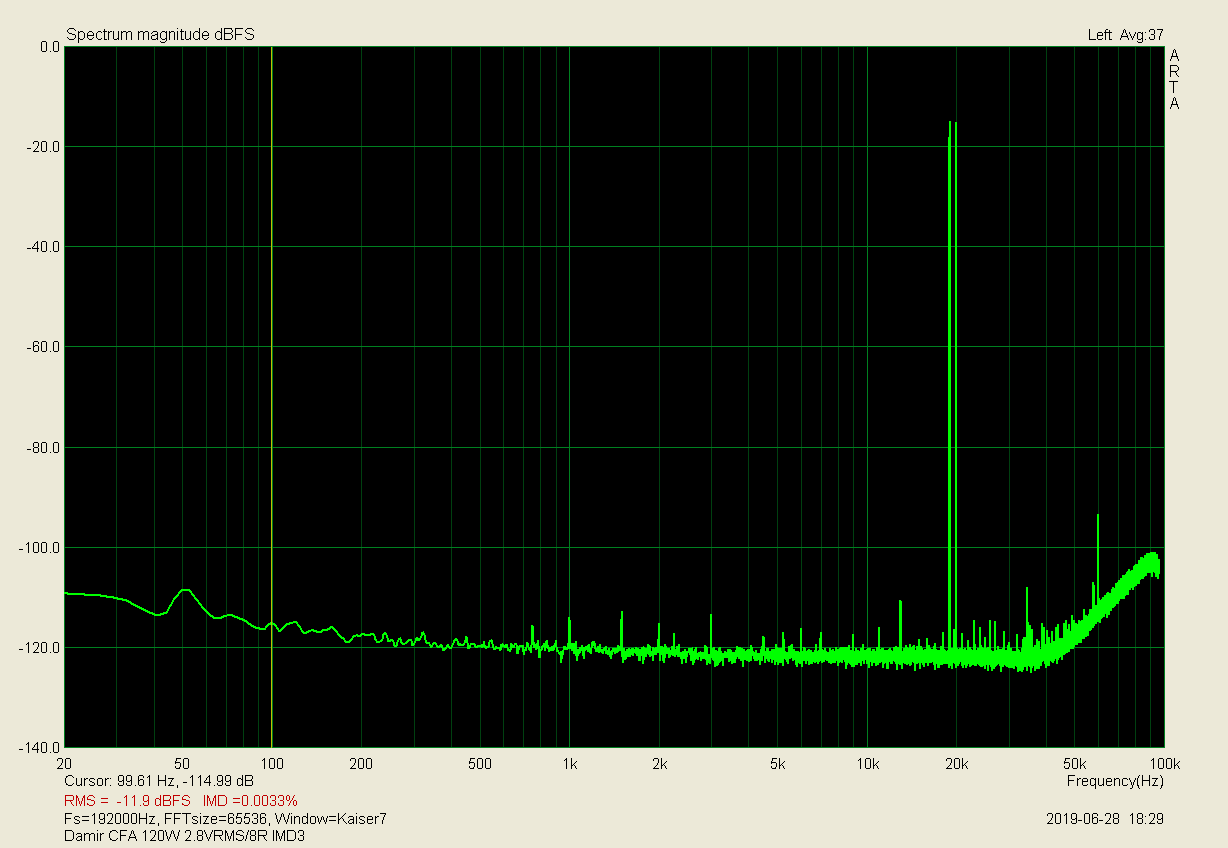

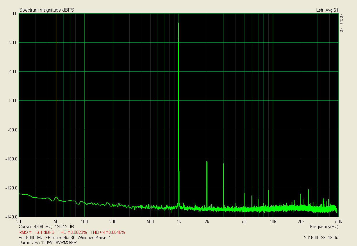

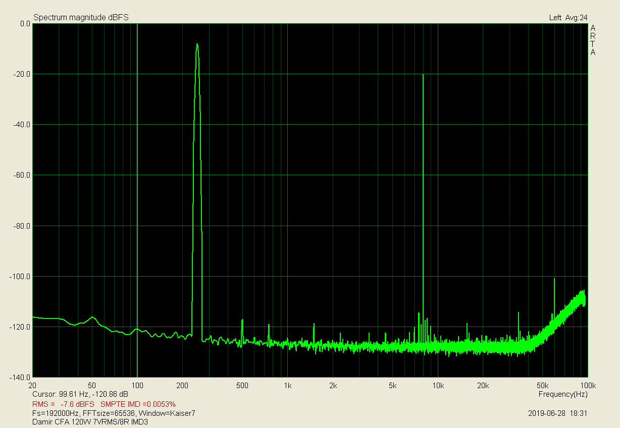

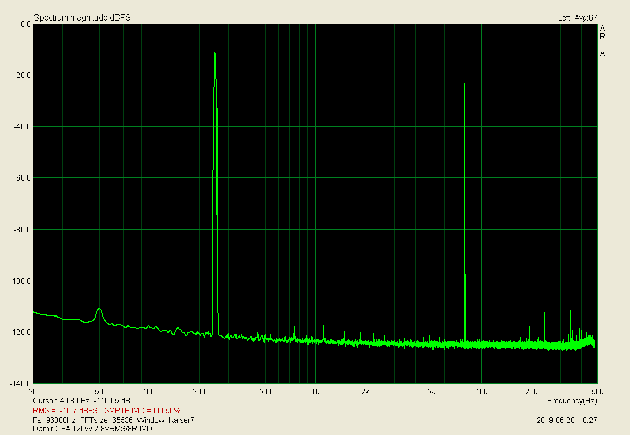

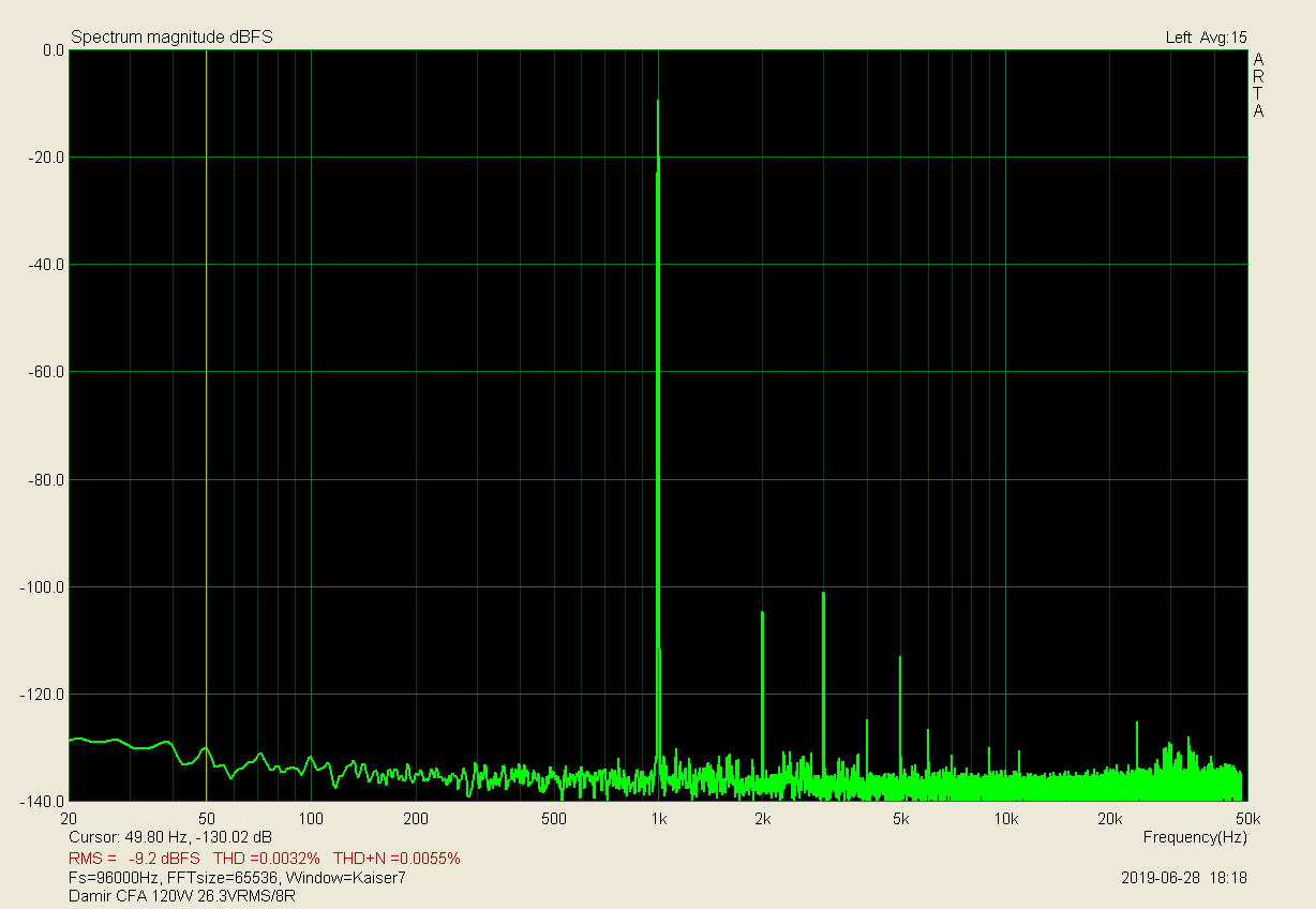

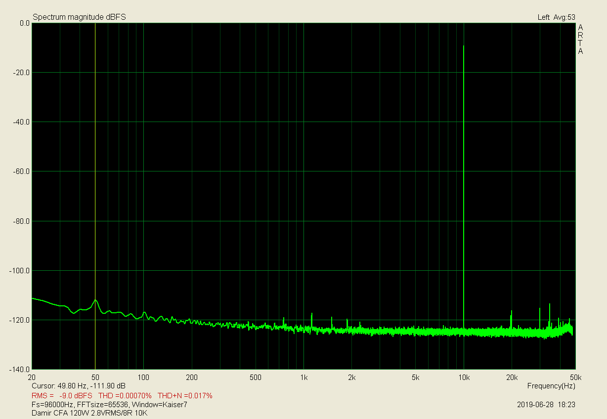

- Lateral CFA 120W - BSA
