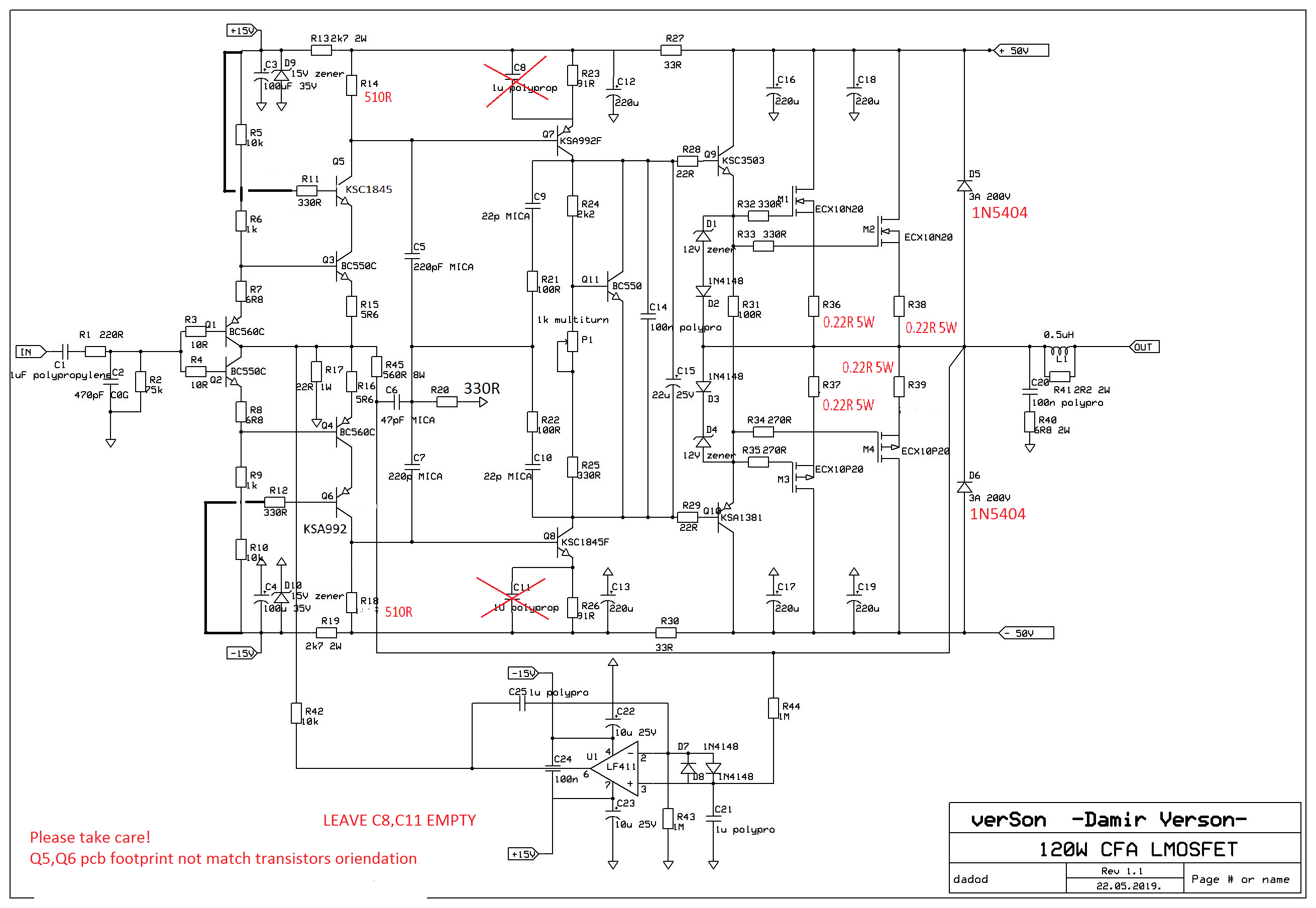

hi Damir, hi thimios,
after 2 days of rest from from discussions and and measuring of the prototype build from thimios, i am interested in the actual state of the Lateral CFA 120 BSA ( my name is Black Superb Amplifier; since the pcb has a black mate soldermask).
My planned DC supply is about +/- 52 V. What are the actual pcb modifications, changes in values, additonal equipped parts, parts not to equip? i followed the discussions in the thread, but i am not sure, which is the actual parts list for thimios working prototype.
Damir, BOM of the class A type misses R0= 10R. Is it possible to reduce the LP R1C2 to a smaller frequency, since the 3db-pint is about 1,5 MHz (C2new at 1nF or 2,2nF?)
BR
Günni
Hi Gunni,
I expect Thimios to tell what was last configuration for +-50V PS and then I will suggest BOM changes, or additional caps if needed.
You can increase LP cap, with 1nF 3dB point is around 1.1MHz and with 2n2 around 360kHz but phase shift at 20kHZ is 3.5 deegre.
Increasing LP resistor will increase input distortion and noise. You know that source output impedance is part of that LP filter.

I will post schematic as built for +/-50v power supply soon.

Ok here you are.

Understanding it correct , Q5 and Q6 is designed for 2N5551/2N5401 or BC550/BC560 (turned bei 180°), but not for SA992 and SC1845. Anything against the use of 2N5551/5401 or BC546/BC556 or BC550/BC560 (Class A version). C8 and C11 can be used in the Class A versiin (35V DC) ? i have here 330nF and 470 nF Wima MKP4 or should they remain unequipped? Damir, do you agree to the layout issues i sent before? Which layout program did you use?

Nothing against 5551,5401 just i have change those because i can't trust the UTC label especially when looking for the source of oscillation.
It seems that C8,C11 not affect the stability at +/35v

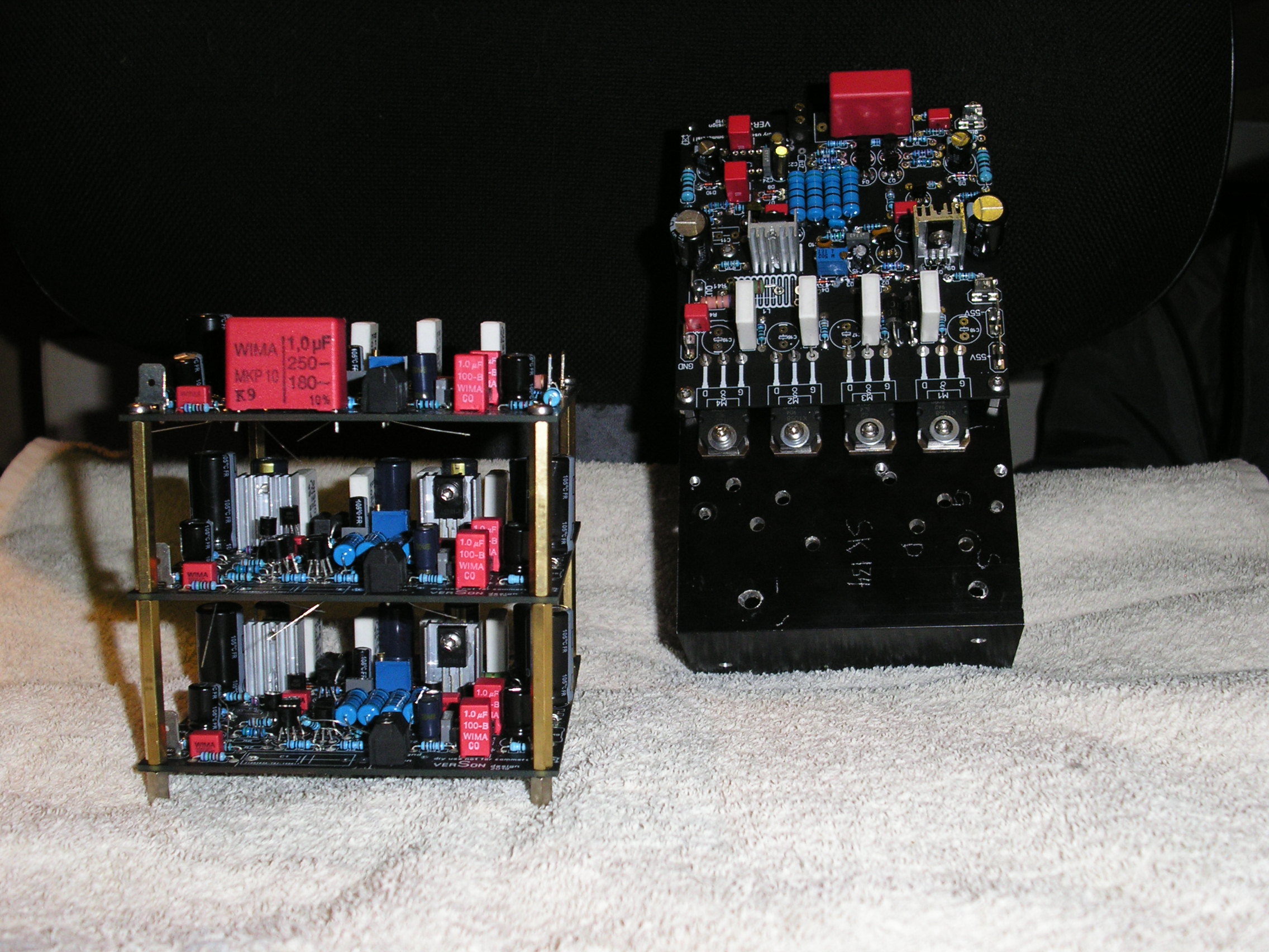

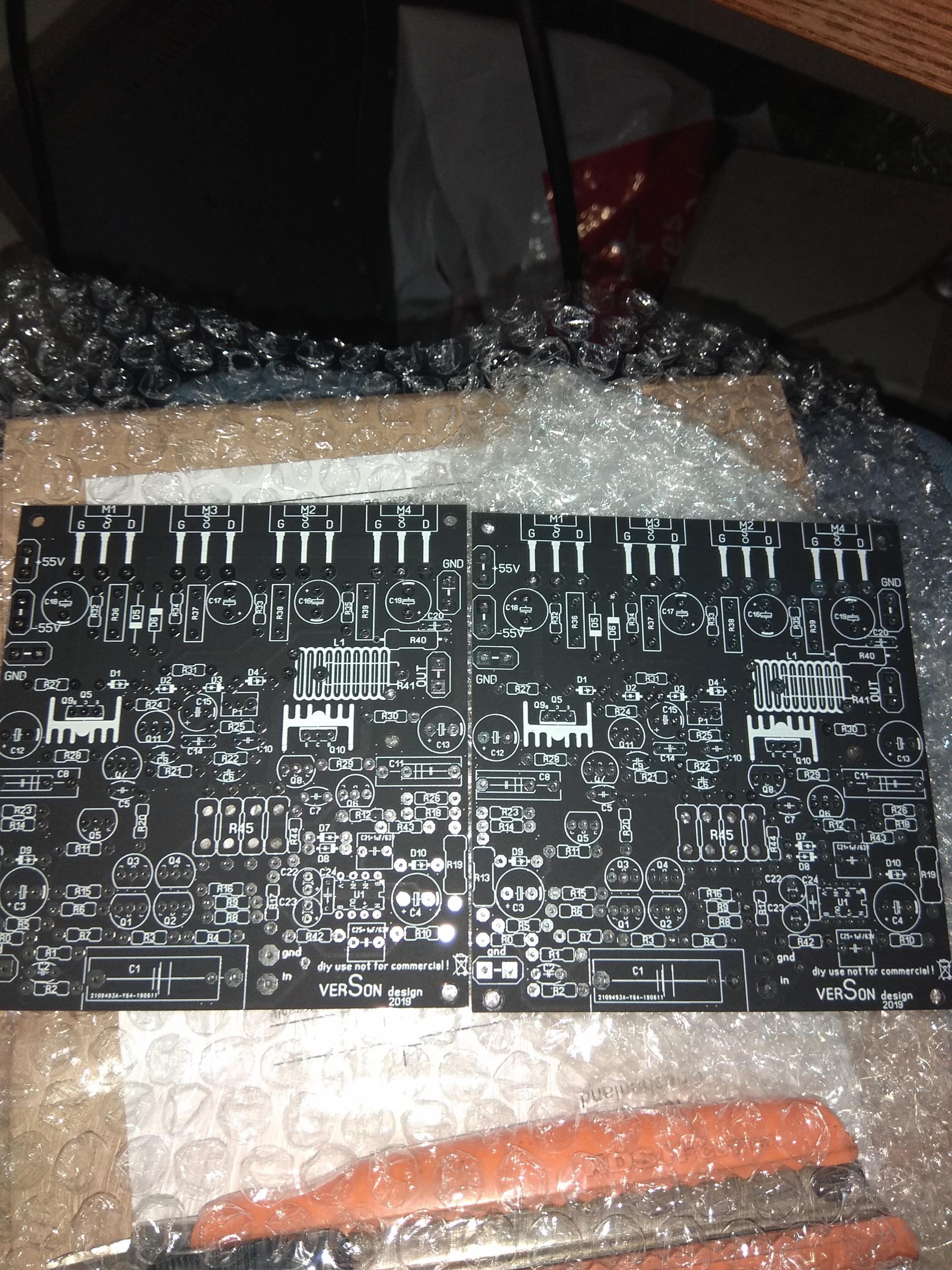

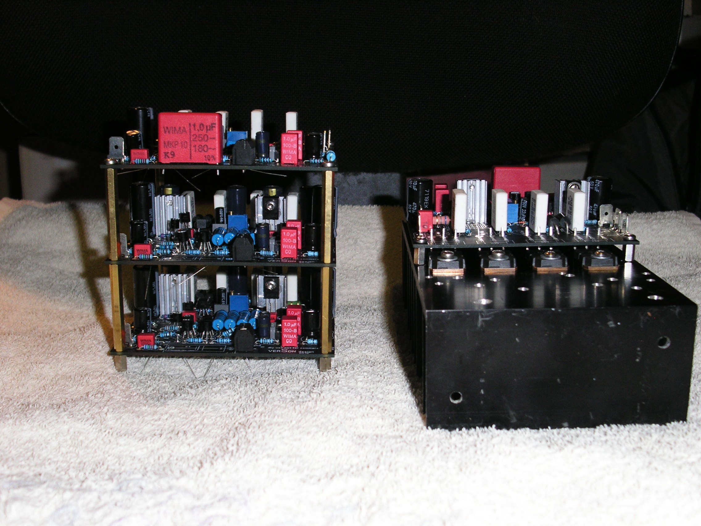

Both versions of the Lateral CFA 120W BSA (Black Superb Amplifier) are soon ready for test. Some capacitors , resistors and the coils still missing and ordered already. i am really excited, how they will sound both.
If someone is interested in remaining empty PCBs, PM me. Due to high shipping costs, only european users will be preferred
Günni
