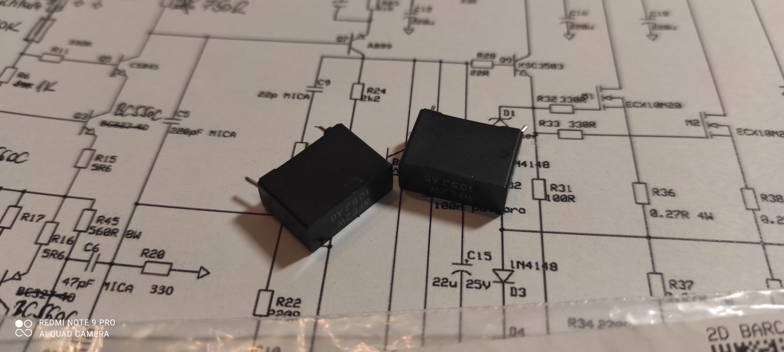

Hello Damir,
since i am close to finish one pair of each version, i want report some remarks egarding mechanical issues:
all drillng holes for R >1W very tight, the same for C1,C8,C11
drillling holes for Q9 and Q10 too tight (2SA1381,2SC3503)
the source resistors R37 and R38 are very close to the capacitors (Lifetime vs temperature)
for C20 i used a MKP2 from Wima with 100nF 100V (5mm x7mm base area)
the area C19, C20 R40 R39 hard to equip, since R39 overlaps R40 (left drill hole of R40 too small), to prevent stress, i equipped R40 from the bottom side.
Waiting for 1 resitor value and winding the coils, and the ready to turn on. Let's hope the best.

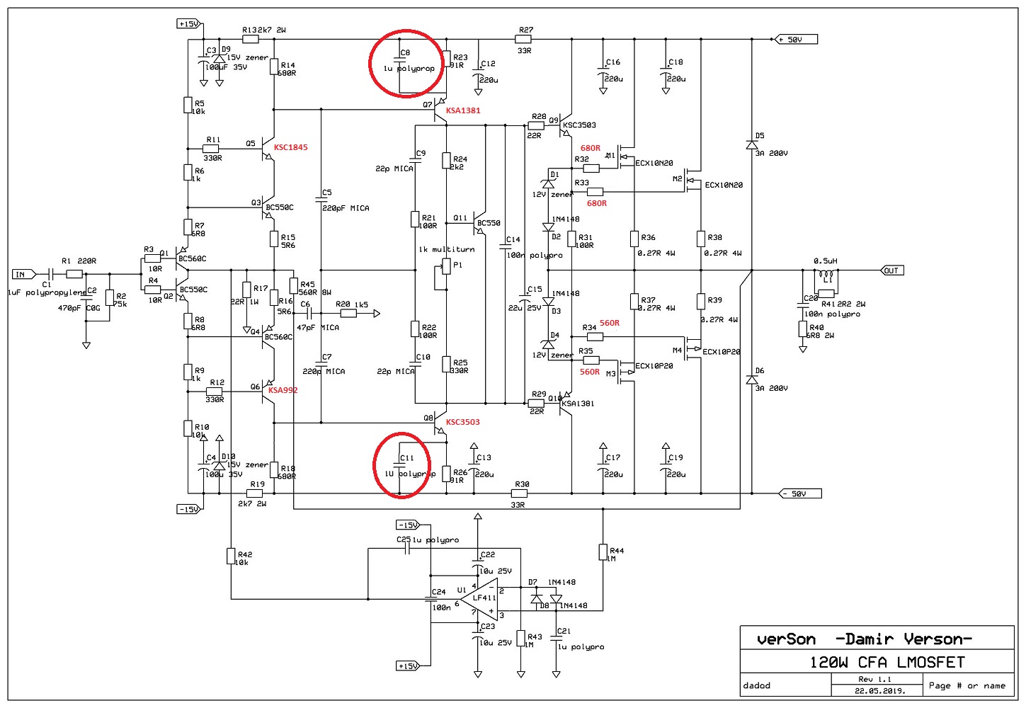

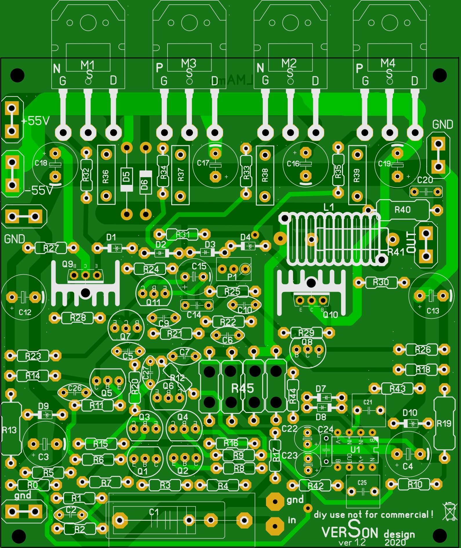

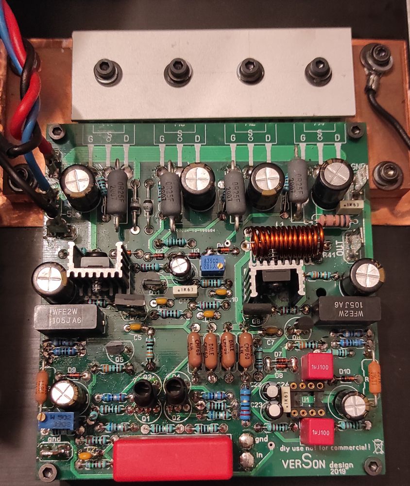

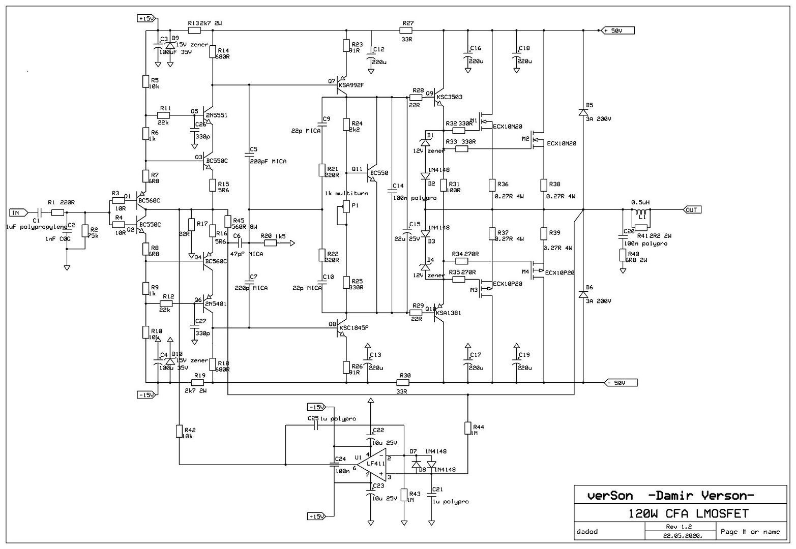

Hi Gunni,
After long time😱 I have one more build result here from Croatia.
Here is improved PCB board gerebers.
I followed your suggestion about layout and did some more ugrade, actually just increase in value for R11 and R12 to 22k and add caps C5 C27 to prevent coscode oscilation.
Still is possible to use old PCB with some careful increasing some to small holes.
Capacitors parallel to VAS resistors are removed.
Output mosfet source resistor can have different (smaller value) or not used at all(short jumpers) if output mosfet well matched.
BR Damir

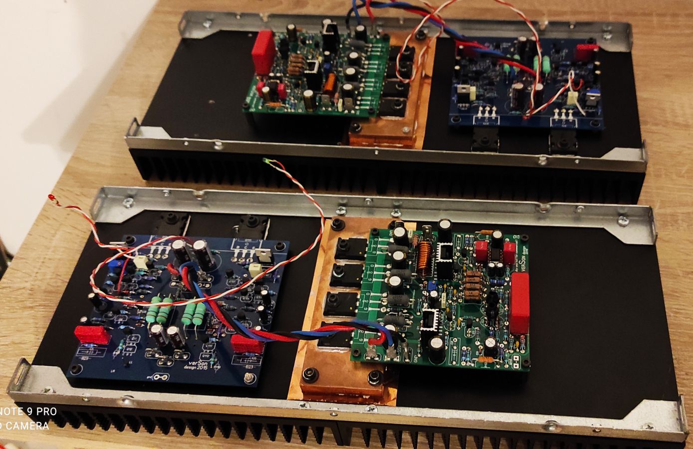

So far in Croatia there are two amp finished and tested and it sims the owners are very satisfied with the sound.
Have anyone more finished this amp?

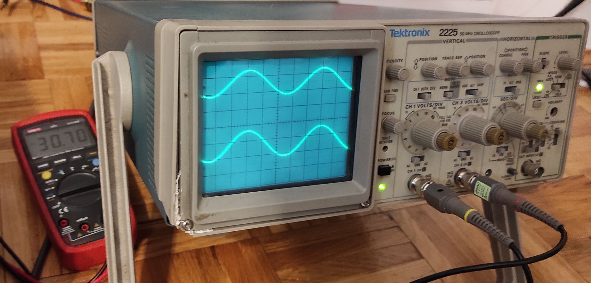

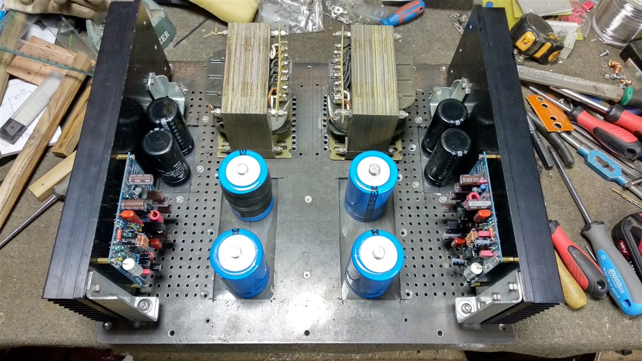

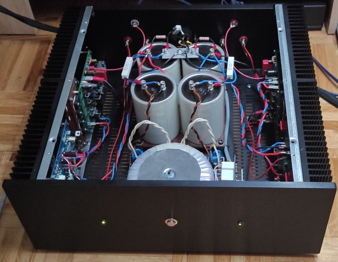

Finished.
Amp sound fantastic, highly recommended!!
With +-52V PSU I measured 30.7V with 8R dummy load before clipping. That is 117.8W Pout.
Regards

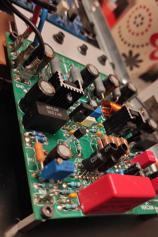

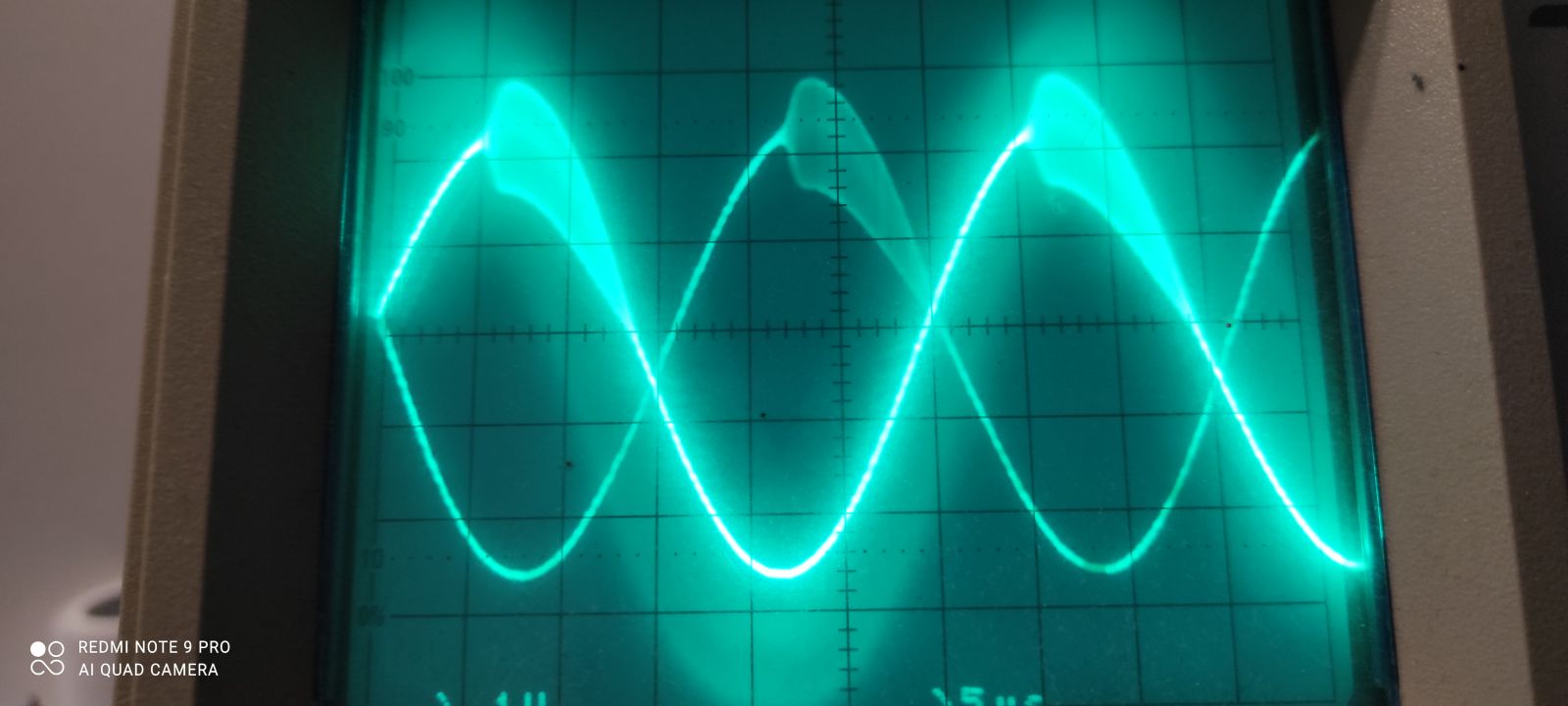

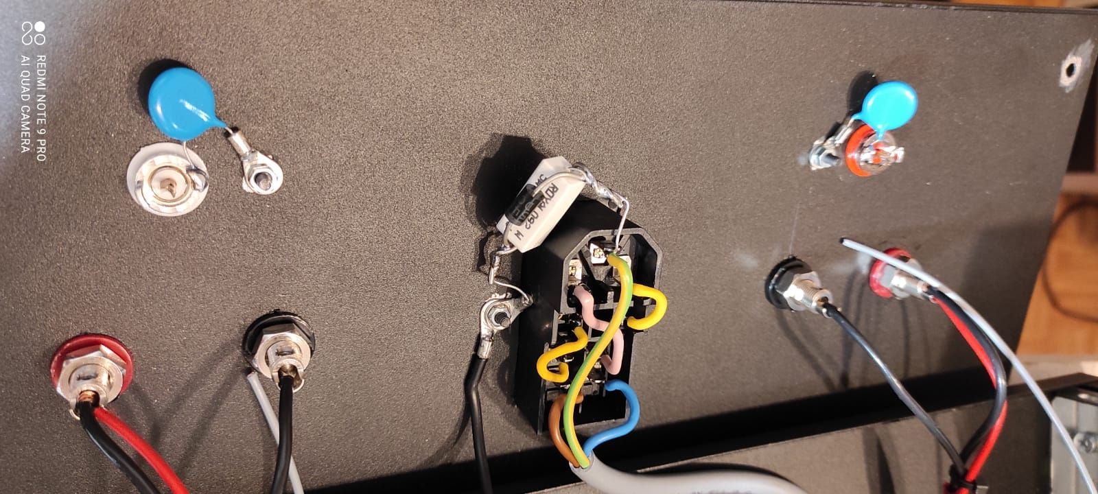

After some listening, amp started to have distorted sound. I've spend a few days to track down the problem and the problem was RF noise no being decoupled to GND. Solution was 10nF ceramic caps from input RCA GND to chassis.

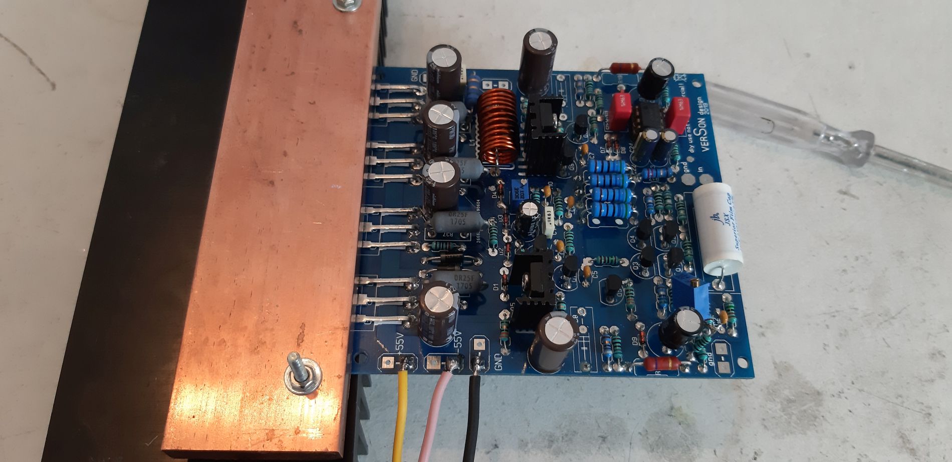

After that, amp sounded great, but on some specific frequencies it sounded weird. I have measured it with Tektronix 2225 and everything was fine. That, I've decided to measure it on Tektronix TAS250, just to be sure and saw oscillation. 😕 Guess my 2225 needs some refresh and calibration.
Oscillation occured only above +-50V. On the attached picture, it was +-50.3V. On +-55V, sine wave wasn't recognizable. But how? Amp works and sounds good.
I started to track down the problem and solution was to tighten the Exicon laterals with aluminium profile on the Exicons (see picture). The key is that everything needs to have a good GND connection. After that, oscillations were there, but they were reduced. Next thing was to change gate stoppers from 270R/330R to 560R/680R. After that, no oscillation occured even on +-60V.
And last thing, 1uF caps C8/C11, bypass caps on VAS, with this modifications can be used with no oscillation. They were never the problem, problem were Exicon mosfets.
So, if you want to build this amp and use PSU over +-50V you need to make this mods, but on +-45V (safe margin from +-50) it is good to go with original schematic from post #1.

I did not built this amp with Exicon laterals but with Hitachi ones in TO-3 case, and there was not oscillation problem. When Filkoman said to me that oscilation stops when Exicon case touched by hand, I suspected stray capacitances and non metal case of those laterals. Metal grounded cover over plastic laterals solved the problem plus increaded value of the gate stoppers.
