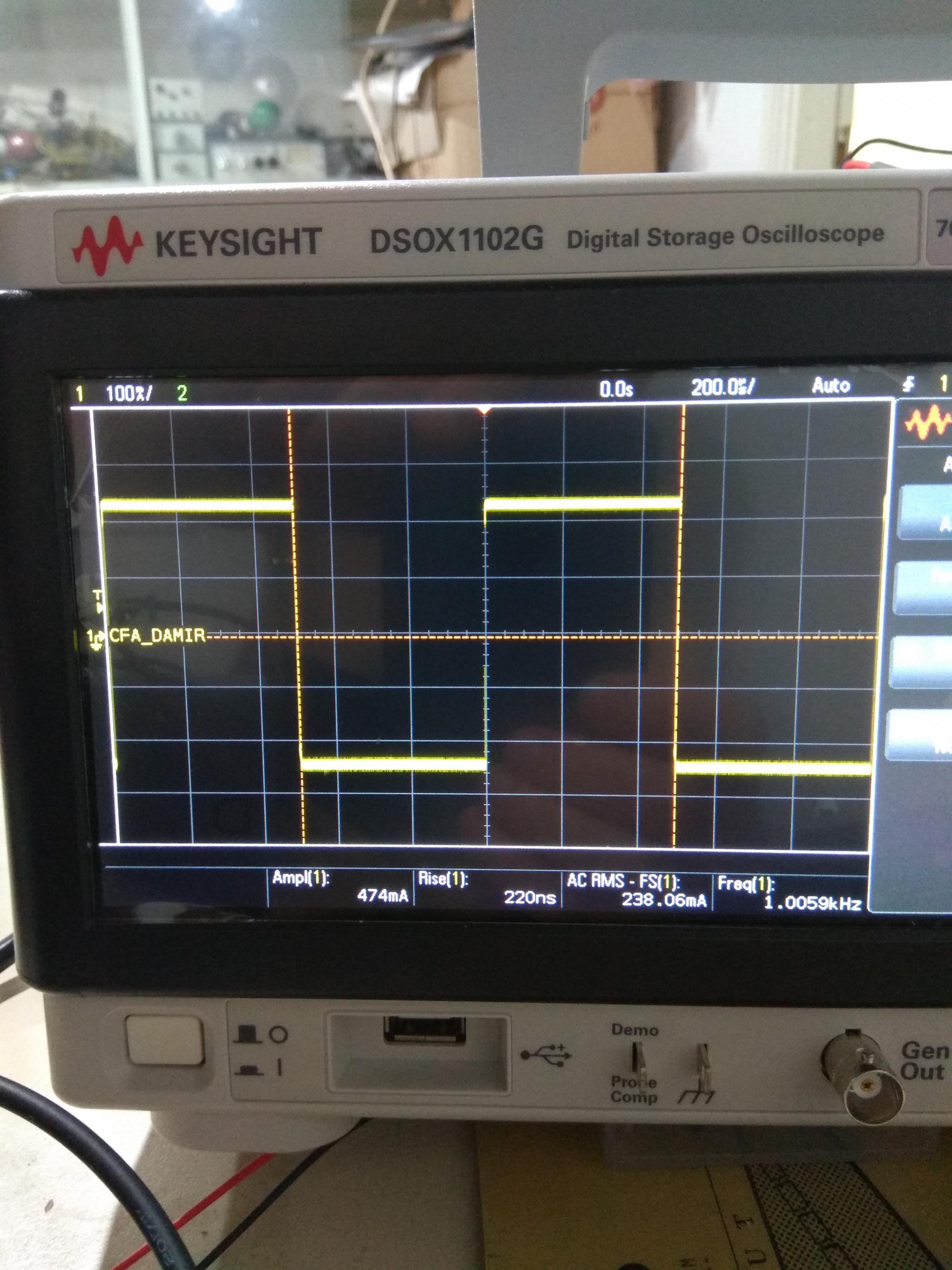

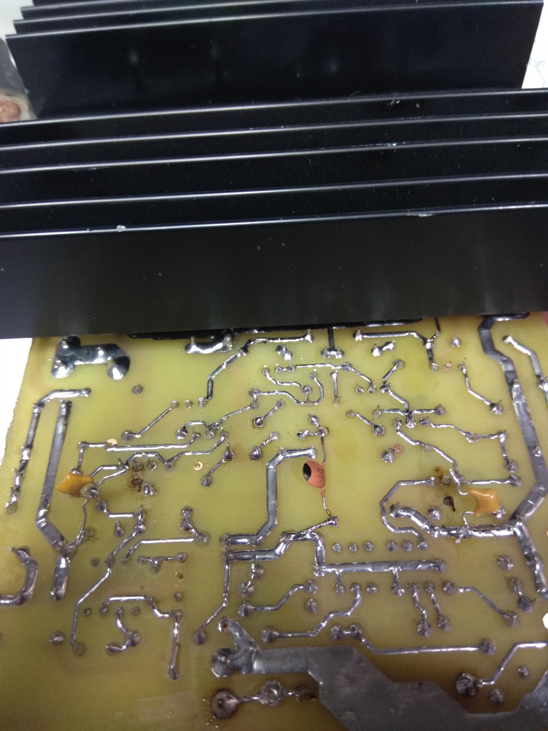

Lateral CFA 120W - BSA

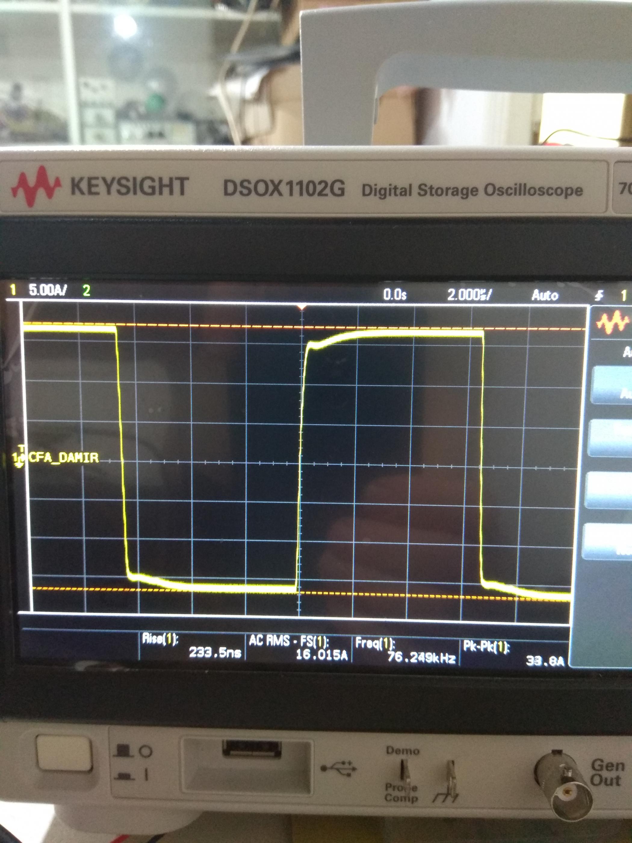

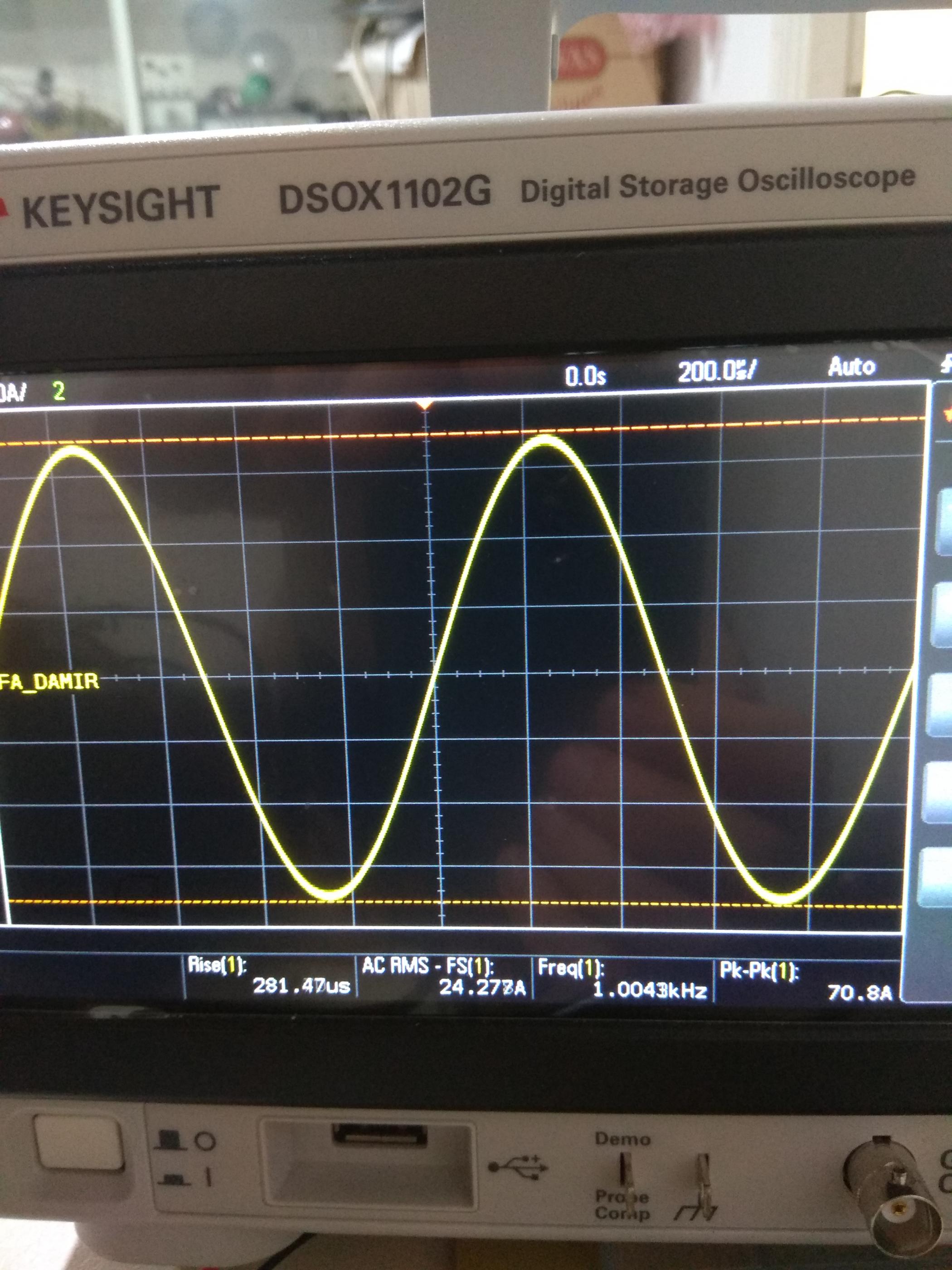

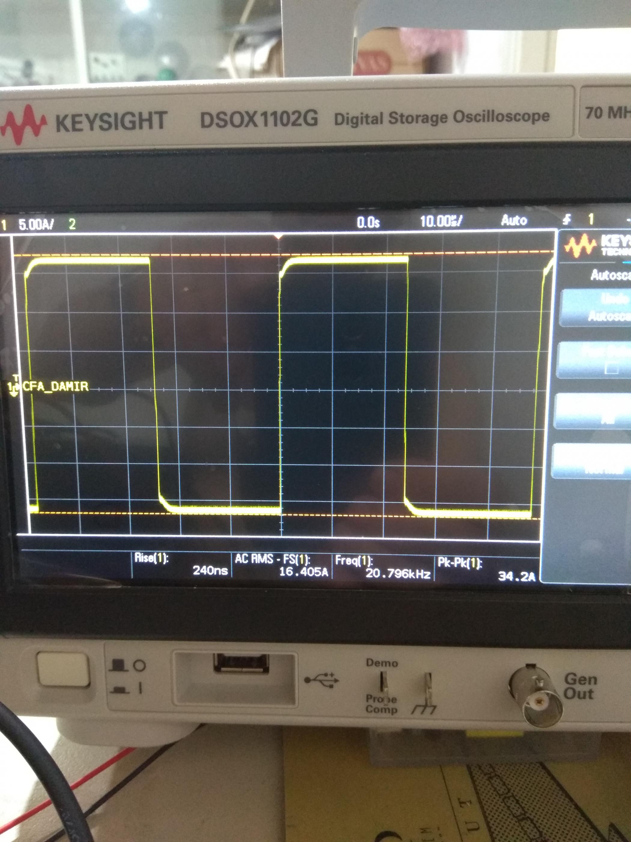

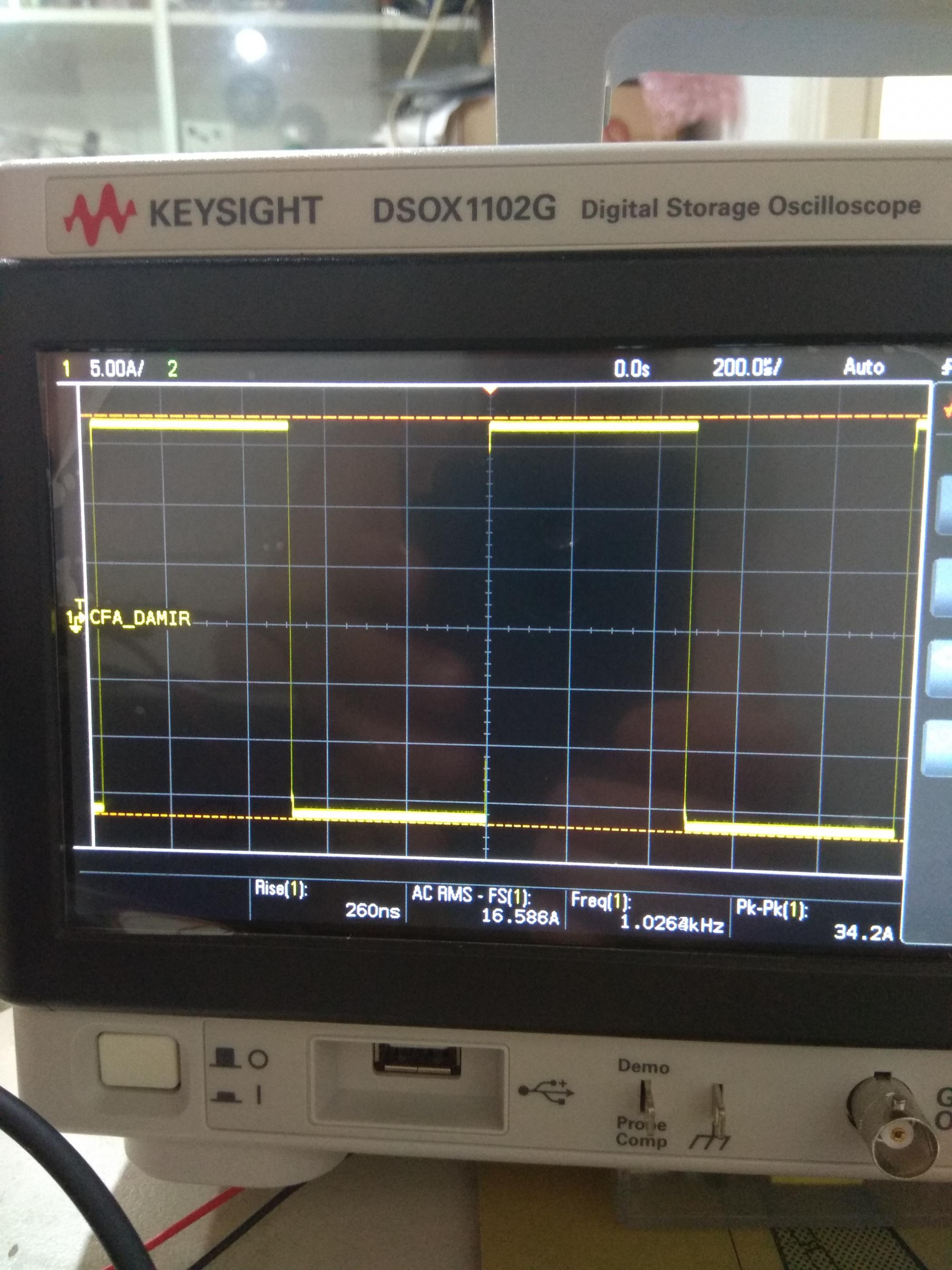

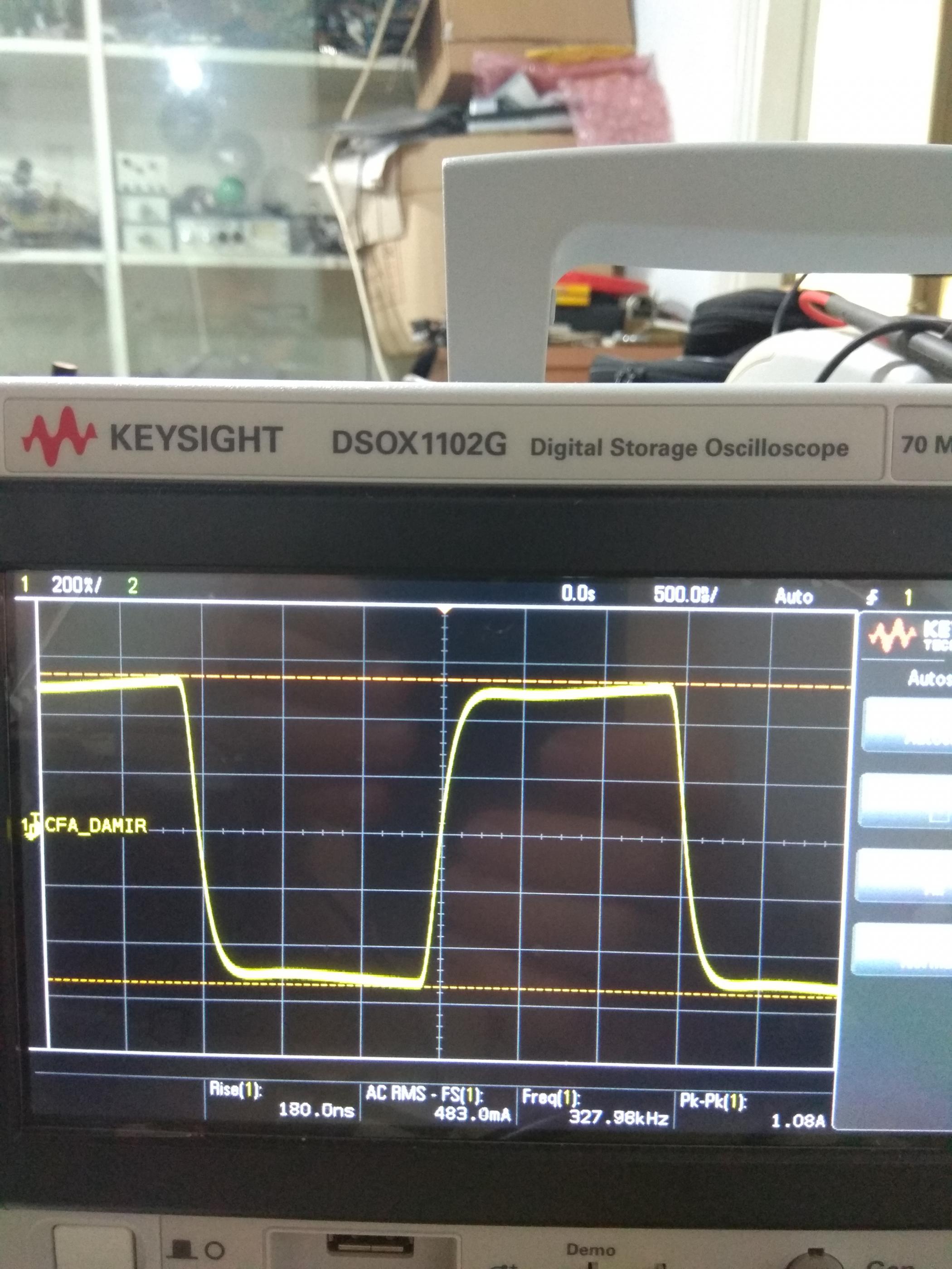

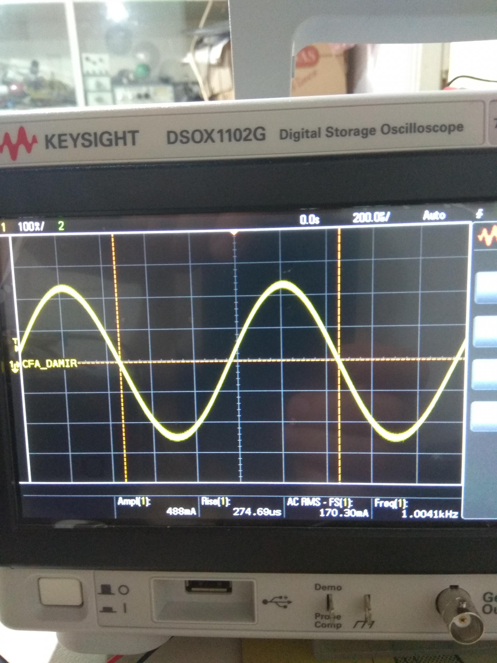

Problem solved with Valery's suggestion.
Cherry compensation is difficult. It is highly depend on capacitance input of output transistor. In Symasym amplifier, if output transistor change to 2SC5200 it become oscillated. Change the value of cherry compensation resolve the problem.
Damir, maybe you should try exicon latfet model of Ian Heglun in this forum. Maybe it need change the value of gate resistor and adjust the cherry compensation.

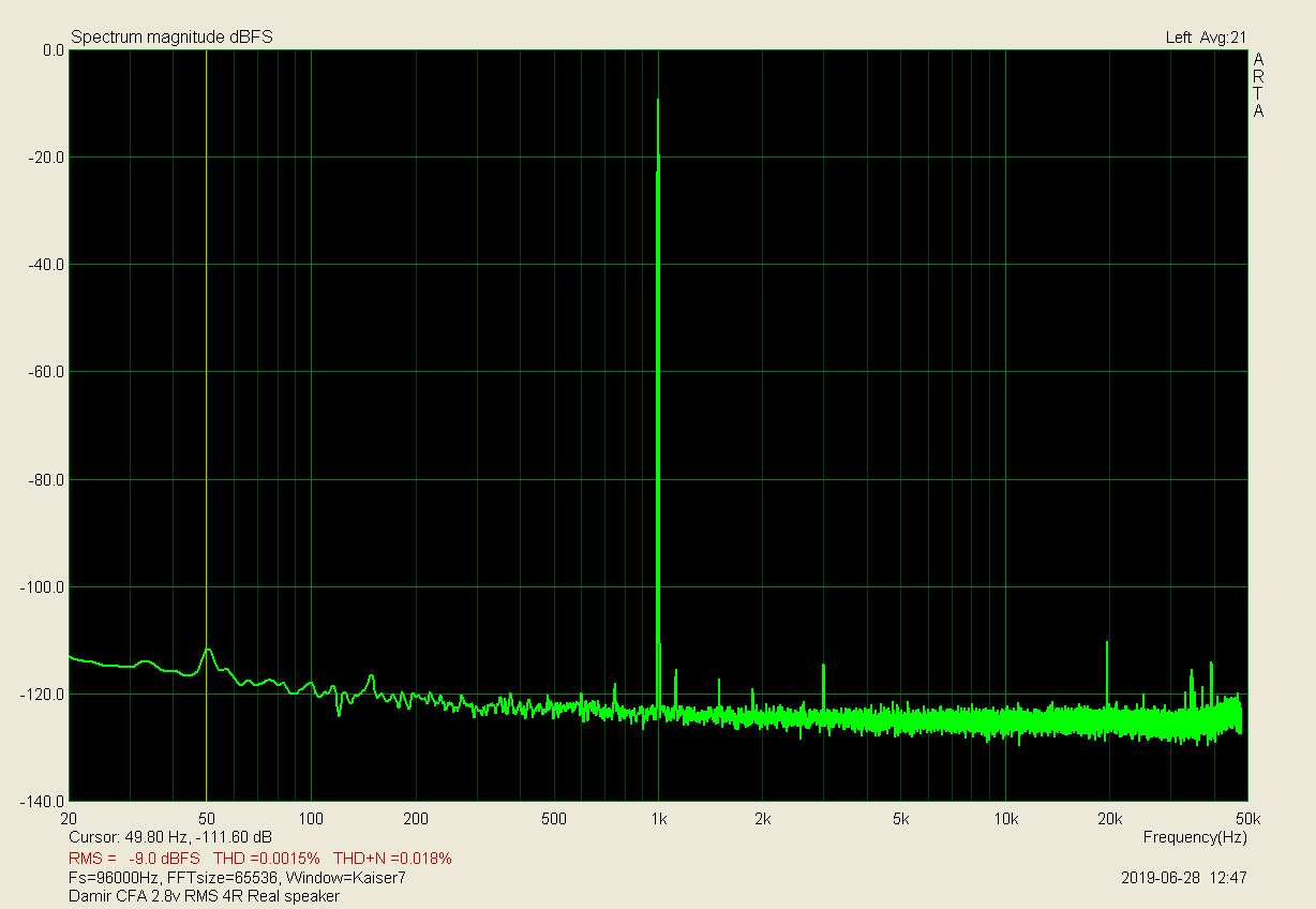

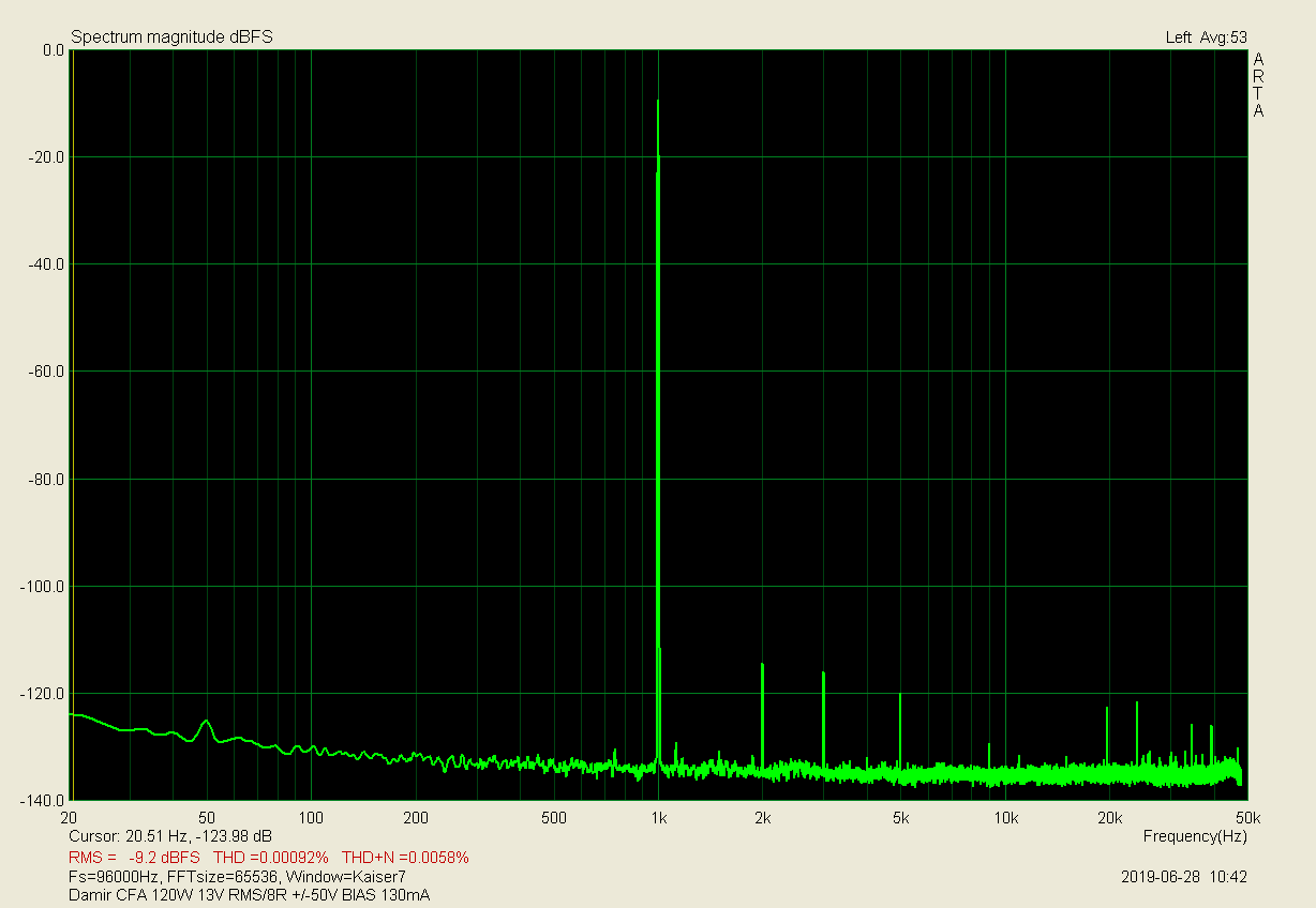

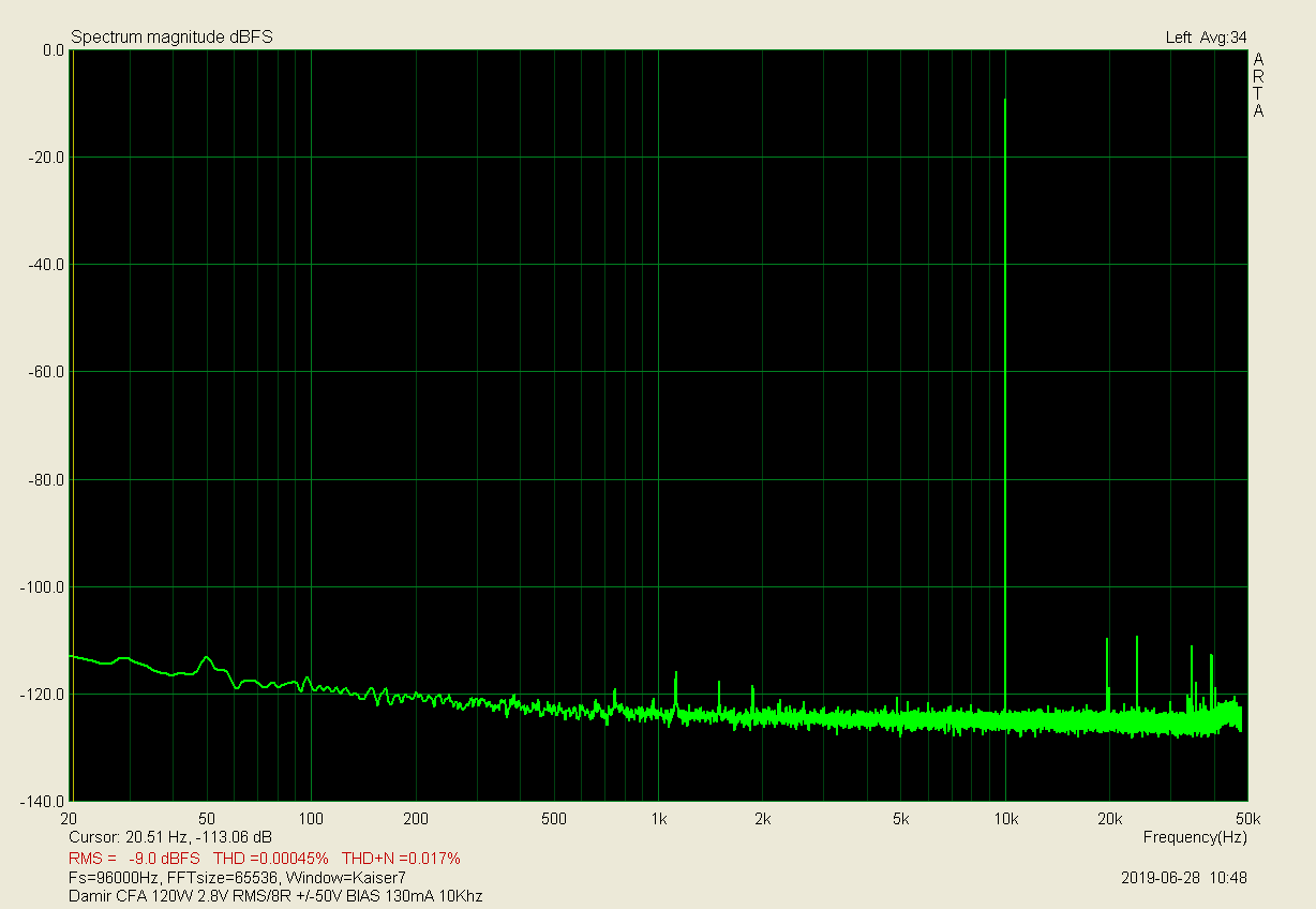

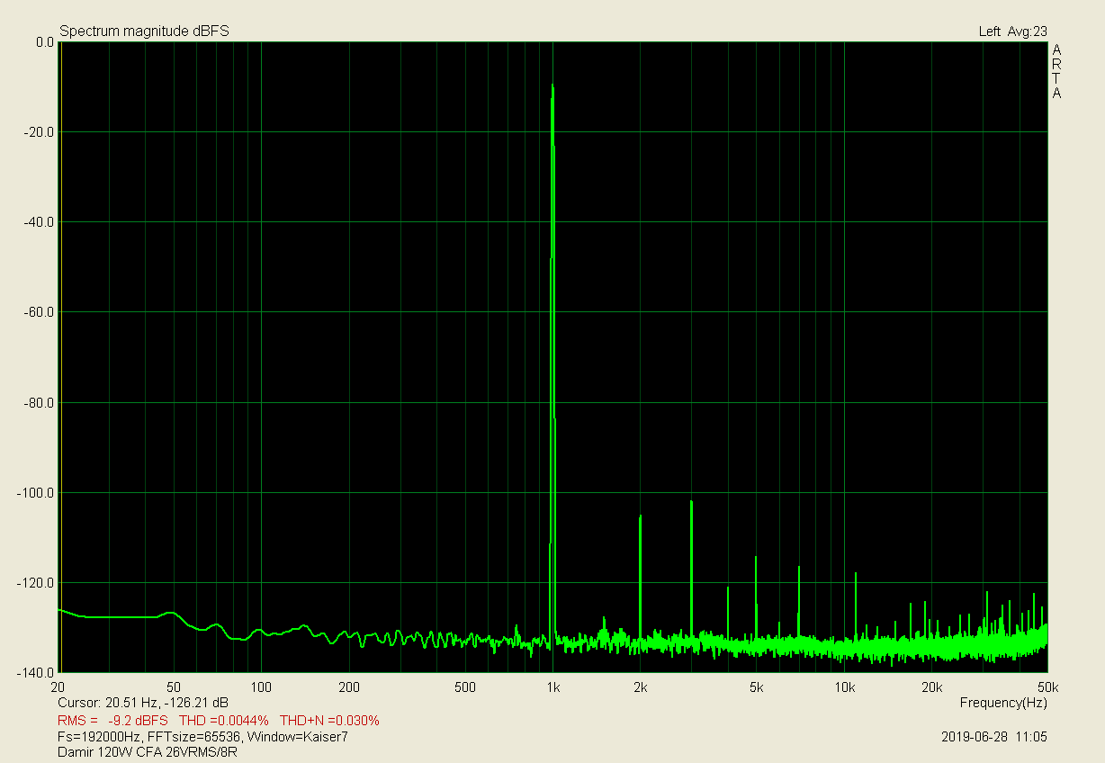

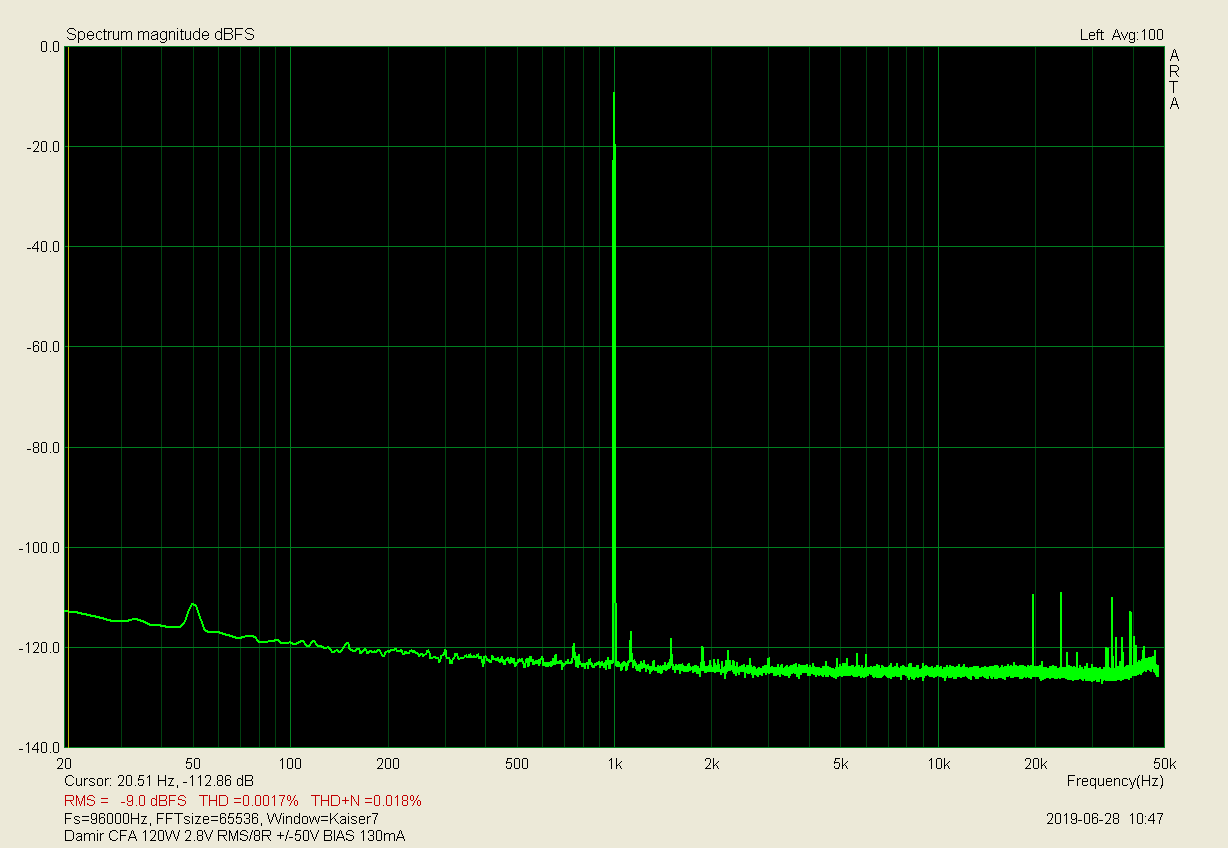

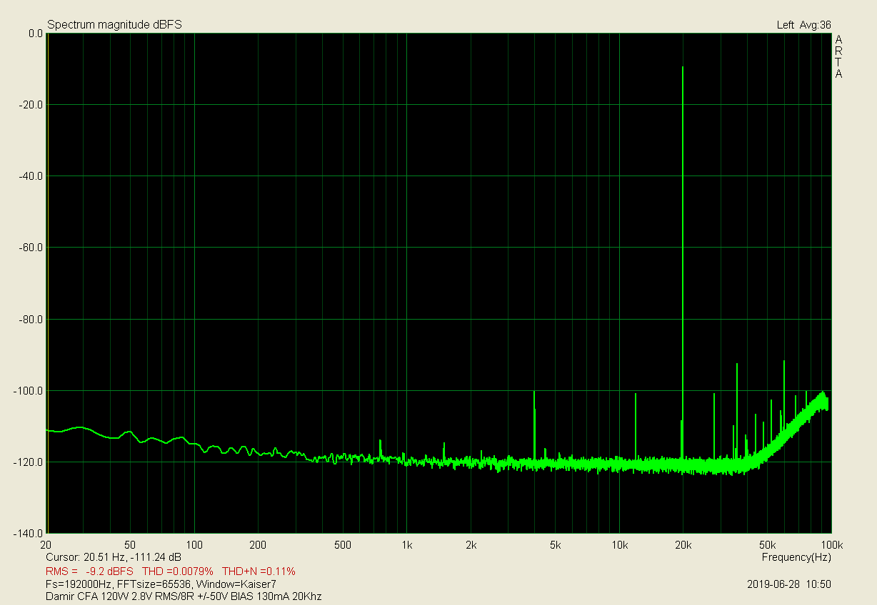

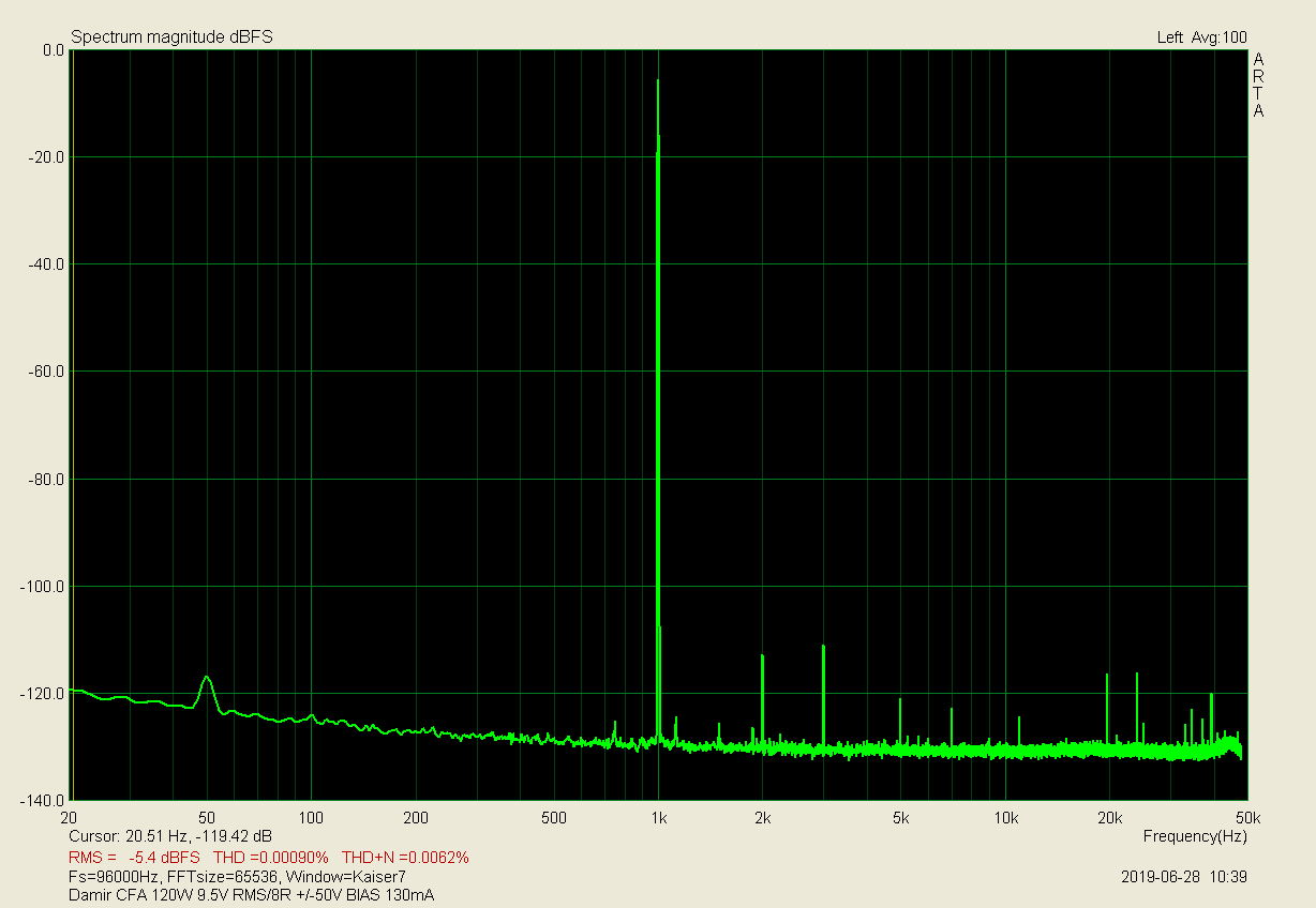

Damir CFA120W +/-50V FFT
+/-50V
bias=130mA

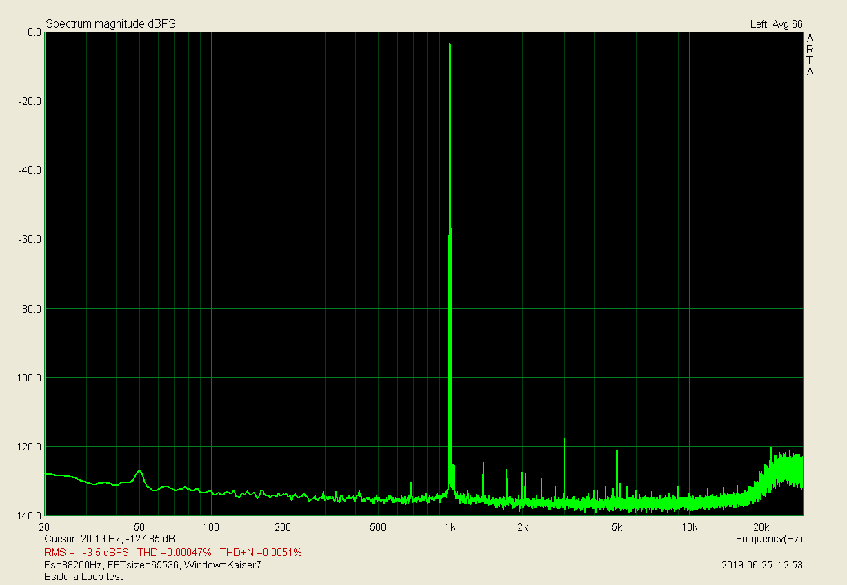

Last picture the sound card loop test for comparison.

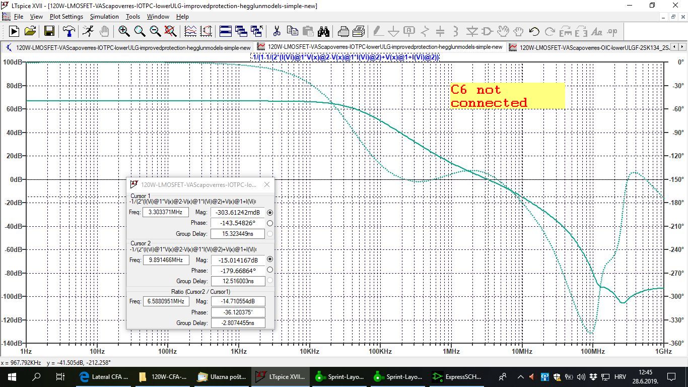

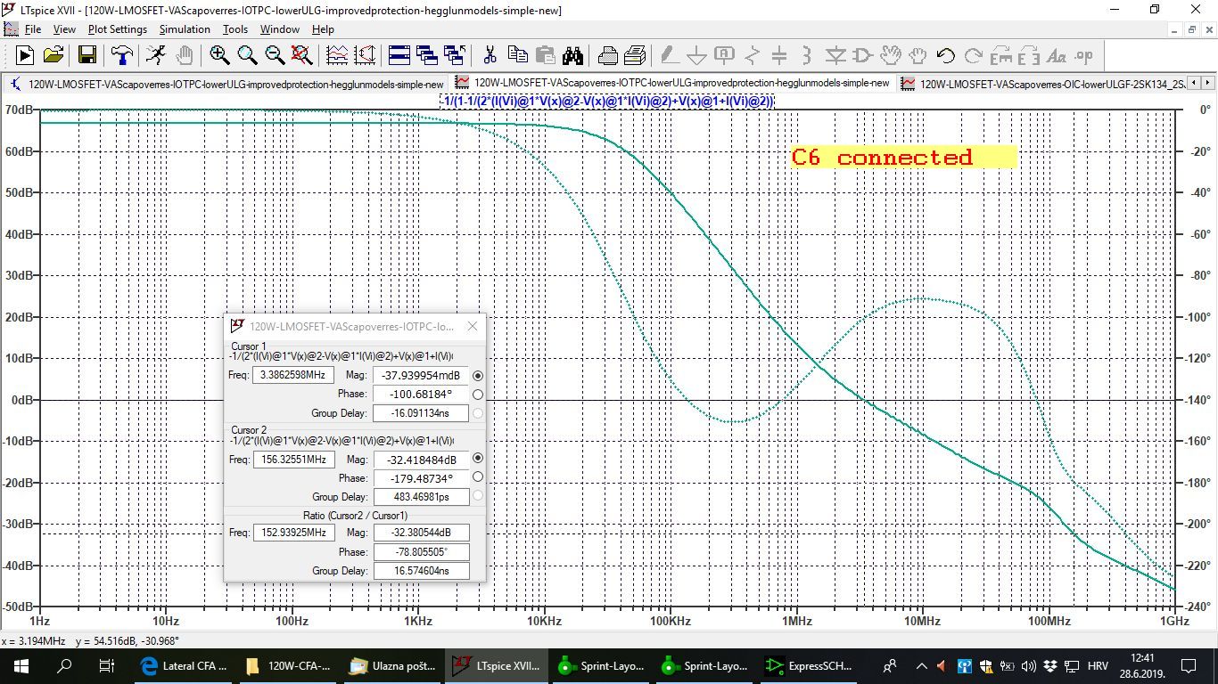

I used exactly exicon latfet model of Ian Heglun in my simulation.
If not OITPC I will not support anymore.
Here is simulated LG with C6 connected and with C6 not connected.
ULGF does not change but PM and GM drop dramatically.
It could be that Exicon latmosfet need higher value for gate stoppers, try 680R.
