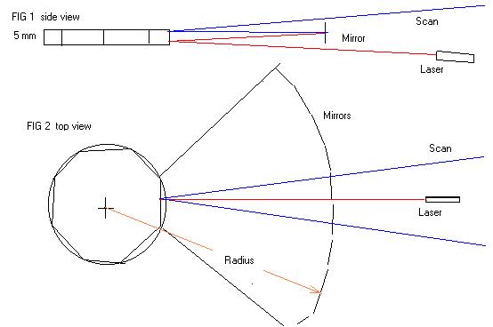

Here is a simple experiment to show you can get much more speed out of a simple low cost polygon.
Turn down your laser beam power if you can.
Do not look into or at a laser beam, use a piece of paper to locate a beam
Do not put fingers on the polygon facets because your skin has oil
Look at the beam spot on the facet at an angle so you dont get the laser beam in your eyes.
Here is the experiment
(A) Aim a laser at a polygon facet
(B) Place an upright mirror to intercept the reflected beam
(C) Get the reflection from the mirror to hit the same polygon facet.
Slowly rotate the polygon by hand so the laser beam moves along the facet.
Look at the facet at an angle so you dont get the laser beam in your eyes
You will see a slowly moving spot on the facet and, at some point, another spot moving at very high speed.
The slowly moving spot is the unaided speed
The fast moving spot is 10 or 20 times faster and is the one I am using.
If you do this experiment you will see the high speed spot is obtained by the polygon and a mirror acting together.
I need 312 lines (one PAL tv field) per revolution of the polygon.
I have 8 facets on my polygon
Unassisted will only give me 8 lines per revolution.
I need speed assistance from some mirrors
How many mirrors
312 divided by 8 is 39.
I need 39 mirrors.
An 8 facet polygon gives 720 divided by 8 is 90 degree scan angle.
I need to fit 39 mirrors perfectly in a 90 degree quadrant at a radius from the motor shaft.
I do not know what is the correct radius for the mirrors but if they are all the same width and they fit perfectly in a 1/4 of a circle it should not make any difference. The mirrors look like they should be 1/2 inch wide. To be confirmed
Motor speed calculations one field of 312 lines in 1/50th of a second is 50 fields per second is 3000 rpm
Setup with just one mirror
Start with no motor speed
Most ex printer polygons have a small facet thickness usually 4-6 millimeters.
Thats not much room for a double reflection so you have to be accurate in laser beam and mirror placement
Put your laser 30 inches from the polygon. Aim it at the motor shaft
Your laser needs to be exactly horizontal and then the beam tilted up a very small amount Approximately 1/4 of a degree
Your polygon should be positioned so the laser spot is towards the bottom of the facet that is facing the laser.
The polygon facets should be horizontal
Place a 2 inch wide mirror 15 inches from the polygon
The reflection from the mirror should hit the polygon towards the top of the facet.
Run your polygon at 3000 rpm
The reflected scan will just go over the top of your laser diode with nothing to spare.
The scan angle is about 15 degrees
Place a white paper behind the laser
If you have an 8 facet polygon you will have 8 tv lines on top of each other. A frame scanner would prove the point.
8 tv lines with 1 mirror equeals 312 lines with 39 mirrors

Forgot to mention I have made enquiries for HOE items. An HOE is a Holographic Optical Element that can, amongst other things, replace a polygon. Have only tried one company who advised they were bought out by another company and were now a research and developement division and could not help.
Hello,
Richard, your math calculations about number of mirrors seem to be correct. To calculate radius of 90 degree mirror segments (aproximated):
mirrorsegment = 2*radius /4*39 = radius/78.
Radius = 78*Mirrorsegment.
Well, it isn't 100% correct, because it's the length of the part of cicle segment, but may be a start.

Placement of mirrors is a problem with no simple solution. I have positioned mirrors many times without much success. Each mirror has to be exactly vertical, each mirror has to be exactly on the radius and each mirror has to be square on to the polygon motor shaft. I have an idea in mind to simplify mirror alignment but before that I have to see if there are 8 raster lines on top of each other as mentioned in previous post.
Greetings
There are 8 scan lines per mirror per revolution.
Simply rotating the polygon by hand shows each time a facet on the polygon is in line with the one test mirror it produces a scan line.. 8 facets = 8 scan lines per mirror. 39 mirrors times 8 = 312 scan lines per revolution.
Greetings
Using one test mirror I should have, with an 8 facet polygon, 8 raster lines. I did a simple frame scan by wriggling a flat mirror in the scan path. There were 8 raster lines. Large wriggling of the mirror spread these lines a lot but since 8 lines is a small percentage of 312 lines I tried to keep them bunched into about an inch vertically. Looked just like tv lines. Light level dropped but can see them in a darkened room with some ambient. With modulation applied you would be struggling to see a full greyscale picture. As said before, this is a small scale test. With a 5 mw laser I never expected anything better than a faint picture.
Placing the 39 mirrors is difficult. The mirrors are arranged in a radius around the motor shaft. Unfortunately the laser beam has to pass under the middle mirror and the outgoing scan passes over the top of 5 middle mirrors. This means the middle mirrors have to be short and will be hard to position.
This problem is causd by the thinness of the polygon facets about 5mm. If it was 1/2 inch thick there would be plenty of room. I have drawn the setup and tried to post it. Hope it gets there.
A possible way to overcome this is to aim the laser off centre and shift all mirrors around so the laser beam can see the polygon unobstructed. Could cause some optic geometry distortion.
Hello Richard.
now you're nearly at the same point, where i gave up some years ago. I was unable to place the mirrors in a proper way around the poygon, so that the reflected beams are laying each over the other after passing all mirrors. To make the whole thing flexible i tried to stick them on small magnets, arranging them on a part of a metal ring, but this was not very successful. This metalborder should have had a tap through whole with 2 little screws on top and bottom to adjust each mirror separately and accurately, but this wasn't possible with own work. I know it should be a simple task but in detail it's pretty heavy.
I never had an optical bank with suitable components, so i did the last step before the last but one.
I tried the syncronisation-control between horizontal sync and polygon motor. I measured the last outgoing mirrorbeam with a photosensor and let the motor speed up until the 15,625 khz frequency was reached .Then a trigger switched off and on again automaticly, until there was a balance on the required frequency. It depends off the type of motor you are using. If it accepts any sort of sync signals the better. But of course it will not accept h-sync speed, so h-sync must be divided into motor-compatible sync-ratio.
But thats a real problem because of the mass of polygon and rotating motor components.They must react quickly on the slightest shifts of sync, or you will see garbage image. What kind of control ability does your motor have?
In general i would say, i would have been happy if there had been forum like this to discuss such questions. Five or six years ago, there was nobody, who wanted to discuss about DIY-laser projectors, so i'm happy that there are guys out there, who are interested in such a project.
Keep on track!
Greetings
xblocker

Hi Xblocker, thanks for info. Most of the mirrors are not in the way of the laser beam or the outgoing scan. Only the middle 3 or 4. Maybe glue a stick on mirrors and pass stick through a ring like a curtain hook with small rubber grommet. Screw hook into place, slide the stick through and three kinds of movement. up/down left/right and forward/back. Side to side movement of ring maybe could use a thin flat wood strip pivoted say half an inch behind the mirror. Screw curtain ring into flat strip. Move flat strip left or right. Putting a lever on the mirrors might make it easier to position them. Remember, the trace time is only a bit more than 4 times the retrace time so a gap between mirrors is ok.
But I am not getting into that until 100 percent sure the fast scan mentioned in previous posts is fast enough and suitable for the job. The only real way to tell is
