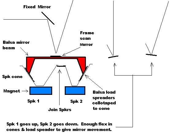

The situation with the mirrors is that all are needed but the middle 3 or 4 have the outgoing scan going right over the top of them with very little space to spare which means they cannot be very high, and the central mirror has the laser beam going underneath it as well. Have a look at the diagram I posted. Here you can see the laser beam underneath, and the scan over the top. This means a few mirrors in the middle have to be short about 5-6 mm high otherwise they block the outgoing scan. There could be a better way of arranging the mirrors but I'm not sure how. The calculated scan angle is 11.25 degrees.

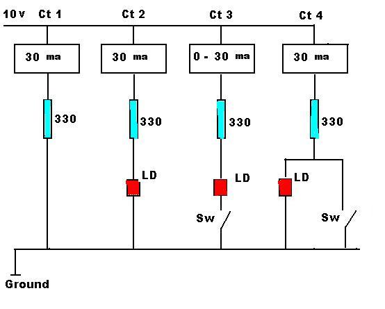

Work on the modulator is proceeding. Attached diagram shows four Circuits
Circuit 1 is a simple resistor and milli amp meter. It shows 30 milliamps. With the power supply steady at 10 volts, 30 milliamps flows. No more can flow. This is the first step towards protecting the laser diode LD from burning out.
Circuit 2 shows the Laser Diode. Once again 30 milliamps is the maximum current so the laser diode is safe.
Circuit 3 shows the laser diode being turned on and off by a switch. There are only two possibilities. Zero or 30 Milliamps. If you replace the switch with a transistor and vary how hard the transistor is turned on, an amount of current between zero and 30 milliamps can flow. This can act as a modulator. The laser diode is protected because maximum current is limited to 30 milliamps by the resistor.
Circuit 4 Shows a switch across the laser diode. If the switch is off 30 milliamps flows through the laser which shows full brightness. If the switch is turned on, no current flows through the laser so it is off. The switch can be replaced by a transistor to vary how much current is bypassed away from the laser. This can give modulation. Once again, the laser can only have 30 milliamps.

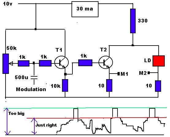

Attached circuit is a developement of circuit 4 in above drawing.
Transistor T1 is an emitter follower to keep loading off the TV signal generator. It also sets the modulation depth by the 50k Pot.
Transistor T2 removes power from the laser. It acts like a variable resistor. When T2 is off it is a high impedance and has no effect on the laser which operates at full power. When T2 is turned fully on, it becomes a low impedance and bypasses all or most of the current away from the laser. The laser is then dark. Driving the transistor T2 in between on and off modulates the laser.
I start like this.
50k pot turned right down
Soft start 10v supply.
Adjust 10v supply until 30 ma flowing through laser diode
Connect scope to monitor point M1
Turn up 50k pot small amount.
Keep turning until modulation shows at M1
Change scope to M2
Observe current in laser diode.
With this circuit, peak white is full laser power.
Modulation reduces laser power until no laser power which will then be black.
Too little modulation laser not at black
Too much modulation laser cuts off and takes time to restart. Slows down modulation.
Having the laser full power equeals peak white is very handy. The laser can not get any brighter and this point then must be peak white. Or using a red laser peak red.
The only other point to fix is black. As mentioned, the laser current can be reduced to zero but this is not good. The laser power needs to be reduced until it is just still lasing. It will be invisible so it is the black we require.
That point has to be fixed solidly.
I have not yet done that yet.
With peak white fixed by maximum laser power, and black accurately fixed by some means, the laser can swing between peak white and black. This is what is required.
The waveform shows the sync pulses force the laser to turn off. We do not want this. The correct waveform should be the part labelled just right.
I still have work to do to fix the black point.

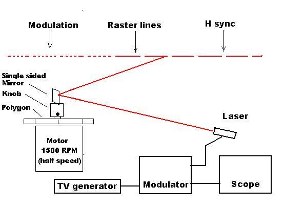

The modulator circuit in the previous post is running quite well. I can see all the cross hatch and checker board patterns from the tv pattern generator.
This is rather surprising because the transistors are audio transistors not video ones. 2n2102 I am looking around for some video transistors and still thinking about how to trim the sync pulses off. Probably just run the waveform through a stage with low HT and cut them off.
The 10 ohm monitor resistors are very useful to see the laser current on the scope. The waveform in the drawing is upside down but thats how it comes out of my 20 year old tv pattern generator. Video out of my nearly new TV sync pulses are down.
Over the next few days I am going to make some squarewave generators. 1 2 3 4 5 Mhz. These are for testing the modulator.
The drawing shows my test setup.

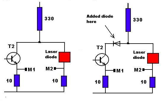

Looking at the modulator circuit in the previous post see how the power supply current can follow two paths. One way is through the laser diode to ground. The other way is through the modulation transistor T2 to ground. I thought this was perfectly safe but noticed sometimes when making adjustments the laser diode would glow fairly bright just for an instant. It was getting extra current from somewhere. I decided transistor T2 might be passing current through the laser when it was only supposed to be diverting current away from the laser. I put a high speed low voltage drop shottky diode in the collector lead of the transistor. Now the transistor could definitely only act as a current divertor. The diode blocks any current that may try to add to the laser current. It works fine. No strange changes to laser light at all.
Laser diodes only need a very small overcurrent and it's good night laser. The diode seems to work fine and has no effect on modulation speed. The drawing shows the added diode. I might put a diode into the laser side as well so both sides would be symetrical. Have not yet.

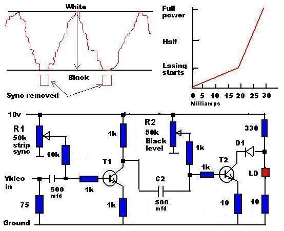

The laser modulator is coming along.
Attached diagram shows the setup. This is different from the previous circuit. I use this one with the TV video out and the other one with the pattern generator. R1 strips the sync pulses from the video. R2 sets the black level just at the point lasing starts and R3 sets the gain so the laser is fully modulated. I have no plans for gamma correction.
Works ok. Still using audio transistors 2N2102. . If I adjust R1 to show a little bit of sync pulses scope shows nice square edges. Surprising they work at all at video frequencies. Having low value resistors helps a lot. Connecting this circuit to TV video out and connecting laser etc as previous drawing shows laser modulation is very active. Output transistor has far too high on resistance so will have to change that. Need one with very low on resistance otherwise there is a strong temptation to crank up the power supply voltage to get more light and thats risking laser burnout.
The sync pulse stripper works well. Adjust R1 to reduce the size of sync pulses or remove them completely. That part is stable. Set gain works good. Gives more or less feedback to adjust output transistor gain.
Set black level works by setting the laser to just lasing with no modulation. The set point does move up and down a little depending on video content. It can be stabilised more solidly but I only need to make the modulator usable and stable. I will give it another week or so to settle things down then get on to the frame scanner.

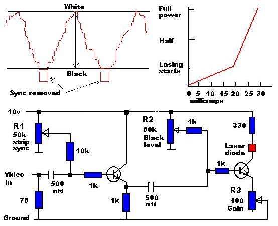

Attached circuit shows the modulator which has been modified for negative sync video and shunt operation. I like this circuit better than the previous series circuit because by turning black level control right down turns off transistor T2 and allows the laser diode current to be set exactly to 30 ma. The pevious circuit could do this but, because T2 in that circuit could not go to zero ohms when fully on, it lowered the laser power. That meant I had to increase the power supply a little to get back the original brightness and that seemed very risky.
With this shunt circuit I can turn T2 off with R2. Set the laser current to 30 ma by adjusting the 10v supply a fraction either way. Increase R2 so the laser is just visiblly lasing. This means transistor T2 is shunting current away from the Laser. Apply modulation. Black modulation has no affect so the laser is not visible (black). White modulation turns T2 off so the laser runs at full power which is the 30 ma as originally set up. Removed the gain control at the moment. With this circuit there is just enough gain to swing the laser from black to white. The 10 ohm resistors are for scope monitoring. Diode D1 is as descibed in previous post to stop any possibility of transistor current getting into the laser diode.
This circuit is not very critical in operation. Sync strip and set black work ok. As with some DIY projects it could be improved by more modern electronics. Perhaps a dedicated sync stripper IC to replace T1. Maybe a Burr Brown or other hi speed op amp to replace T2. There are some parts out there I might get. But because this is a small scale test I am not ready to go there yet. Just get the basics working and take it from there. T1 at present is a BF198 rf transistor and it works ok. T2 is still a 2N2102 audio transistor. I will still get some video transistors but the parts people are out of stock right now.

While waiting for a 635 nm 5mw laser to arrive as mentioned previous post, I have been doing some further experiments.
Some time ago we discussed using a 50 facet polygon and found that one 50 facet mirror with 6 small lasers could draw 300 tv lines in a 50th of a second with only 3000 RPM motor speed. This interested me and enquired from polygon manufacturers as to cost of a 50 facet mirror. Several replies came back with a price for just the mirror, no motor or controller of between U.S. $700 -1500. This price was too much for a small scale experiment so I left it.
However the idea has possibilities and I tried several experiments. I have an 8 facet polygon and motor all ready to use. 8 facets draw 8 lines per revolution. You cannot see modulation without a frame scanner so I blocked off 7 of the facets by folding paper over them and securing with cellotape. Now I got one line per revolution and could see the modulation from the pattern generator. The scan angle was 90 degrees 720/8=90 and showed 6 lines in a 90 degree arc. Taking this a little bit further, I blocked off most of the 8th mirror face with more paper until there was only about 1/4 inch of mirror. At 1500 RPM there were 2 scan lines and at 3000 RPM there was just one scan line. Modulation good and brightness good. Scan angle about 15 degrees.
At 3000 rpm there were 50 lines being repeated. I was looking at one of these lines. What the brightness would be like if I was looking at one line out of 300 I dont know. Less I expect. There is a way to find out. 6 motor revolutions draws 300 lines. (6*50) Turn the laser beam off for 5 motor revolutions. I tried to simulate this by blocking the laser beam very quickly with a piece of paper. The motor is revolving at 50 revs per second. It is very unlikely I can move a piece of paper into and out of the beam at 50 times per second it will probably be much slower but the line stayed quite bright even with moderately slow beam blocking and at slow beam interuption the line started to flicker so I was definitely cutting down the refresh rate. Might try something more precise with a 555 timer to turn the laser beam off for 5 motor revolutions and see if the line stays bright.
