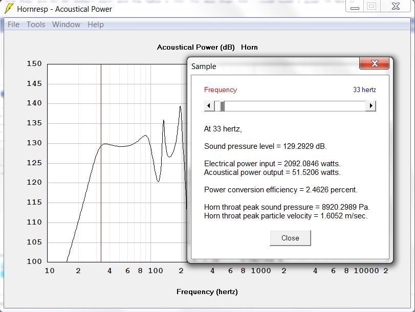

I like this design a lot, although if I were building for something in this size bracket I'd go with 4 SWS12D4 drivers as where I live they are 60-80 dollars each and the faital is 350. For less than 500 I could build a quad TH like the one below. It is not as power efficient at 1 watt but the 4 drivers together take 2000 watts rms. Attached image shows maximum output (2 pi) at 65 V into 4 parallel nominal 8 ohm drivers). 2.5 is the compression ratio.
The nice part is it's only 273 L and thus can be built in a 13 cu. ft. package (I use a 1.3:1 ratio to guestimate difference in built size versus internal modeled size)

This sim is a dual loaded TH, loaded with Faital Pro 12 1030hps wired in series Pic attached shows input screen, 4v (1w into 16ohms sensitivity) schem diagram, and max spl in a stack of 8

Hmm, coming a little late to this 'party' and seem to be missing something obvious as I get 145 dB/400 W ea./[8] stack from only ~196 L/dual driver/3:1 CR. The trade-off is it's not as flat or quite as extended in the extreme Hf [where it doesn't matter], though we all know it will be somewhat flatter in reality. Probably easier to fold too.
Also wondering why the series wiring since it's a ~2 ohm load, which will theoretically suffer more thermal power compression even at modest power than drivers in parallel, then series and/or parallel in stacks.
