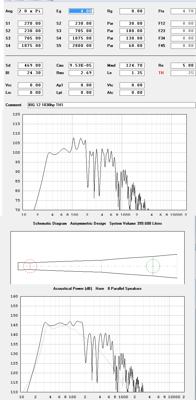

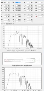

This sim is a dual loaded TH, loaded with Faital Pro 12 1030hps wired in series Pic attached shows input screen, 4v (1w into 16ohms sensitivity) schem diagram, and max spl in a stack of 8

My initial estimates for dimensions was 30wx48dx21.5h external,
I realize CR is pretty high at about 4:1....
Hmm, coming a little late to this 'party' and seem to be missing something obvious as I get 145 dB/400 W ea./[8] stack from only ~196 L/dual driver/3:1 CR. The trade-off is it's not as flat or quite as extended in the extreme Hf [where it doesn't matter], though we all know it will be somewhat flatter in reality. Probably easier to fold too.
Also wondering why the series wiring since it's a ~2 ohm load, which will theoretically suffer more thermal power compression even at modest power than drivers in parallel, then series and/or parallel in stacks.

Gm thanks for taking interest, refer to post 6 for some more info
