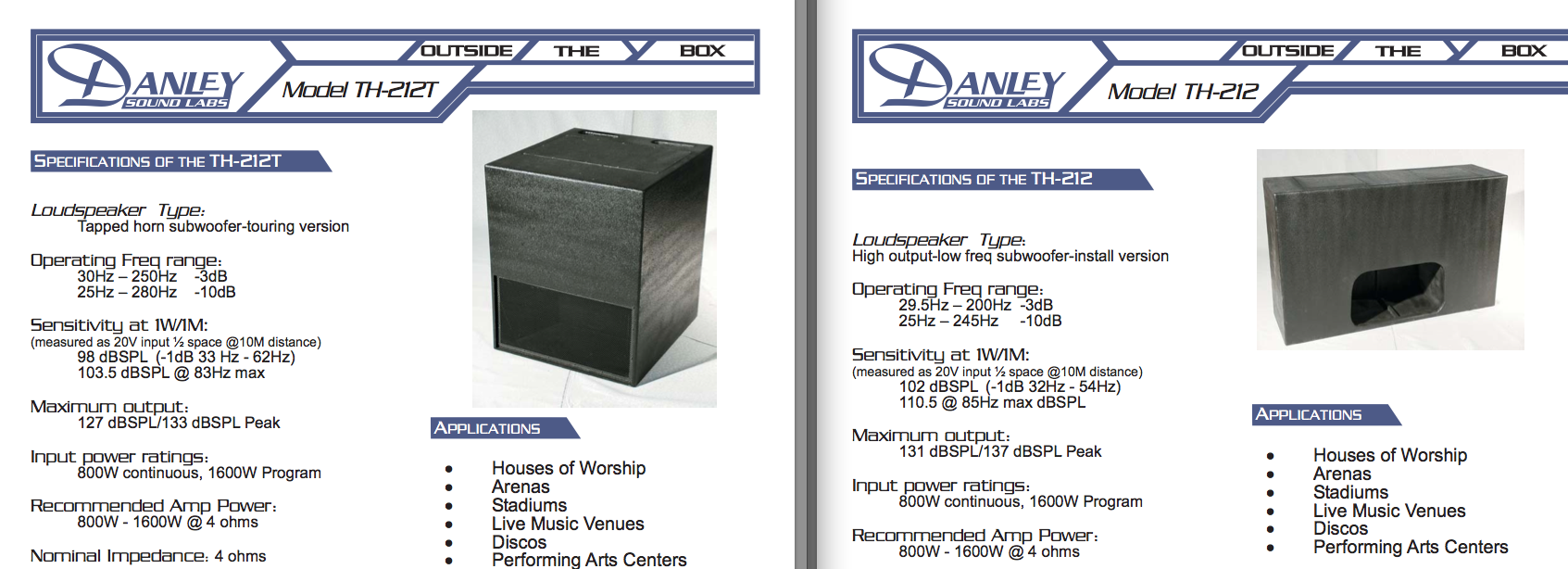

Which DSL 2x12" were you trying to figure out?
I guess it was the TH212 Art. As I have always liked the look of the TH412 but figured the 212 was just half of that. Now Sine143 is building this one so I am curious again about building a dual or quad 12 design also. I am not the biggest fan of the 45 depth on the 412 but if your going to stack multiples that makes sense.
For me it has never been a need but just a want. I keep building TH's and always want more. Just need to stop wasting money and build an extremely efficient design with huge spl. Then I can move on to tops.
I guess it was the TH212 Art. As I have always liked the look of the TH412 but figured the 212 was just half of that. I am not the biggest fan of the 45 depth on the 412 but if your going to stack multiples that makes sense.
I'm not a fan of a 45" depth either, but the TH-212 comes in three versions, one was 18" deep x 60 x 60, the TH-212T was 30 inches deep x 38 x 28, and another TH-212 is 36" deep x 15 x 36.
None of them are like the TH-412 in layout.
