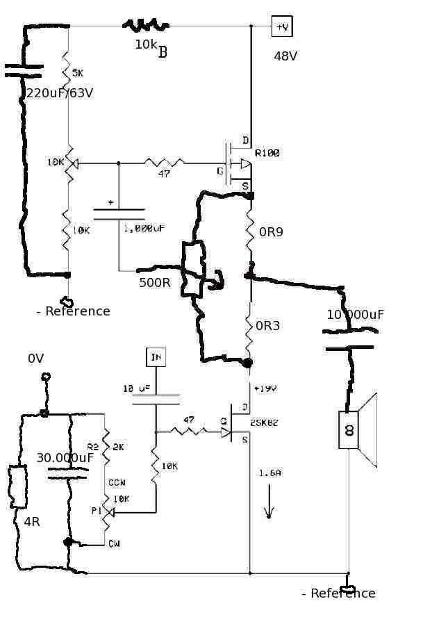

I made some small experiments.....
I tried to get rid of my battery biasing by implementing a 4 Ohm thick film resistor in the negative rail, with the goal to adjust the current through Mikes Semisouth solution to 1,5A. I got by the resisor about 6V available biasing voltage. I took parallel to the resistor the 10k pot and two 15000uF caps Panasonic.
Because I was a bit afraid that it could take a too long time to fill the 30ooouF and to have meanwhile a Poof of the SIT I implemented first time the additional 10k and 220uF in the Semisouth positive biasing branch, I added to my last MU-follower idea I posted some time ago here.
And it works, the current comes a bit later to the full value than the biasing voltage!
Is it correct to see these 4 Ohm resistor in the negative rail as a kind of source resistor but bridged with a cap?
And is it correct that when you need for a 1 Ohm Resistor about 50.000-100000uF I need for 4 ohm only between 15.000 and 30.000uF?

I had more difficulties to dial in to 19V and 1,6A with the self biasing solution D than with the Semisouth solution B.
Because I used my First Watt PSU with two 2,2 Ohm Vishay thickfilm resistor in series I got
the voltage down to about 41V. So 19V at the output node is near to the half of the supply voltage.

A simple schematic would help to see what you did.
So you have a proper positive and negative rail on your ps? Or is the negative the bias supply rail ? Is it rated for the power you want?
Is the gate referenced to ground or to the negative rail?

I hope this "handmade" picture helps...🙂

I do not see how this works honestly.
Maybe I am misinterpreting something but the way I understand it your gate has to biased NEGATIVE to your source whatever that voltage is and not negative to ground. So if your source is sitting on eg -35v negative rail then the gate should be MORE NEGATIVE than -35 maybe like -38V.
The way you are deriving your bias at the gate is from a resistor network from ground to neg rail which is going to give you a value between the neg rail and ground so that will be more positive than your source.
If you are going to use the neg rail either it should be for biasing the gate with the source sitting at 0V otherwise connect the gate to the neg rail and use source degeneration to lift the source above the gate.

Look at it again. - reference isn't at ground, it's at 4Rx1.6A, or 6.4V above ground.

thanks Roscoe!🙂 I am smelling the smoke of 2,6A at the moment!
Protos it works...😀... at the moment in my amp.....maybe as always..... my ugly handmade pictures irritate you.😀
