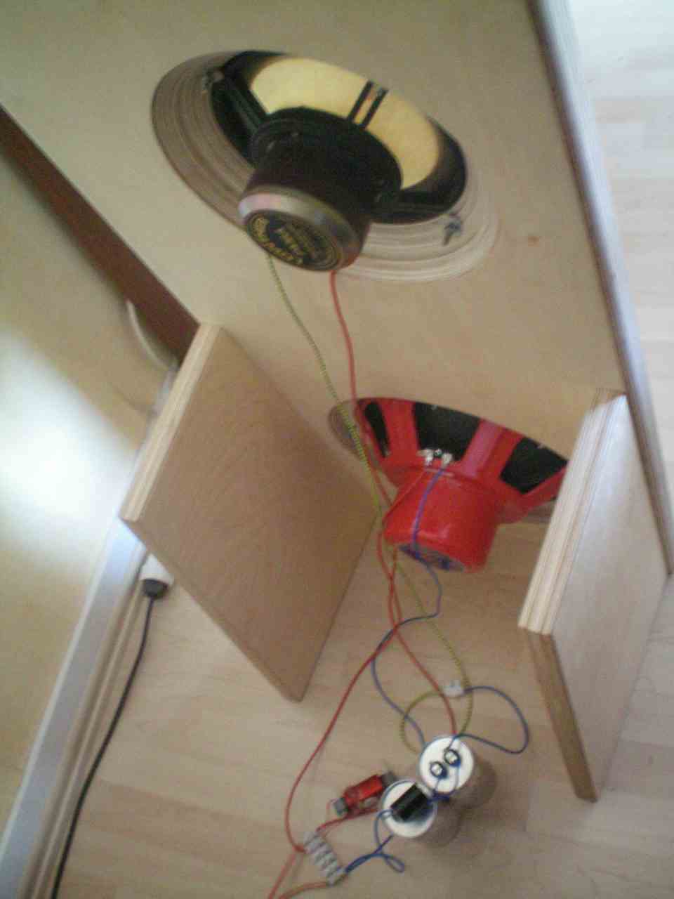

....... just thinking .... it seems we don't have enough pictures of speakers , in this thread .....
I thought it to be a good idea because people who want to build this lovely amp get a impression for fitting speakers....
