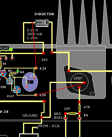

Detail for applying the sense terminals for Marco & you. Try to keep the loop area (sense wires enclosed area) minimal. Tightly twisting their most length is welcome if feasible. Their gauge can be relatively thin. Choose that next to C1 K117GR for about 3.15mA IDSS.
O.K. Salas I understood, thank you very much!😀

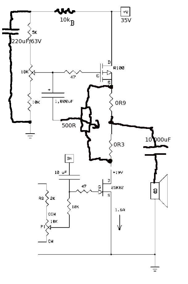

Some new information are gathering in this fine tread - that get me thinking and wondering!! I have started my build and was soon to mount the resistors and the SK82. Now I think I was somewhat lucky - since I did buy a trafo from Antek(400watt) with 2x35 volt ac( ca2x39 volt dc) - but I got it delivered with 2x35 + 1x18 + 1x12!
So I can still use it with a choke and the 1x18(if the ampere is enough). I had my amp predesigned for selfbiasing - so that is ok! That was one of the point Ilimzn was most sceptical about? But can we use self-biasing with the Hammond-choke?
I think I will build my amp with my resistor-chain and the selfbias - with 39 volt DC - and power it up 20april(when home from sea), just to listen to the magic that Generg and everyone resistor-fans was talking about.
But I`m gonna buy a couple 2SK82 that will arrive 20april, as backup if my other devices takes to flight!! They are not that very expensive. And I think my resistor-chain is fairly stable now= 7 pieces with 400watt total = 50 watt each. So it is the same wattage as my trafo(wonder if Nelson`s SIT1 has 800watt resistor AND 800watt trafo???)
But if the high-voltage and res-chain fails - and I get me a choke - is the Anteks 18 volt AC with 2 ampere current enough to run the Hammond? Or maybe I can use zenerdiodes to lower the voltage on the 39 volt DC in 2 step(2 - 9,1 volt gives me an output =20,8 volt). Or is this solution with zeners too noisy? And is anybody running the 2SK82 with Hammond-choke AND the SelfBiasing.
Much to ponder and rethink, and do any of you gentleman have a hint? Michael, Generg, Juanitox (who is already choke-influenced)?

olav, first try your Sit with Res load and 1 ohm source resistor you should have 13/15V drain and 2,3 / 2,6amp ( with 40/45V supply) .
second try it with the source bypass cap ( 100000uf with 10uf MKp)
then negative bias with the 10uf Mkp at the input this time.
and last the hammond choke , you have to lowered your PS ( with a RCRC ? you have a lot of hig power resistors on hands) to 18/24V then you could try negative bias or fixed bias ( i use a 50W wirewound reosthat for that , still bypassed with 100000uf)
after all that hours of works alone , you will divorce and go fishing with friends 😀
