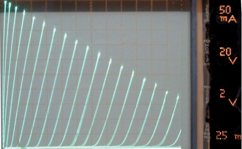

Attached is a curve tracer plot of Id versus Vds at a number of Vgs settings for the Sony 2SK60. This is a composite of two measurements made on a Tek 576 tracer (because it normally only does up to 11 Vgs steps total), rank 6 device. This is a high voltage, low current plot, the scale is shown on the readout on the right, 50mA/div vertical (so the full height of the screen is 500mA), 20V/div horizontal (so the full width, being 12 divisions, equals 240V). Each Vgs step is -2V starting a 0V for the leftmost line. Note that the breakdown voltage is signifficantly over the 160V spec since the device operates without breakdown at 240V (don't bet on this for your particular part, 160V is guaranteed).
Note how the first few lines for low Vds are bunched together, this tendency continues to higher currents. However, if you look more to the right... I think no comment is needed.

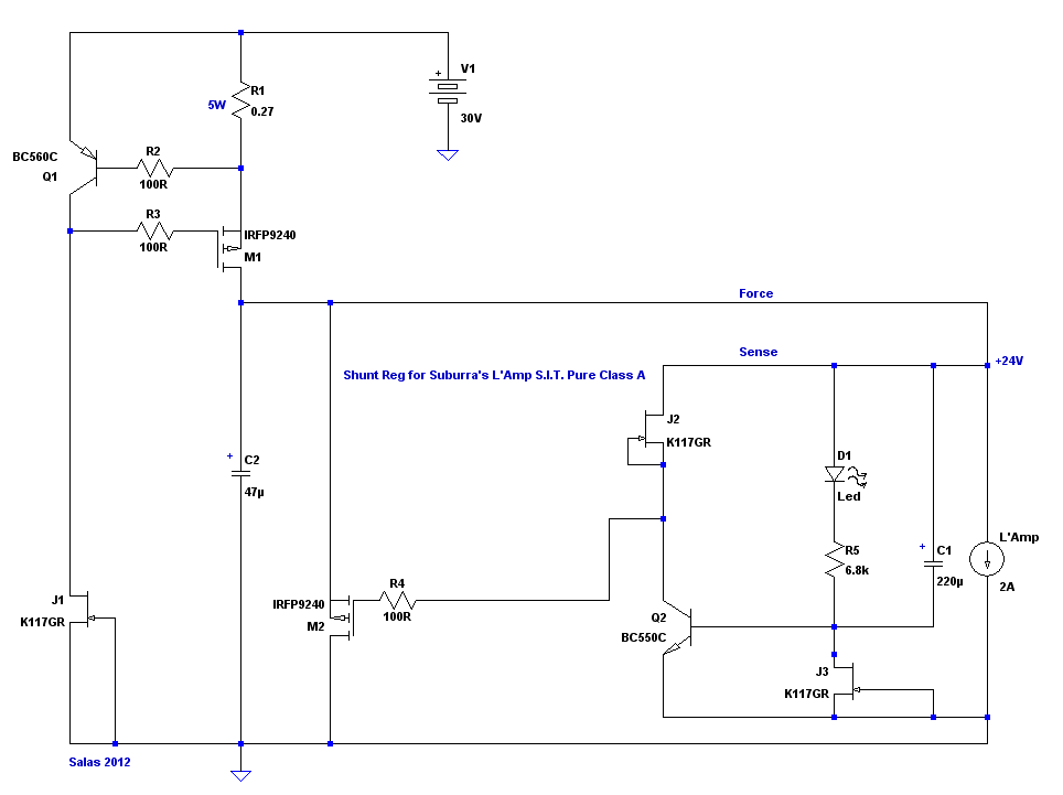

That suggested CCS that generg made was cascoded accounting for the high capacitance at low VDS Mosfet thing (especially when TO-247). We did not opt skipping the extra dissipation of adding another Mosfet to it exactly to control the capacitance bug. Suburra (i.e. Marco from Italy) plans to test out a full regulator and inductive drain load approach, so to achieve fixed supply, and improve on the PSRR and gate track drain supply thing right at the power source. Maybe a win win, he will see.
- L'Amp: A simple SIT Amp
