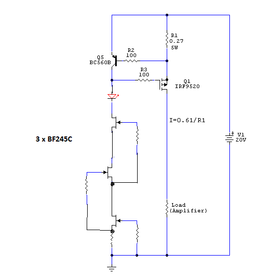

and while we are having fun - with BF , you can stack several of them in Papa Borbely's high pinch cascode manner , with LED on top , and have multiple pleasure

would you believe me , if I say that that's really what Papa sent me , as reply to my own greed ?
He's a wicked man.
Here is a plain one, though not that bad, in case you will need it. (Q3's drain is pointing ''north'' in the schematic, you may use one red or green LED on top of Q3 in series if you wanna know the thing is ''on'' at a glance).

He had full cascode for the small and the big semis, but he wants to listen to something else less parts also. Only to insulate the TO-220 mounting screw too is a reminder if the sink touches something that it shouldn't. The other one had TO-247s which aren't a pain to insulate.
He had a BF245C there topping for a fast ''tail'' CCS in the previous test. The Toshiba will push the PSRR hard in the lows with its large gm and let it loose progressively due to high Ciss, maybe its the ''different'' sound he seeks or not. He can try 2SK170 BL with that resistor, or a low IDSS BF245A and decide, provided he likes the plain CCS in general of course.
