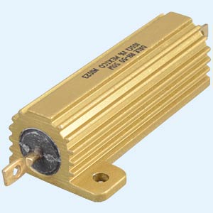

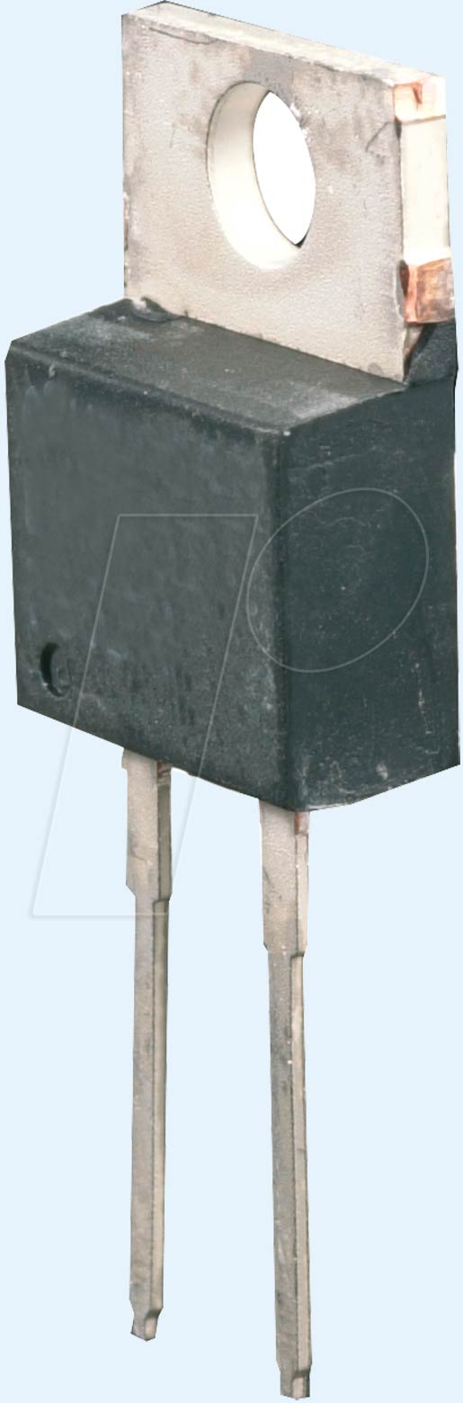

I used three 3,3 and some 1,5 and 1 Ohm Vishay metal combined, I got them here
50 Watt, axial bei reichelt elektronik
I suppose this non inductive Vishay should be better......?
RTO 50F 10 - Dickschichtwiderstand 50W TO220 10 Ohm, 5 - Dickschichtwiderstände TO220 bei reichelt elektronik

I wrote IF its not due to loop hum then its about PSU breakthrough. Don't be surprised if there might be charging cycle products in heavy PSUs also. Very low impedance goal in such PSU is another thing. SE power stage has no cancellation like PUSH-PULL, plus some gain here. Remains to find out if its due to loop sensitivity for transformer field. I will see about another CCS for you to try soon enough then.
Yes, exactly, Mike and tea-bag! I have three 3,3 and two 1 and one 0,5 to get about 2,5A and 13,9V with 47V . Later in the evening I will change the position of the "resistor loop" I spreaded them generously over the second half of my heatsink. I am quite sure it is the loop getting hum.
