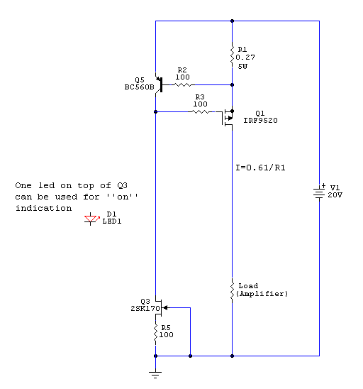

I am still not happy with so much wattage in resistors......
so I am open to try another CCS solution, really!
Here is a plain one, though not that bad, in case you will need it. (Q3's drain is pointing ''north'' in the schematic, you may use one red or green LED on top of Q3 in series if you wanna know the thing is ''on'' at a glance).
Thanks Salas! This one is similar to the original Zen. What is the purpose of 2sk170 in this CCS?
