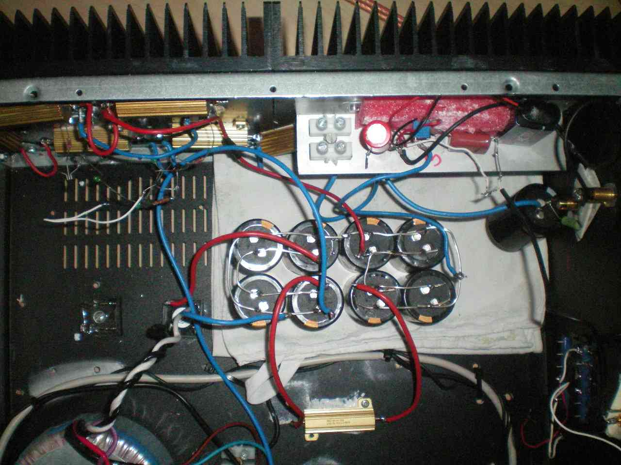

I enclosed a bit a reluctant a picture, please do not forget this case has seen during the last two years
F5 mono PSU, dual PSU, F4, BA-1, BA-2, BA-1 with Semisouth, F1J, F2J,F3, Aleph3, Aleph30, Aleph5,BJ2, M2clone (crippled F4 with different xformers), xformers with 2x18V 300W, 2x30V 400W,2x18V 500W.........SIT
so you understand it is a bit dirty and worn, but it served me well.....🙂 and now you understand better my signature....😎

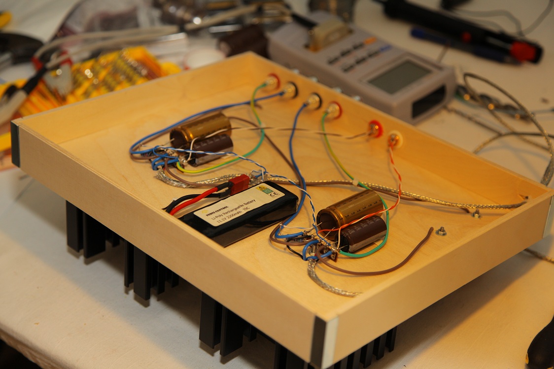

Hi Chris, would be happy if my prototypes would look like this....🙂

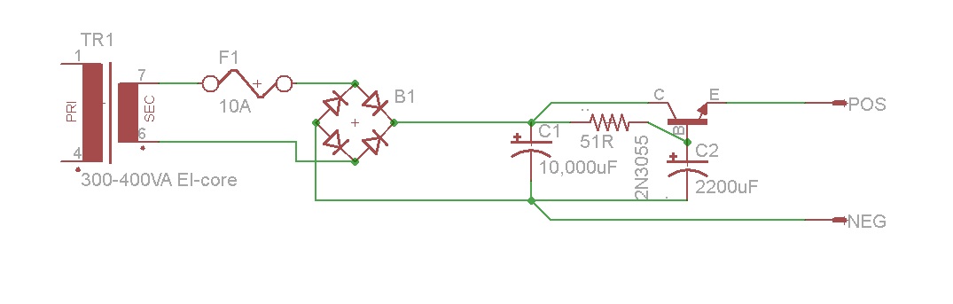

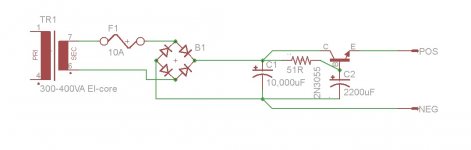

Hello,
My PSU is super simple using just a single 2n3055 BJT. i made a simple schematic too
at the moment i'm only using one single PSU as in the schematic (except i use discrete diodes instead of the bridge)
I might make a schematic for the amp too if anyone really want that 😛
I'm using a couple von schweikert VR2 at the moment, have no trouble with insufficient volume levels, and that is at 32V supply
When i get more serious with my heat sink i probably will make a 45-50V PSU with another gyrator/cap-multiplier, using one or two "transformers+rectifiers+first-cap"
And Thank Michael for making the Great article about this project, super-fun read indeed! 😎
